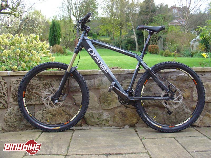

    Howdy, i've got Hayes HFX9 HD discs running 8" rotors on my Orange SubZero
    The front runs perfectly, but i've got a really annoying and loud vibration coming from the rear. I've looked at the alignment of the rotor and caliper and it appears to be about .5mm out. Is this enough to vibrate?
    Apart from that, all i can think it could be is a sticky piston as i don't reckon contaminated pads would do this.
    Any one got any ideas and how to fix it?

    I've swapped the pads out for some Gold EBC ones and realligned the brakes and still i'm getting crazy vibrating problems. Anyone help?

    I'm taking it for granted that you know how to align the caliper on the rotor...
    .5 of a mm isnt a lot..so that should be ok. Is the rotor true? Not warped?
    Are you sure that the vibes are coming from the brake?
    Can you hear any sounds like pad/rotor rubbing when you spin the rear wheel?
    Have you checked all your bolts for tightness and torqued them with a torque wrench?
    It *may* be a sticky piston, can you have a look?
    R.

    Pretty sure the rotor isn't warped as when the wheel rotates there is no rubbing what so ever between rotor and pads. The pistons appear to be moving freely and i've tried diffirent methods of aligning the rotors with the caliper. I've done it by sight, i've loosened the bolts and applied pressure to the brake lever to centre the rotor with the pads and then tightened the bolts securely. Each time, i still get the vibrations.
    Only thing i've not done is use a torque wrench, but would this really cause any vibrating problems?
    thanks for the help on this.

    When you apply the brakes, does the lever feel 'spongy'? If so, it may be you have air in the line and need to bleed the system.
    Also, when applying the brakes, do you see the pads move approximately an equal distance to the rotor, and do they release the rotor and return normally again?
    If it isn't any of these, then you have me stumped.
    Are you sure that its the brake which is causing the vibrations, and not something else in the rear end?
    R.

    Shoogly - As you've probably come to realize....disc brakes are great, but sounds and vibrations aren't uncommon and can be VERY difficult to track down. Since you've tried most of the standard cures, have you also trued your wheels and verified that the spoke tension is fairly even? The tolerances on these things is very tight, and anything out of alignment could negatively effect them. Good luck. - Dave

    The bike's only a couple of months old so is probably due it's first service (i've ridden it a lot since i got it). It's definitely the brakes causing the vibration as it's only when i use them that it happens. I'll try trueing the wheel and see if that helps.
