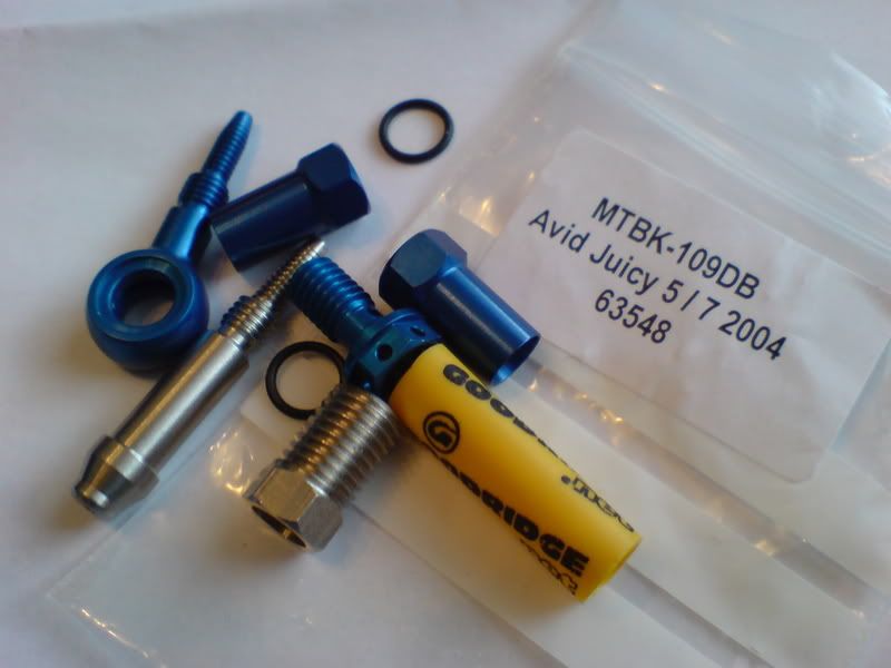

    Did You get this set:
    Do I have the correct lever-end connector? Seems to be coarse pitch thread.
    The reason I'm asking is because I previously ordered the same 109 kit from CRC and got diffferent lever end connector (fine pitch lever end) as seen here:

    One thing to look out for is that there are pre 2005 Juicy 109 kits and 2005+ Juicy 109 kits.
    From looking at the threads on the lever body fitting, I'd say the pre 2005 kits are the right ones for The Ones. 2005+ Juicy's have a finer thread on that fitting.
    Right?
    Edit: It seems that there may be some mis-labeling in Goodridge land. I have a kit that says 'MTB109-1FCB-BK” on it and “Avid Juicy 5/Juicy 7 (2005)”….the kit for 2005 Juicy's with the fine pitch thread are supposed to be MTB110s.

    I've transferred my Goodridge lines from Hopes to the Formla RXs using the pictured 109 kit from CRC. Things have gone pretty well, until I slid the longer tapered end down into the lever reservoir. There is NO o-ring that's meant to go on there as I can tell, and it's weirding me out. It fits snug, and everything's tightened up nicely.
    I'll be testing it out tonight, but just wanted to hear back about whether this is meant to be attached to the lever with no o-ring in sight.
    Thanks,
    Mike
    18
    Got this from the Goodridge guy:
    Mike,
    That fitting has a flare seat that should match up with the seat in the lever, so no o-ring is required.

    I have e-mailed Goodridge a few times over the last few weeks as I find differing info on the Internet. From what most people say, my "The Ones" require the 109 kit, but Goodridge has told me 101 twice, and 109 once. This thread is pretty old, and I heard that Formula possible changed the thread pitch at some point which might be confusing things. This is exacerbated by the fact that I bought The Ones as old NIB stock (so I am not sure what year I even have).
    I worry I am going to buy the wrong kit, as my luck is horrendous with these things and a mistake is pretty pricey (and time consuming). I should probably just pull my lines and see if I have fine or coarse threads ... would probably get me pretty close to a definitive answer..
    18
    Here's some more info from Karl ( karl.kramberger@goodridge.net ) :
    Thanks Karl for taking time to answer these questions. One last one! The threaded collar that holds that flared fitting into the lever is pretty long, and there are several threads exposed. The other side is even a bit longer. Any issues?
    Mike
    Mike,
    Shouldn't be a problem.
    Karl
    I think I'll answer my own recent thread and put together a Formula RX and Goodridge lines list of facts Formula RX and Goodridge lines Thanks for everyone's help so far.
