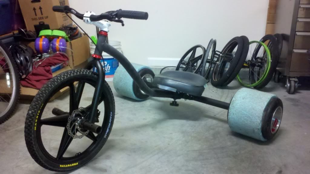

    ive built a Trike in the mean time and need a little bit of help with Disc brakes
    this thing has 160mm rotor on it and i want to upgrade to a 203mm but compared to the two disc and the Haro, measuring from one hole to the opposite hole is 44mm and my trike disc is 48mm.....
    can anyone shine some light on this and help me find a 203mm that has a 48mm bolt pattern(i guess)?
    thanks Brian

    i built this trike from BMX parts and a variety of parts, the rotor is designed for a motorized bike (26") its called a THREAD ON DISC BRAKE CONVERSION KIT
    on this site Custom Motored Bicycles - DISC BRAKES,BAND BRAKES, DRUM HUB BRAKES,DUAL BRAKE LEVER,BRAKE PARTS
    scroll down a little bit and you will see it.
    i used this disc and hub adapter but its not enough brake power to stop my trike on a downhill at about 45mph so i want to get a 203mm rotor which is what alot of other guys are using except i got some off the wall rotor i guess cause i cant find a 203mm rotor with a 48mm bolt pattern

    This entire set up looks sketchy as hell. Plastic wheel + 45mph + single front disc brake + thread on disc adapter = not ending well.
    And yes, it appears to be a non-standard rotor.

    Yep. I would get a disc brake fork and ditch the fork and disc brake adapter ASAP. Then you face death only from the inherent nature of what you're doing, rather than the threat of your fork folding.

    noted, now to find a 20inch disc brake fork

    IS is a 44mm BCD.
