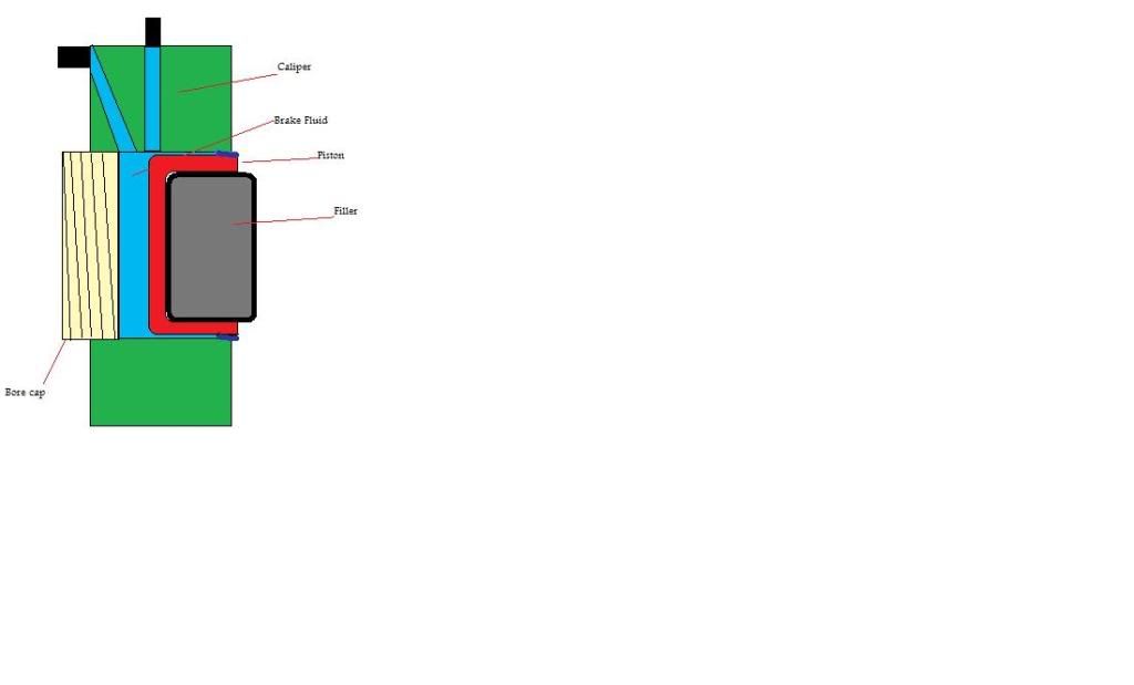

    I don't think that chip will make the piston weaker. Think of the piston as a cup with its "bottom" on the inside of the caliper. The plastic part that chipped sits inside the cup.

    actually the "cup" is upside down the bottom is what chipped, with the demand for light weight componets I doubt there is any extra thickness on that piston.
    why take a chance, if it goes it will spew fluid all over your pads and rotor and make a huge mess. you can get a new caliper for $60 online and they come with new pads

    Here you go, This should make some sense. For simplistic sake, I only drew one side of the caliper.
