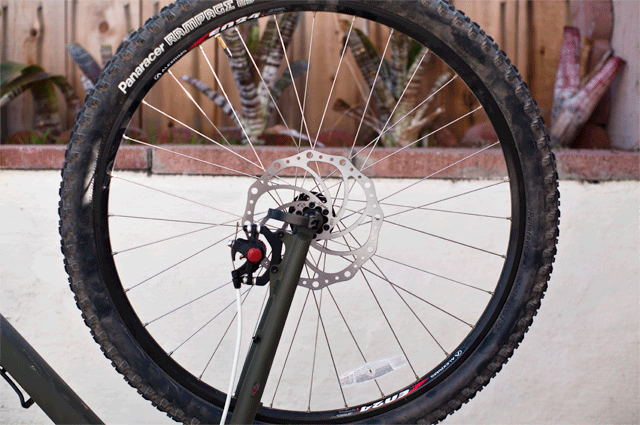

    So I'm using BB5's with 160mm rotors on my trail 29er, which appears to be what my Diamondback Overdrive frame would have come with stock, had I bought it as a whole bike. I know I'm not talking about high-end gear here, but I feel like the the V-brakes on my 26" commuter just do a way better job. I know disc brakes are notorious for being noisier than V-brakes, but mine seem to make awful awful noises on steep descents once they get hot, and the front doesn't seem to grab hard enough (yes they are adjusted properly. They seem to work fine on milder descents or street riding, where they don't get as hot).
    Should I think about switching up to a bigger front rotor? Will I need to go to a BB7 to utilize a bigger rotor? (I'd like to avoid the expense of going hydraulic, plus I like the way mechanical discs have similar lever-feel to V-brakes).
    Pic for reference:
    (I'm 5'10", 240lbs and dropping)

    I went ahead and stepped it up a wee bit:
    Alligator 203mm w/ appropriate Avid caliper adapter
    I lock up the rear pretty easily still so I'll hold off on upgrading that end for now. Pads and rotor haven't mated yet after just one quick run down the hill so I'll hold off on a proper ride report until I've put a few miles on it.
