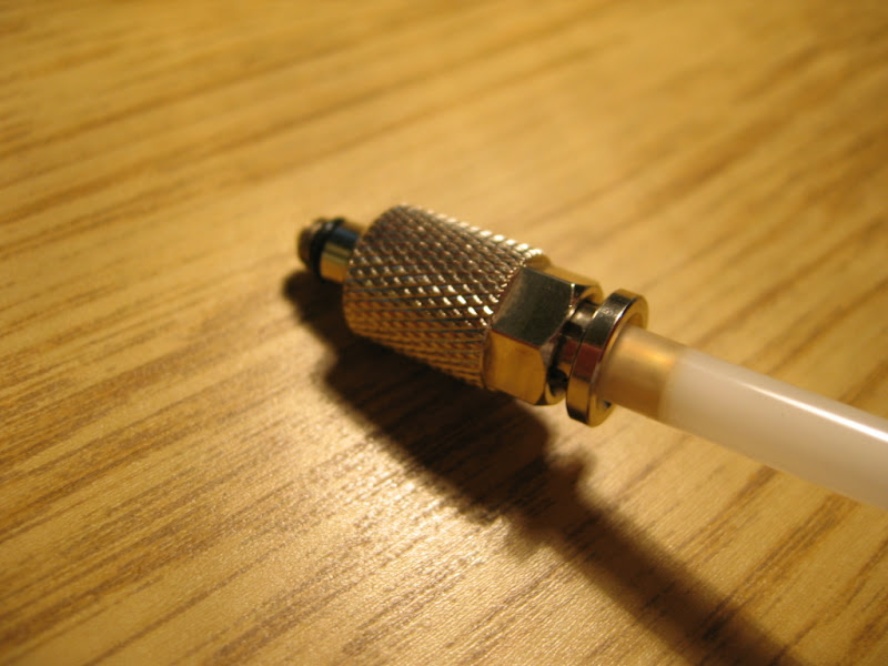

    Strange problem I'm having. I recently picked up a new Avid Professional Bleed Kit. I used it once to bleed my front and rear brakes, and when I was done, rinsed all the bleed kit parts with water and dish soap. Then the hoses completely clouded up. Not just cloudy, but completely opaque. I thought at first that it was just condensation in the hoses, but left it to sit for a week with no change. Tried flushing with rubbing alcohol - no change. Blew compressed air through the hoses - no change.
    Has anyone else had this problem? Any idea of the cause? It basically makes the kit unusable since I can't really tell if there are any bubbles left in the line or even where the fluid level is. I called SRAM and talked to tech support. The guy had never heard of this problem (although I am not confident he completely understood what I was trying to describe) and had no solution or recommendation other than "take it into your LBS."
    Here are a few pics so you can see what I am talking about.
    Here I have removed one end of the hose from the hose barb - under which the hose is still clear.
    Here I have stuck a small screwdriver in to show that is it is not just hazy, but totally opaque.
    This kit was not cheap and as I mentioned, this happened after the first time I used it. I was thinking maybe the hose section is replaceable, but the opposite end of the hose (the end that screws into the bleed port) is not removeable from the fitting.
    Anyone have a similiar experience?

    Nope. Buy some vinyl aquarium hose. Its should take to the polyglycol with no reaction.
    Mar 2011
    159
    Quote Originally Posted by bing! View Post
    Thanks, but as far as I can tell, there is no way to remove the hose from the bleed port fitting end...?
    3,161
    Those look like screw-on compression fittings. I see a flat spot where a wrench will fit. Should screw out.
    I dont own the pro-set, but just by looking at it, it looks like it will.
    Either that or it might be a press-in compression fitting. Try LIGHTLY prying with a flat end screw driver.
    If the fitting that you're talking about being replaceable is the knurled nut on the hose in this picture, I think it's just a press fit nut. That means that you should be able to cut the flared end off of the hose, slip off the fitting, and slip it onto a new tube that you get. Unless I'm missing something in the picture, the flared end will be created by pressing onto the other half of that fitting.
    It seems like your problem was caused by some reaction with the soap. There really isn't any reason to wash your bleed system, just wipe it all clean with a towel and put it away. We have had the old Avid bleed kits for years without even wiping them down, I would expect the pro level kit to behave the same.

    No, as I mentioned it's the end that fits into the bleed port fitting that isn't removeable. Here's a close-up of that end:
    I can turn the knurled section, which spins independently of the end fitted into the hose. This is to allow you to thread it into the bleed port without having to spin the hose at the same time.

    Quote Originally Posted by Burning Matches View Post
    I see a compression fitting. It'll open up, coz that hose aint molded in

    Bingo! The hose is back to clear. Letting it sit all day full of fluid did the trick.
    Lesson learned here - don't try cleaning these things!

    Seriously, it won't. There is no compression fitting. I don't know how else to show this. The knurled section and the hex section are one solid piece, the metal section that the hose goes into is another. They don't come apart. The two pieces spin relative to each other, but nothing is threaded.
    Old thread but I thought I would add my $0.02 worth. The hose can be removed, the flat closest to the hose must be pushed in while the hose is pulled out. It is a compression fit with a brass piece on the inside to seal and support the hose. As stated in an eariler post, the shape on the oppsite end is the result of the compression fit of the adaptors. The tubing is a PVC with a 6mm OD and a 4mm ID. A 1/4" x 11/64" is a close tight fit. Hope this helps someone in rebuilding their bleed kit...
