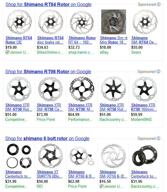

    Is it just me or is the thought a rotor is not worth much more than $20. Look at the $73.98 option...that's crazy
    Is it going to be that 6-bolt will become hard to get and considered "vintage" parts in the future ? (my guess no, there's too many bikes owned by non-aficionado types i.e. Walmart bike owners)
    Will centerlock become cheaper as design and tooling costs become amortized ? (my guess no. it seems like the industry's mantra is something like "stick-it-to-em) So much stuff is so over the top like XX1 don't you think?
    Enough ranting,
    Hank

    Quote Originally Posted by DirtyHank View Post
    Look at the prices on these rotors:
    Shimano Saint RT99 Ice Tech Center Lock Rotor | www.PricePoint.com
    Universal Cycles -- Hope Moto-V2 FR Rotors
    centerlock = Shimano
    Look at how many other brands there are that make rotors and hubs beside Shimano.
    Of all of these other brands that make hubs and rotors how many of them make centerlock.

    Quote Originally Posted by cobba View Post
    Next time I enter the Red Bull Rampage, I'll be sure to use them...

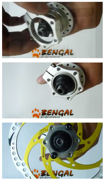

    If you do use an adapter, I would not use one of those silver units shown in post #5. I would say that the DT-Swiss type is not prone to the same type of failure (that has been my personal experience). If/when you work on them, the centerlock is nice, but not that big of a deal. 6-bolt is much more common and generally easier to source and less expensive.
    Reputation: DirtyHank's Avatar
    235
    Jeffj: I'll take a look at the DT one (assume it works with a Shimano hub ?) thanks
    I'll dig into adaptors just for the heck of it.
    Thanks,
    Hank
    Admittedly these do look extremely high tech.Hello Price Point…($129) where “Price is the Point” I think Jenson has you beat by $53.19
    Oh please...even my second wife treated me better than this ! It's a MTB not a BMW M3. ($132.00 a definite WTF is in order here)
    More stuff to deal with "Hey Jake I just dropped your circlip off the bluff...sorry man...meet you at the car?
