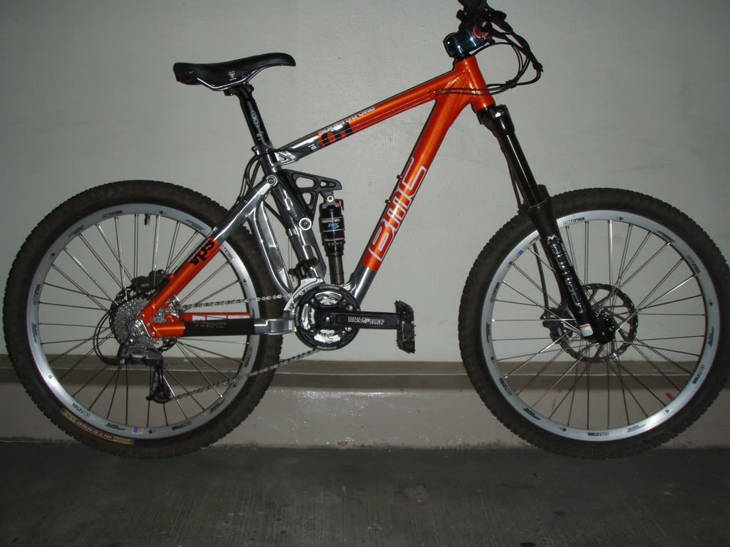

    Specs:
    Frame: 2008 BMC Superstroke 01 frame 150 or 130 (adjustable) rear travel
    Fork: Fox 36 Vanilla R 160mm travel
    Shock: Fox RP2
    Brakes: Avid Juicy 7 (185mm front 160mm rear)
    Crank: Truvativ Stylo 3.3 Team
    Bars: Sunline V1 Aluminum 1.5" Riser
    Stem: Race Face Atlas AM
    Grips: Oury lock on
    Shifters: Sram x0
    Front DR: Sram x7
    Rear DR: Sram x9
    Casette: Sram PG970
    Wheels: Sun Ringle STR8 Track AM
    Pedals: cheap/heavy kona platforms
    Seatpost: Race Face Evolve XC
    Saddle: WTB Rocket V with a nice tear
    I pieced most of it together via buying used parts off ebay and forum classifieds
    I have been piecing together this bike since March or April, primarily for a trip I am leaving for this Thursday. I'll be driving to Maine with a friend and riding at the following areas:
    Case Mountain (CT)
    Arcadia Wildlife Management Area (RI)
    Pawtuckaway (NH)
    Bear Brook (NH)
    Ft. Rock (NH)
    Bradbury Mountain (ME)
    Initially, I was going to ride more areas, such as Vietnam (MA) and Westwoods (CT) as well as some stuff near Mt. Washington on the way back down. Seeing as I don't want to get in over my head, I cut the riding back a little.
    What I DO need are some fatter tires. The Panaracer Fire XC 2.1s may not cut it. I was looking at Kenda Nevegal 2.35 DTCs but I can't seem to find anything locally. If I cant find those, or something just as good, locally I am going to order a set and have them shipped to a friends house in RI so I can pick them up on Saturday.
    When propedal is turned on, this bike climbs like a dream! I am still getting used to the handling with the wider bars and higher ride height. I still need to dial in the rebound on the fork and rear shock. The standover height isn't all that great. The frame is a 17" but it fits like an 18ish. The bars seem a bit high also, but I am probably going to move around some spacers before I decide to replace the stem or bars with something lower. Otherwise, I am very happy with the bike thusfar!

    congrats...it looks great!
    enjoy the trip!

    Congrats on the bike! I'm sure it would be a blast to ride. As for the tires, you might want to consider the Continental Mountain King Supersonics. One of my friends has it in 2.4 inch size and it is very light for that size. It's got very big volume (60 x 559) so you could run it with lower tire pressure.

    Looking sick Kenny!!!!!
    Glad to see she is finally up and running.
    Let us know how the riding goes on your trip!!!!!!!

    That's the 1st BMC Superstroke I've seen built up and looks amazing. Great job building!
    You are right about the Panny Fire XC tire. Need find some fatty. Hurry and find some Nev or Minion. Full report when you get some riding in.

    the frame looks really good ...
    yeah you definitely need some AM tires ...

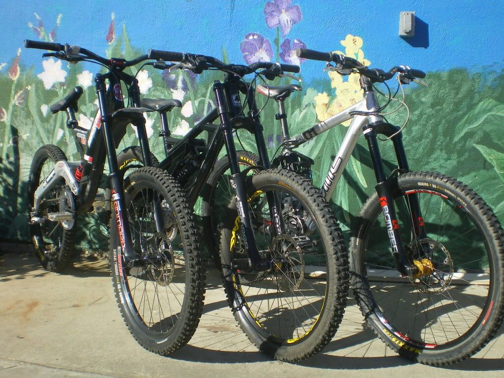

    Another Stroke built up...
    Reputation: nickgto's Avatar
    Dec 2005
    784
    Here is mine
    I built it 2 weeks ago. I'll post a pic to make this thread sorta like a superstroke pic thread.

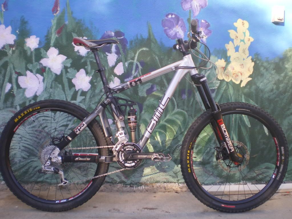

    as long as we're doing that...

    Nice bike, Joules!
    I was thinking about getting a Crank Bros Joplin seatpost until I saw the price tag! I was trying to stay on budget with the bike at the time.
    I am going to be replacing some components soon here to gear the bike towards more freeride than XC such as 8" rotors, beefier seatpost, different seat, and replacing the largest chainring with a bas guard.

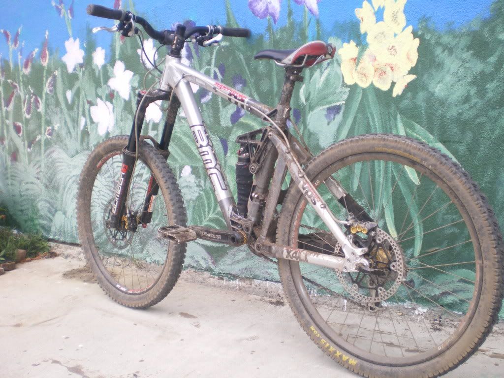

    Here's what my superstroke ended up looking like:

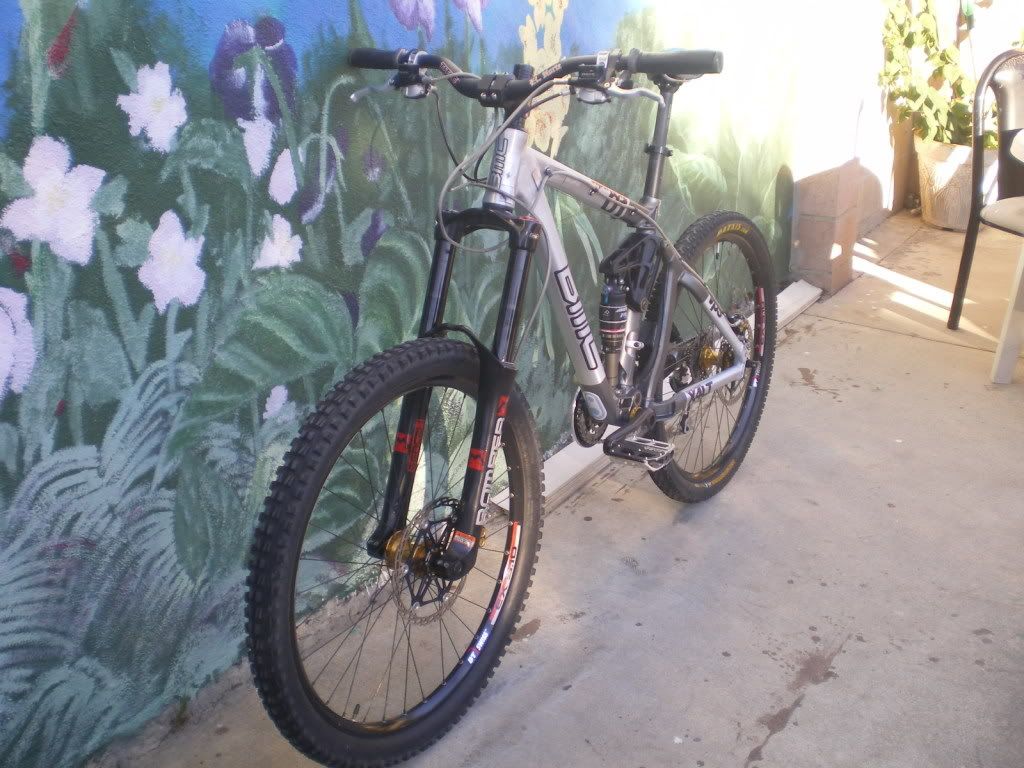

    Nice bikes ! I'll add another one-
    It's a 2007 model, 17 inch. I bought the wheels and fork at the same time as the frame. The 55s are burly and look great, but 160mm on the front makes the bike sit up real tall (I'm around 5'5), and I think I need a lighter spring, as the fork barely registers my weight. I'm going to get an 09 RS Revelation 110-140 air uturn, so I can dial the travel down and set the fork to my weight.
    The weight of these bikes when built can be a little scary after riding a light XC bike, but the superstroke pedals beautifully.

    I went with a Fox 36 Vanilla R when I built mine, because funds were tight. Eventually I am going to upgrade to a Fox 36 Talas or a Rock Shox Lyrik for the same reason you stated, with a 160mm fork the front end sits up pretty high.
    The height and weight took a little getting used to after my build. Once you get used to it though, this thing really carves on the downhills!

    Updated pics of my Superstroke :
    Swapped my brakes(Hope Mono 6) from my Quake to my BMC,
    DH:Mountain Cycle Shockwave 9.5 w/ 888R
    FR:Marin Quake w/ 888RC
    AM:BMC Superstroke 01 w/ 66RC2X

    Quote Originally Posted by Kenny301
    Posting pictures is easy.
    Go to www.flickr.com or www.photobucket.com or any of the dozen or so other free hosting sites.
    Dump your photos on there, come back here and click the "Insert Image" button in the reply field (looks like a mountain with a yellow sky and sun) and paste the hyperlink for one picture in the box that appears.
    Repeat for each shot.
    OK Cool, I will do that when I get home. Thanks man

    My 3 rigs.
    Not enough ride time to merit one more rig.

    So has anyone done freeride or downhill on their super stroke? I am changing a few things on mine to do some DH shuttle runs in a few weeks.
    Swapping out the 90mm 8deg Race Face AM stem for a 50-60mm 0deg Sunline V1
    185mm front and 160mm rear rotors are going to 203mm
    Largest chainring is now an e.13 super charger bash guard
    Long cage Sram x.9 rear der. is now a mid cage Sram x.7.
  71. #71

    I've ridden my Superstroke to trails that I've only considered riding previously on my Shockwave 9.5 and Marin Quake, both of which were burlier built, and I can say that it could hold it's own. Of course I have to be more judicious with the lines that I take cuz I can't plow thru the same lines that my Shockwave could at the same speed. The Fox RP3 being an air shock wass the biggest drawback as both my bigger bikes have coil sprung rear ends (Romic D and DHX 5). Even though my RP3 has the Air Volume Adjust feature which let's me adjust the shock's progresiveness, I still haven't tuned it the way I did my Romic on my 9.5 or the DHX5 on my Quake. There still was a big trade off between small bump compliance and big hit ability. I have bottomed out the shock when I rode it on those really aggresive trails, when I tuned it to match the small bump compliance of the other 2 rigs.
    I could say that my Superstroke was aggresively built as well with an '06 170mm 66RC2X fork, Hope Mono6 203mm floating rotors f&r, RF Evolve DH 32-22 crank, Titec El Norte Stem 60mm 0 deg, Titec El Norte 31.8 x 690mm handle bar, Titec Pyro Scoper seat post, SRAM X9 Mid Cage Drive Train, and DT5.1D's on DT Champion spokes and Hope Pro2 hubs, Maxxis Minion 2.5 DH casing front and Maxxis Advantage 2.4 rear.
    This is the rig that I normally use when I ride with my XC buddies for 18 to 25 miles and mine sits at 38lbs at the bathroom scale.
