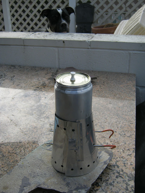

    You guys got me all fired up to make one of those stoves as well. I like it! Simpler in operation than the penny stove I normally use and almost instantaneous formation of the jets.

    Fize can stove. It roars and does not need a separate stand. Can be refilled with squirt bottle when burning.
    The one/two person setup shown below. This is my sons creation, but I use it when I can.

    Couldn't get all the combustion chamber to shoot out flame. Was using 99% alcohol(not sure how truthful was the pharmacy re: content) the flame was yellowish as pictured and left black marks on the cooking pot.
    Would adding a bit of water to he fuel help with the burning? The 99% alcohol I was told would absorb moisture in the air is that why it burns yellow and left black charcoal like marks on the pot? It was not so clean afterwards.

    Hard to tell what you got going on there. Post a picture of the stove.
    IPA burns very dirty, even 90% IPA. I won't pretend to know why but denatured alcohol or HEET in the yellow bottle burns very clean. I ruined my first two homemade stoves using IPA.

    I looks like you don't have jetting vents and you tried to make a double walled stove. Did you follow any instructions or is that a freestyle? I would suggest making one of these: How To Turn A Beer Can Into The Only Camping Stove You'll Ever Need on Vimeo. By far the easiest stove I've made and works great. I always use denatured alcohol. It burns clean.

    Quote Originally Posted by eugenemtbing View Post
    I made a stove as outlined in that video. Started out with 70% ethyl alcohol. Could not keep it burning with the pot directly on the stove. It would burn OK when I spaced the pot above the stove with 1/8th inch brazing rod laid across the face of the stove, but this was unstable and finicky. The flame was blue and clean.
    I then tried HEET (methyl alcohol) and 91% isopropyl alcohol. Both burned well with the pot directly on the stove. It took 8 minutes to boil two cups of cold water with HEET, and 11 minutes with isopropyl alcohol in 60 degree outdoor air temp with very little wind. The HEET burned blue and clean, and the isopropyl burned orange and sooty.
    The clear winner is HEET, but it is clearly poisonous/toxic. I would rather use isopropyl or ethyl alcohol, which are actually sold as a skin antiseptic. Not sure if that is feasible though.
    In the end, I probably screwed up this stove by enlarging the flumes and adding pin holes, etc., so a new one is in order. It is certainly small and light. The flame is not vigorous, however, which makes me wonder if it would be a PITA to use in the wet, windy, stormy conditions many of us bikepack in.
