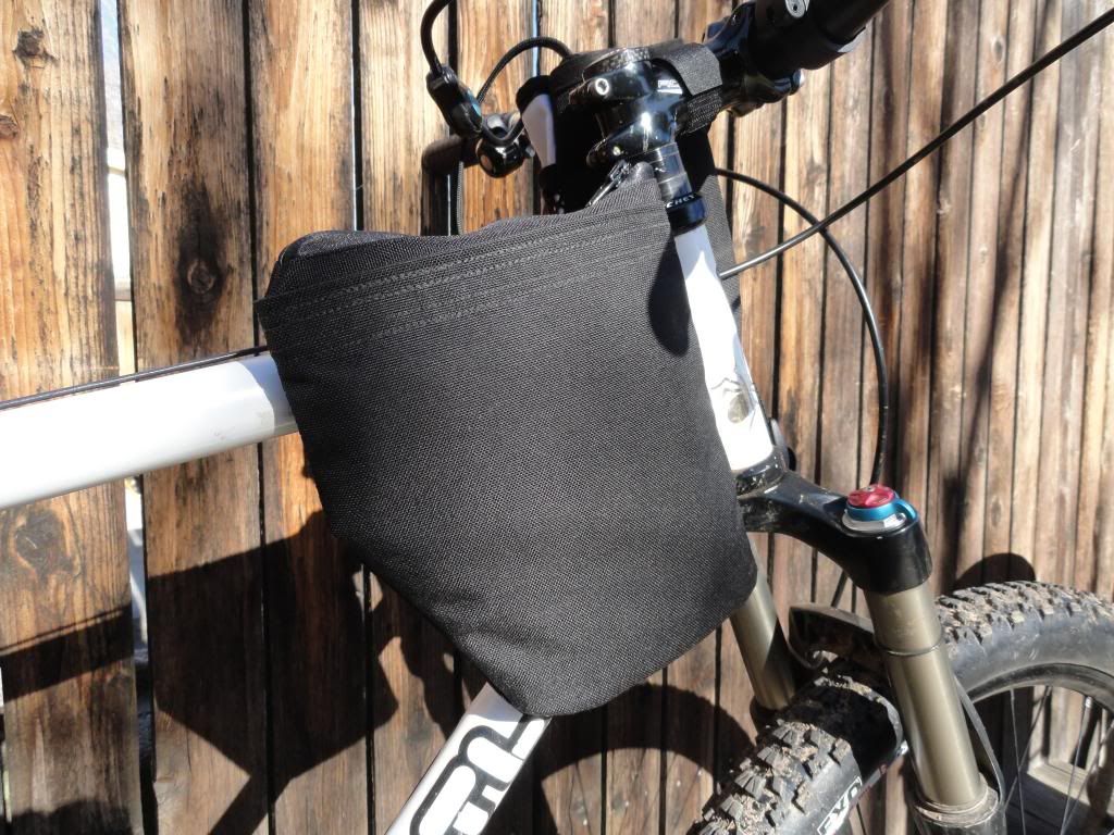

    Frame bag is bolted to water bottle mounts and has a shock cord top tube mount. Super wide 3.5" flange, foam frame and mini cordura side rub panels. 4.5 oz
    Gas Tank is your basic gas tank. 1.8oz
    Faux harness is a stem bag in the shape of a beret that mounts to stem and has a nylon strap for front lower dry bag. Bag and dry bag weigh 4oz
    Upper front dry bag is kind of like a stuffable reverse harness. Twin nylon cam buckle straps mount it to lower dry bag and bars sandwiching cables in between. 3.5oz
    Material is black polyester, grey and orange silicone coated ripstop, blue cheap waterproof coated nylon and a little cordura in rub spots. Super light bags but hey I made them for AZT and CTR and I saved 1.25 lbs over the usual suspects gear.

    Introducing the HalfPipe top tube bag. This idea had been bouncing around in my head for awhile now.
    Was is worth it? Would standover be suitable?
    So far the answer is a big Yes. I've gotten a lot of positive response to this design.
    Nowadays with the ever popular dropped top tubes, there is a lot of real estate for people to use.
    Attachment 875824
  • 03-10-2014
    1 Speed
    Nice name, interesting bag. For some people, that'd definitely be a great bag. I've had a couple of people ask about something similar but thus far, the standover height of their bikes has been too high for it to make sense.
  • 03-10-2014
    HomegrownMN
    For sure the biggest limiting factor. At 6'2" and ~34 inseam it works for me. Also the nature of the Fargo and bikepacking in general
    lends itself to a mellower riding style that a rapid dismount isn't usually required.
    I kept the side stiffeners out of the middle on both sides to allow some compression if needed.
