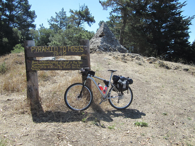

    I built up my old Access29er frame with some parts bin parts, bought a set of BB7s and XT dual control levers. I'm stoked to finally get it rolling well enough to take it out for a test ride.
    <a href="https://picasaweb.google.com/lh/photo/z6ebxf5uJMxLkMJYlWYGldMTjNZETYmyPJy0liipFm0?feat=e mbedwebsite"><img src="https://lh5.googleusercontent.com/-Gxeeck1EqoA/UeL6T6xLlKI/AAAAAAAAhmc/gxFZ5HNte7Q/s800/IMG_5100.JPG" height="600" width="800" /></a>
    I probably have about $150 in new parts I had to buy to make this happen, but that's not too bad. The rest was sourced from the junk in my bins. I still need some adjusting, like I need a shorter stem (the bike is an XL size... too long for me normally) and my 12 year old XTR derailleur does not play well with a 36t big rear cog. The top derailleur pulley rides directly on the big cog, making noise. I like a silent bike.
    I was having a blast on a loaded local test ride at Joaquin Miller Park, until I got to a steep climb locally known as Two Dollar Hill... and then, POP! I broke my Shimano XT M770 freehub. Yeah, its a common problem with this hub. They had a bad batch of pawls a while back, and I thought I avoided them... but I was wrong. I ended up riding the bike back home, fixie style!
    So, still working out some bugs (like now, I need a new freehub body) but it railed the singletrack pretty well.... including some techy descent stuff. I had like 12 pounds of junk in the panniers including my 3.5 pound tent strapped to the rear rack... just as a test load to see how it would feel.
    Getting close to a ramble!!
    <a href="https://picasaweb.google.com/lh/photo/Yjal_eJa8fWcKJZ9LfjldNMTjNZETYmyPJy0liipFm0?feat=e mbedwebsite"><img src="https://lh6.googleusercontent.com/-kveogg9YWWU/UeL6WdpeCqI/AAAAAAAAhm8/erE-W0NOV7E/s800/IMG_5104.JPG" height="600" width="800" /></a>
    I've been riding at Joaquin Miller Park for over a decade, and I've never seen this pyramid. Crazy.
