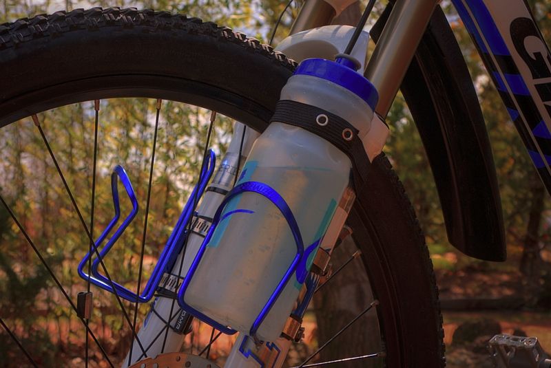

    The supports on these <i>Specialized</i> cages are tongues, that allow hose clamps. These hose clamps for the Fox fork were 304 grade stainless, at 21-44mm.
    35mm maximum, would have been a better size hose clamp, giving less tail to catch in the grass.
    Leeboh mentioned rubber pads, I cut the pads from an old inner tube.

    Never thought cages like that would be able to hold bottles with the vertical movement of a suspect fork.

    Salsa stainless cages actually have slots for hose clamps/zip ties. I have one zip tied to my down tube, but for a fork I would use hose clamps and rubber pads.

    Bob, G'day. Absolutely.
    In the photo above, cheap orange twine holds those bidons in the cages.
    I made my tethers for the bidons on the fork, out of sticky-back Velcro tape. With the soft side of the tape against the paint, of course.
    For the two bidons on the frame, I bought some elastic tape with press studs.
    You think that my fork is "suspect?"
    Three years on and it is still behaving faultlessly Mate. I hope your fork is equally fine. I'm an off-road tourer, not a bikepacker. Take a look!
