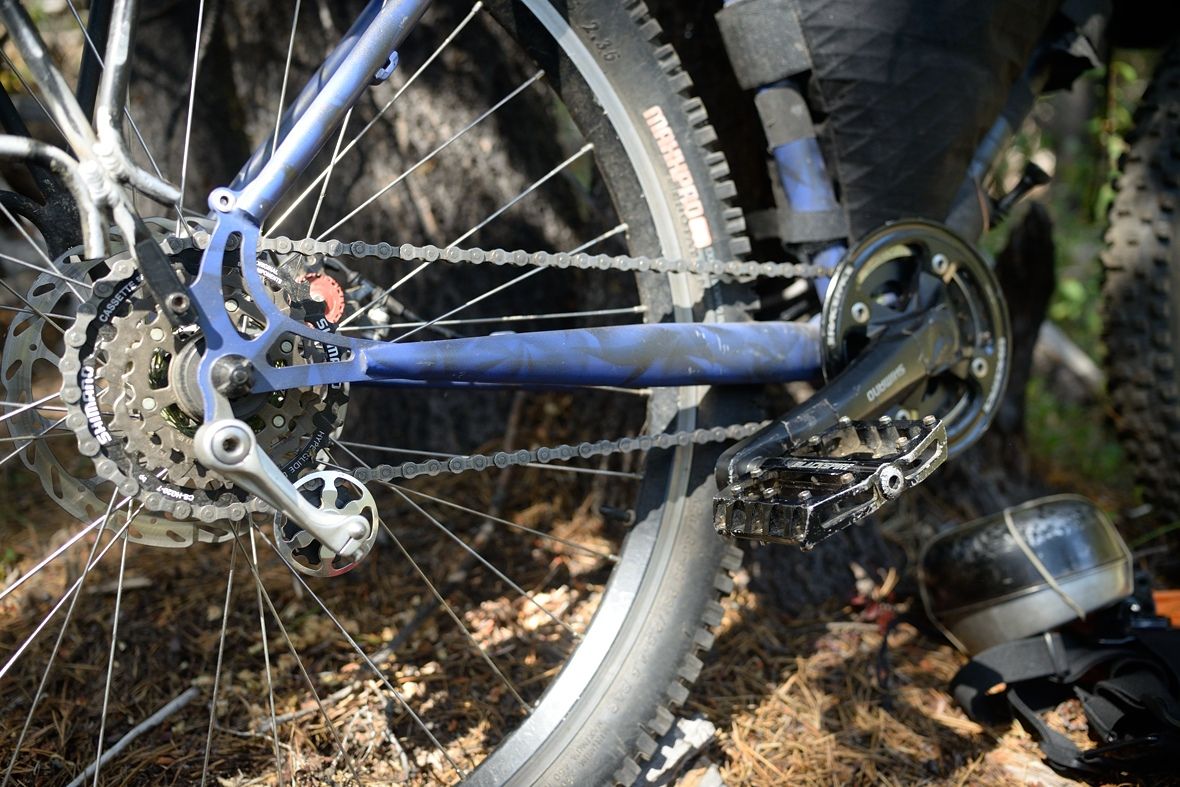

    Reputation: Mark_BC's Avatar
    Sep 2012
    792
    Quote Originally Posted by stremf View Post
    You run a tensioner on a fixed gear? Guess if the tensioning isn't off by much, that won't cause major issues.
    Yes, it makes it less critical to have the right chain tension, plus you don't destroy anything that goes around the chainring under the chain since the tensioner takes up the slack. Also makes changing gears easier since you don't have to loosen the wheel. Only takes a few seconds to move the chain between the gears.
    All I am saying is give pizza chants
    .44
    Reputation: stremf's Avatar
    Dec 2012
    1,229
    Quote Originally Posted by Mark_BC View Post
    Are you using a Surly fixxer?
    Sep 2012
    792
    No, a regular shimano freehub with 1 1/4" plastic ABS pipe as spacers.
