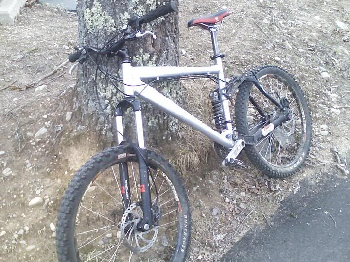

    Here is a shot of my current beater. Brushed 7075 aluminum. An old 1997 Trek 8000zx
    Shot at 2009-08-19
    Love that high polished look. Might have to try it over the winter on another frame I have kicking around.

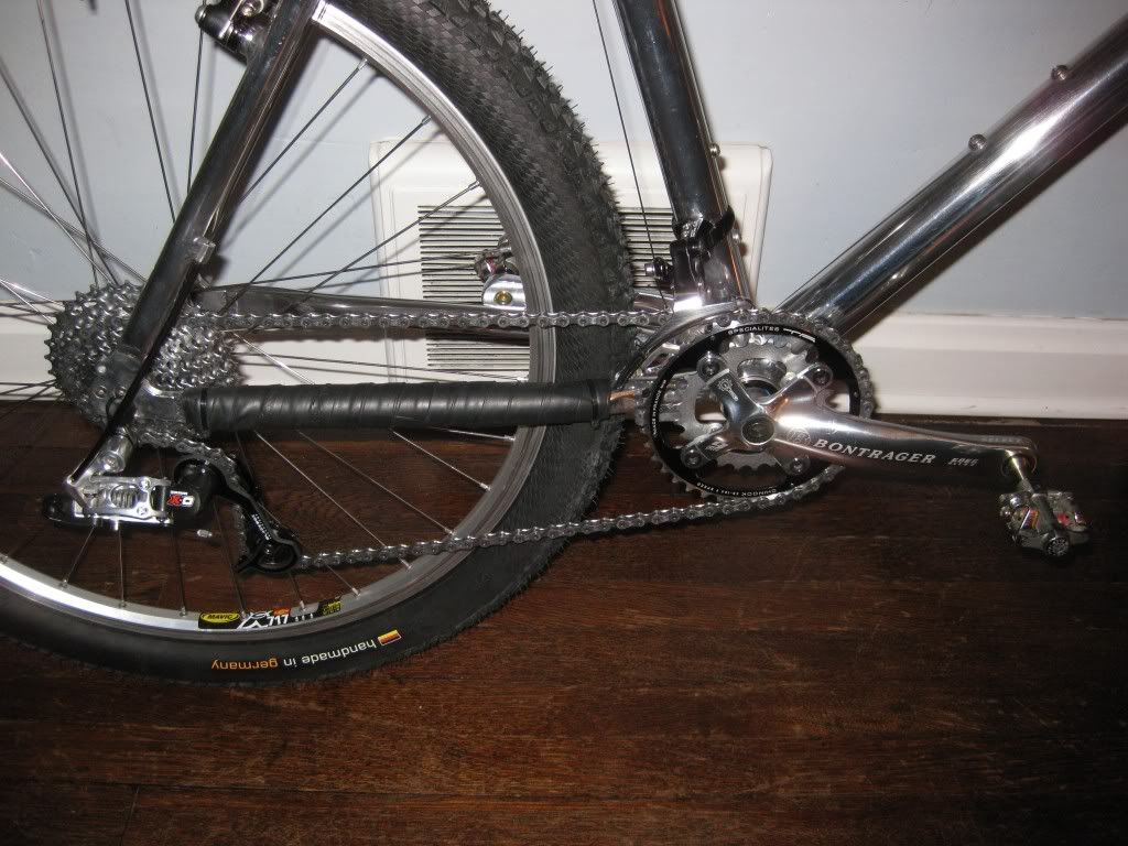

    BH1
    My old raw P.1 frame. I sold it a while ago.
    Aircraft strip and a power washer did the trick.

    Nice P. 1
    BH1, thats more of the look i'm after. What did you use to get that brushed look like that?

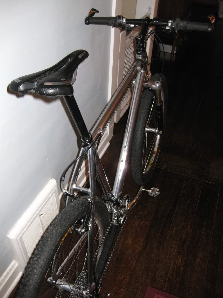

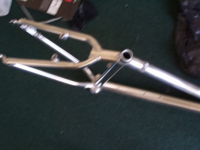

  • 11-21-2009
    yakuzafreerider

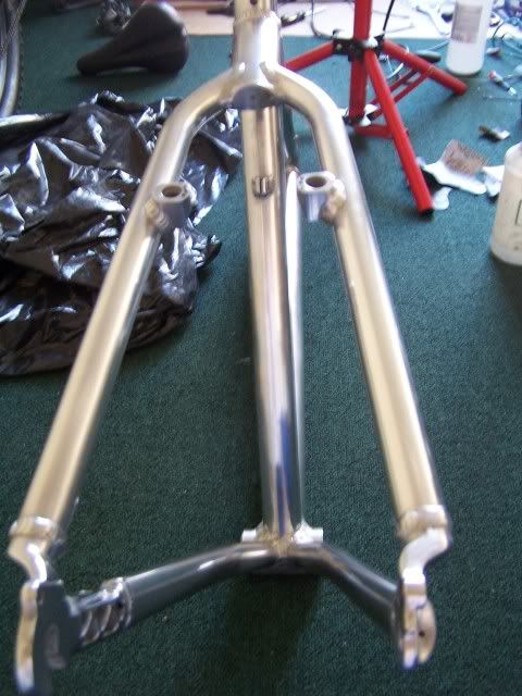

    here is my work in process....I stripped it down to give it a raw look now I'm polishing it up. This is just the first polishing, may do three or four more times. let me know what ya think.....
    this was before I tore it down
  • 11-21-2009
    bidaci
    ^^ Very nice. Post a picture once it is done. Can't wait to see it completed

  • 11-21-2009
    ghughes.hesinc
    [QUOTE=yakuzafreerider]here is my work in process....I stripped it down to give it a raw look now I'm polishing it up. This is just the first polishing, may do three or four more times. let me know what ya think.....
    I think that it looks awsome just like that! What have you done to get to that point? Good luck with the finishing polishes, it should shine up great if your already there with just one polishing. I'd love to see the finished product.

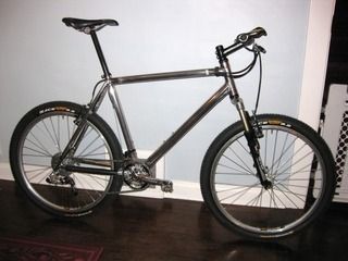

    5 Attachment(s)
    Here's my 2003 Epic

    yakuzafreerider
    [QUOTE=ghughes.hesinc]

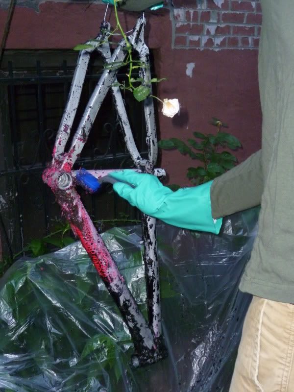

    well at that point, 3 cans of aircrat stripper, wire brushed everything, steel wool. As of today I sanded it with 800, and 1000 grit sand paper (wet sanded) and polished it 4 times. Its not a mirror finish but pretty darn close. I don't wanna get to crazy with it yet just want it to look good and be ready for powder coating if this doesnt grow on me first LOL hunters will definatley see me or be blinded! I'll post pictures tomorrow....

    Thanks - A buddy of mind did everything. Jasco Paint Remover, lightly sanding, and mothers polish.

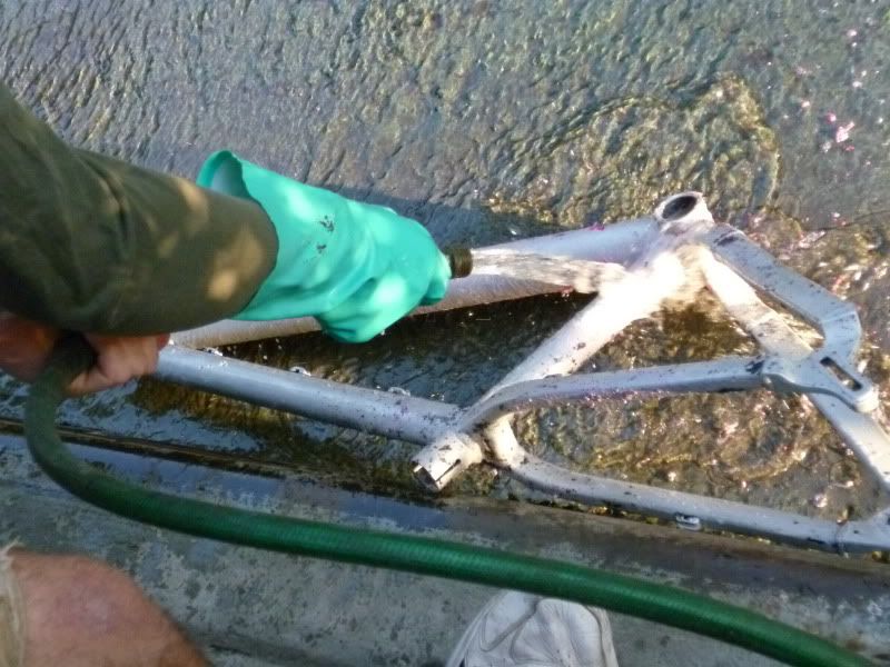

    I used a pressure washer to literally blow the paint off the frame after it had bubbled up... So some of the swirls you see are from the pressure washer, but after that I used a fine-grit sandpaper to smooth out the finish and give it a slightly scuffed/polished look. After about a month of riding and no cleaning it began to oxidize and darken around the welds similar to the raw Intense frames...

    yakuzafreerider
    well here it is semi-back together. Thinking of stripping and polishing my front wheel and doing the rear in black. Its gonna look so pimpin when finished!

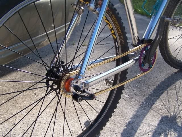

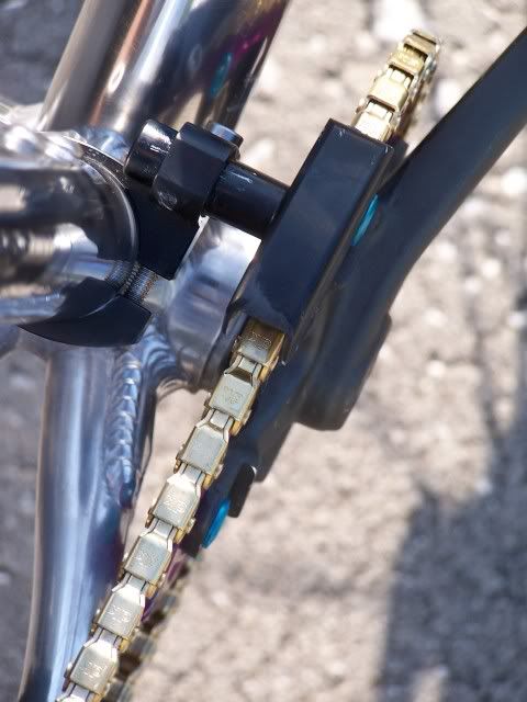

  • 11-23-2009
    BunnV

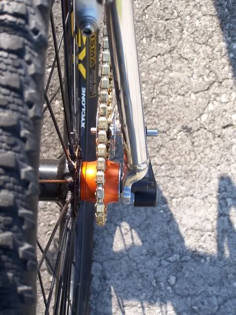

    Not a frame, but it is raw (and polished)
    custom I9's :cool:
  • 11-23-2009
    yakuzafreerider
    Originally Posted by BunnV
    custom I9's :cool:
    Very nice...thats what I'm hoping to do...dig the orange spokes!

  • 11-24-2009
    mmanuel09
    Very Very Nice Guys. BunnV - I am totally digging the wheels. How do you like the windcutters? I've been researching those and just wonder how they will do with Saint M810's which is my current front caliper.
  • 11-24-2009
    BunnV
    Thanks for the compliment on the wheels!
    The Wind Cutters totally exceeded my expectations! I bought them based on their claimed weight of 92 grams. One weighed exactly 92 grams on my scale, the other 93 grams.
    I have Hayes Stroker Gram calipers and was using the stock Hayes V6 (?) 160mm rotors. The stopping power of the Alligators vs. the V6's is no comparison! I have almost TOO much bite now with the Wind Cutters. They didn't howl, or screech but they do make a different kind of sound (kind of a metallic rub) than the more conventional rotors they replaced.
    On my first ride with them I found myself over braking and skidding (bad!) especially on the rear, and I don't even use the rear hard. Luckily the Strokers have great modulation and I was able to get a better feel for them over the course of the ride.
    They were only $15 each which is really inexpensive considering their weight and apparent quality. I love them!

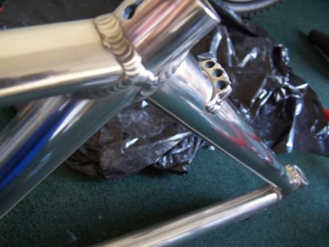

    Well, you guys convinced me. The paint is gone, and the sanding has begun.
    I scotchbrited everything to get ride of all the paint. I was surprised to find quite a bit of scratches under the paint. So I've been sanding those out with 320 grit. Moved on to 600, 900, and will finish with 1200 grit. Then polish and shine.

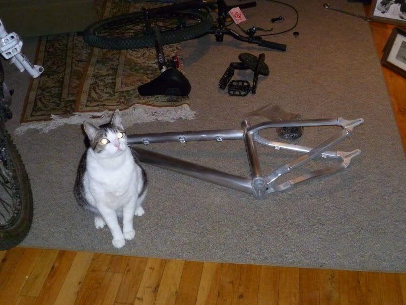

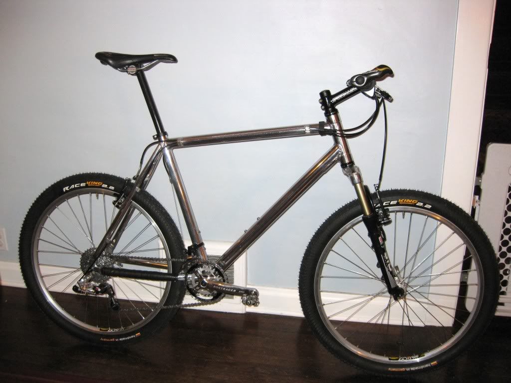

    Finished product
    Well it's all done. I ended up going polished, just couldn't get a consistantly uniform brushed look. Over all I'm pretty happy with how it came out.
    It's way better than the beat up paint that was there. Thanks for all the advice everyone, isn't this site great.

    Finally!!!
    After too much time trying everything under the sun. Here they are.

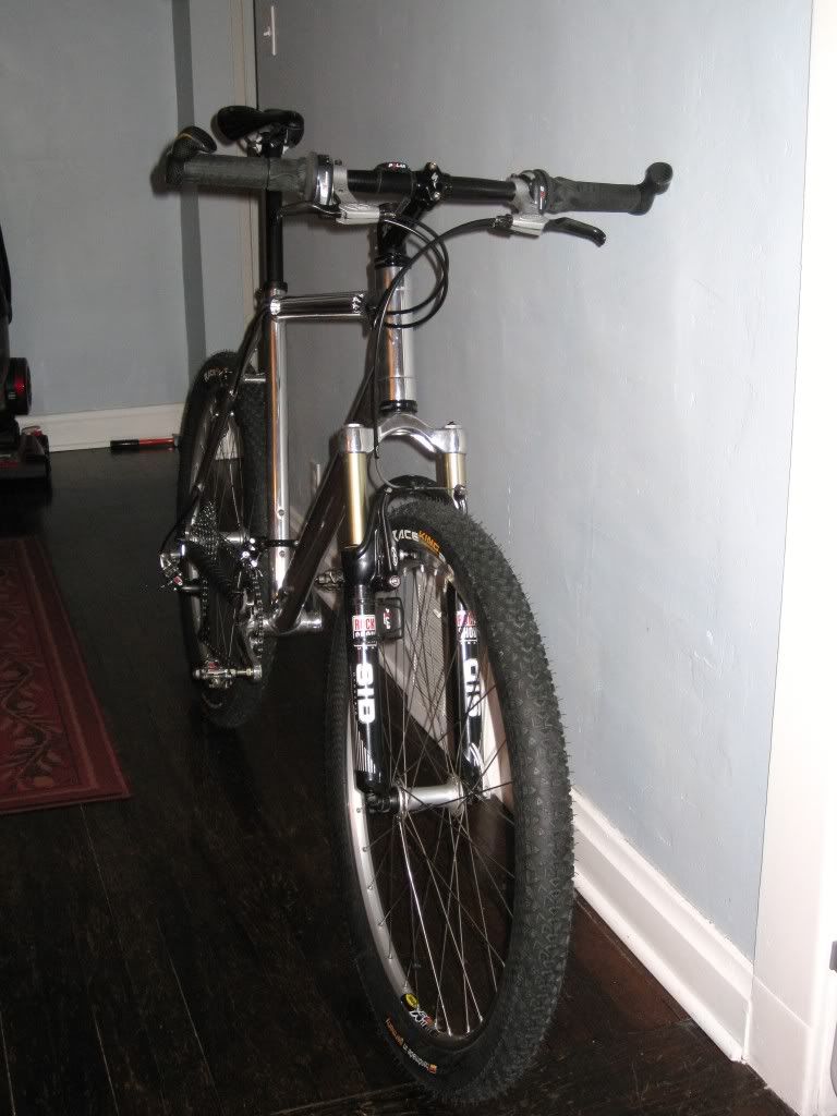

  • 12-04-2009
    yakuzafreerider
    this is what it used to look like
    This is what it looks like as of today, its ready to ride but not all upgrades I want are on it yet....

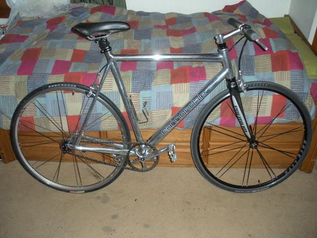

    well ive been doing one my self and here it is http://www.flickr.com/photos/sausagedog77/4197009985/
    ive found that if you polish down the tubes it makes it dull but if u polish across then it make its shine more, all due to the grain when the tube is made.

    That Cannondale sure looks nice! I love those crossing tubes.

    ghughes.hesinc
    Finally Done!
    Well I just thought everybody might like to see the finished product. I finally got in the last bits and pieces and finshed it up tonight. Hopefully I'll be able to get out for a ride tomorrow.
    Hope you all like it. Thanks for all the inspiration.
  • 02-05-2010
    mmanuel09
    WOW - Fantastic. All that hard work paid off. What did you think of the whole process and how it turned out? Have a great ride....

    PG256
    Some of these look pretty good.
    Here's my 80's Polished Cannondale SS commuter:

    ghughes.hesinc
    If you spread the sanding and polishing out over a week or two it's not too bad, almost enjoyed it. Over-all i'm very happy with how it came out.
    I could have went a few grits higher with the paper, but I decided that a 1995 frame should remain to look like a 1995 frame. I didn't want to be able to shave in it.

  • 02-21-2010
    bear
    Then and Now
    I posted on this over in the Titus forum but the short of is that I spent the last month rebuilding/restoring my 7 year old Quasi-Moto.
    I think she came out pretty nice. Long Live Raw Aluminum!

  • 03-13-2010
    gbosbiker
    4 Attachment(s)
    heres my baby. i just finished her up today. it took roughly 4 hours of buffing and waiting. all i did was use a little steel wool to give a little shine to it. but i will never use a bit of polish on it.

    1999 Trek 8000. finished it a week ago.

  • 06-07-2010
    yakmastermax
    Finaly got around to stripping my Haro Thread 8 Dirt jumper
    Previous owner had rattle canned it without even taking the headset or the BB out.
    I was a little tentative to take on the project but it went quite smooth. 1 week's worth of allowance (30 bucks) bought everything needed:
    Jasco epoxy/paint remover
    good gloves
    paint tin
    brushes
    drop cloth
    steel wool
    plastic bristle brush
    Like i said, things went really well (only 2 chemical burns, should have put on pants not shorts!)
    the jasco stuff is powerfull! Don't hesitate! try this yourself!
    The jasco tin says 15 minutes but within 2 minutes i could hear the popping and crackling of the paint bubbling off:
    that was one coat of jasco (quarter tin at most) but i had missed quite a few spots - washed it off with water and did another coat of jasco
    water and soap gets the goop off
    all done! (polished with coarse then medium steel wool) (cat not part of the project)

  • 06-18-2010
    CS2
    Great looking frame. You have to post some pics of the complete bike. BTW what is it? Kind of Old School.
  • 06-18-2010
    ghughes.hesinc
    Yeah it's old school. It's a 1995 Gary Fisher Paragon. Now that GF is no more I kind of wish I left the paint on it. Oh well it still looks way better than it did.
    Their are some pics on the first page of this thread. But here's one for ya.

    Nothing like some of the shiny rigs I've seen in this thread, but I've changed some of the spec so here is my beauty again...

    iv always wanted to polish a bike frame. my son and i just finished this 12inch jamis 26inch wheeled bike. enjoy!

    thunderzy
    Ok. I stripped my front triangle on my full susser with aircraft stripper. Took me 1.5 hrs to get it looking very clean. I want to strip the paint off my rear triangle but I do not want to damage the bearings. Can I strip the paint while keeping the bearings in place? Will the paint stripper damage the bearings? Or should I just leave it black?
