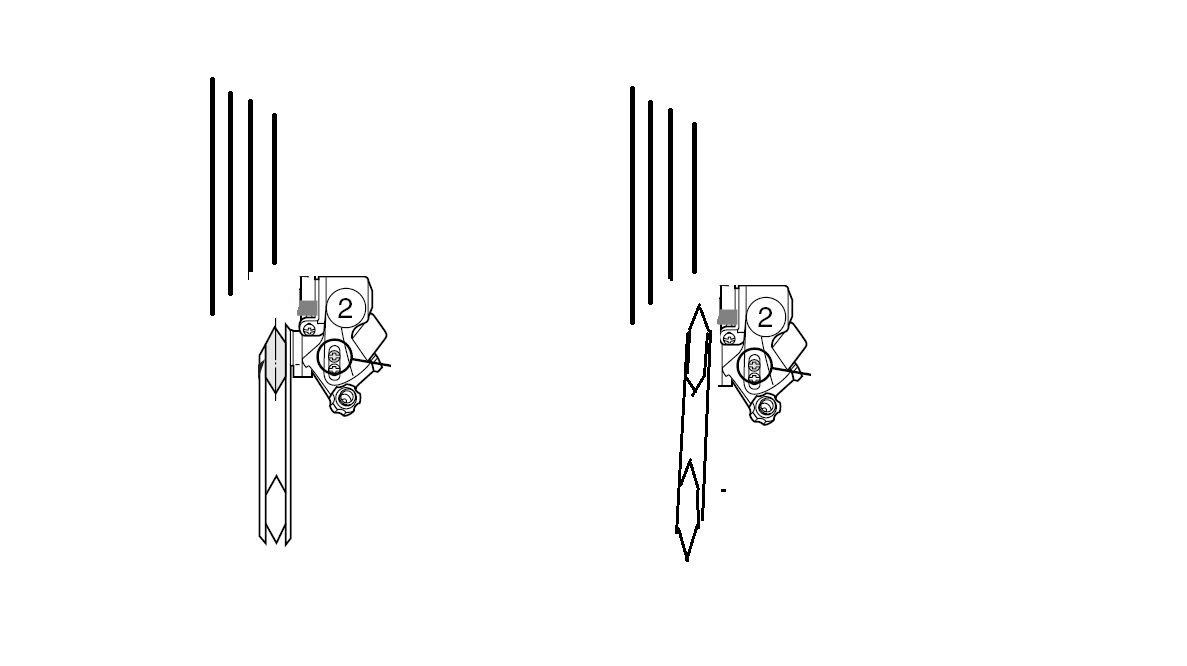

    Rear derailler sits at an angle? High-Low adjustments do nothing, PLEASE HELP URGENT
    Derailler model : Shimano Alivio
    I have work tomorrow and I need this fixed. I was messing with it trying to tune it because I noticed it always sat at an angle, towards the spokes. The high and low screws dont tilt it the other way, only more inside. I released the cable tension.The pulley also wiggles a bit, side to side. But I cant tighten it...there's no bolt where it attaches to the main derailleur unit, unless its behind the chain.
    Also the B-tension adjustment screw doesnt do anything noticable. The instructions say its supposed to line up the guide pully closer/further from the sprocket but it doesnt even move. What going on?
    Please give any advice you can think of. I have to bike to work 20 mi tomorrow, my car doesnt work.

    Hanger is probably bent.

    Your hanger is bent, you have a low quality derailleur, and you're impossibly far from being able to grasp what any single one of those adjustments is actually for. You need someone to run thru this in person.

    I agree about your hanger being bent. Take the bike to a bike shop. They'll have a tool to use in realigning the hanger. Pay them to fix or replace the hanger and readjust your derailleur.

    There's no adjustment to fix that, either your lower cage or hanger is bent. It happens, usually from either the derailleur hitting a rock or a stock getting stuck in there.
    210
    1) Your hanger is bent.
    2) The B-tension screw does actually adjust something, but in very small increments; you won't be able to tell by looking.
    3) I don't know why you'd need to de-tension the cable to adjust the limit screws. High or low.
    4) Yes, most shifters allow you to grab multiple downshifts with one go. Higher end shifters can grab 5 gears with one throw of the shifter (if I'm not mistaken).

    Update: My hanger is NOT bent. Straight as an arrow. I'm 100% sure. The problem is that the lower pully arm is loose, it has a bit of wiggle in it where it meets the derailleur. (see picture).
    Worst part is, after taking the derailleur apart, there seems to be no apparent screw/bolt to seat it firmly. It appears to just be pressed in, as in, a machine-press was used to insert it there. Anyone ever deal with this before? Do all derailleur pulleys arms come pressed in?
    If it could have just had a screw there, i could tighten it and the pulley arm would sit flush and the problem would be fix. (I know this because wiggling it back to its original position lines it up vertically perfectly)

    How are you "100% sure" the hanger isn't bent? Do you own a derailleur alignment gauge?
    Slop in that area of the derailleur means it's probably shot, not surprising for an Alivio. $33 from Jenson, and yes, any derailleur regardless of price point has no adjustment when that pivot wears out. It's just that the more you pay the longer it'll last.

    im sure because this bikes never been dropped, and I took out the hanger and its not twisted/bent/warped. Sits flat on a flat surface.

    You know the entire history of the bike and that the previous owner never dropped it??? Without one of these, you can't be sure that it's on a parallel plane to your rear wheel which is how it needs to be aligned.

    Does it shift OK? If so, ride it until it doesn't.
    If it doesn't, get one of these:
    http://cgi.ebay.com/SHIMANO-DEORE-RD...item588f217cd4
    Do this:
    Rear Derailleur Adjustment:
    1) Shift the bike to the smallest cog (9th gear if it's a nine speed setup). Turn the cable adjuster on the shifter for the rear derailleur (right end of the handlebar) all the way in and then back it all one full turn. If you're using a Shimano derailleur with a cable adjuster where the cable enters the rear derailleur, do the same thing with that adjuster that you did with the one on the shifter.
    2) Loosen the cable nut on the rear derailleur and gently use a pair of pliers to pull the cable fairly snug (but no need to pull it super tight), and tighten the nut a little over half way tight (tight enough that it won't move when you shift while adjusting, but no so tight it will disfigure the cable in case you have to make an adjustment before you're finished).
    3) Shift the bike to 2nd gear and look at it from the rear of the bike. Use the cable adjuster (on the rear of the derailleur if it's a Shimano or at the shifter if using SRAM) to adjust the top pulley on the derailleur so it is lined up exactly with the 2nd to largest cog on the cassette. You use the adjuster on the rear derailleur for this step if using Shimano so that you save as much room at the shifter as possible for subsequent on-the-fly adjustments.
    4) On the rear derailleur, shift to the largest cog and look at the derailleur from behind. Use the limit screw on the side of the derailleur to adjust the derailleur so the top pulley wheel lines up exactly with the large cog when looking at it from behind. Shift down to the smallest cog and do the same using the other adjustment screw on the back of the derailleur.
    5) Again shift to 2nd gear and check the pulley alignment and then shift to the 8th cog and make sure it lines up well there too. Make any fine adjustments you can see are necessary.
    6) You are ready to test ride the bike. If it is not shifting smoothly, shift it to 2nd gear and look at it from behind. Hold up the rear of the bike and turn the pedal (it's easier if you have help doing this). You can also turn the bike upside down, but shift it first to 2nd gear so you don't have to do this with the handlebars on the ground. Watch the way the chain acts as you turn the pedals. If it jumps up toward the largest cog, turn the adjuster inward (tighten) one 'click' at a time until it stops jumping. If it is looking like it is trying to shift to a smaller cog, turn the adjuster as though to loosen it (this will in effect increase the cable length) until it stops trying to shift downward. Retest the bike by riding it. Repeat this step until it shifts perfectly.
    Move on. Be happy you are out riding your bike and stop beating yourself up over something that is really quite minor in the grand scheme. Bikes are supposed to relieve stress, not create it.

    CT3, i know its not bent because when I alight the cage how its supposed to be, its verticle to the cogs...if i let go of it, it falls to the inside. it just has too much wiggle play.

    Why does this method differ from the ParkTool method? See this is what confused me, my manual, and these websites all have different derailleur adjusting methods.
