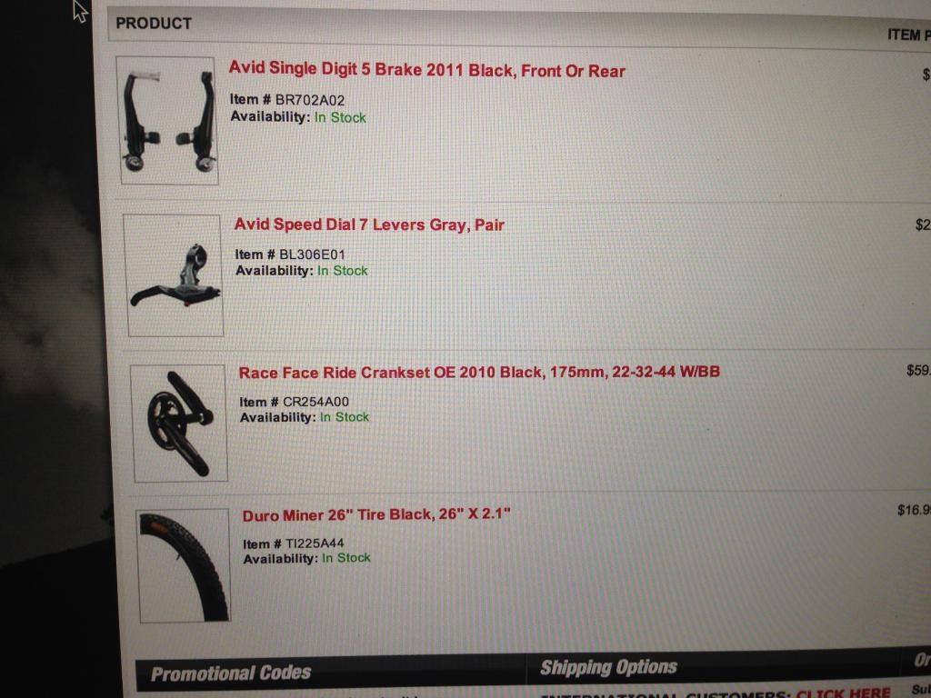

    Okay, so i have made a few changes to my purchase and are definitely taking yall's advice into effect. I still want to go ahead and get some new levers, so I am going with the FR5s. I will pick out some other tires, and let you guys know what I have come up with. Money is just tight (24yo, just got into rental house, bills, blah blah blah) and I am doing what I can to upgrade the bike to be solid on the trail.
    I have already removed those stupid straps from the pedals, but I guess I will pick out a set of platforms to go with it as well.
    As far as the cranks, I will pay to have them removed and will install the new ones on my own.
    -Brandon
    2000 Gary Fisher Aquila - RaceFace Ride Cranks, Duro Miners, SRAM chain, Avid FR5 levers, Avid SD5 brakes.

    This is how my latest shopping cart looks now...
    -Brandon

    just thought i ought to add that i stuck with the duro miners and also bought a pair of Gusset Slim Jim LB pedals
    Got everything for $157 with free shipping.

    You need to know that some levers don't work with some brakes,the old cantilever brakes won't work with v type brakes. They pull different amounts of cable.

    The FR5 levers and SD5 brakes are two great tastes that go great together. Let us know how the build goes.

    Justin - I got lucky and found this gem on craigslist and figured it would be the perfect beginner bike for me. I can't wait to get this old girl out on the trails.
    Ronnie - Heck ya man! I was stoked yesterday when the box finally came in. Haha ya I could see how that is the case because that is exactly how I felt yestday too.
    Okay guys, I got the bike back and she rides sooooo much better! While it was at the shop, I had them replace the rear brake line and both front and rear derailleur cables. I could not be happier with the results.
    Only problem I encountered today was popping the rear tube about 2 miles from my house. If I had a dollar for every time that has happened...
    -Brandon

    She looks great! This is making me want to go out and spend money I don't need to on upgrades that aren't necessary.
    Maybe you had to get that first flat out of the way to appease the bike gods and now your safe for a while...

    Thanks man, I'm all done upgrading her for now. The bike rides so well now and I could not be happier. Just got done with a good 2.5 - 3 hour ride out and about in ATL. Wish I had more dirt trails that were close to hit, but o well. Soon enough I'm going to north GA and gonna hit some real trails.
    Haha I certainly hope so! I just purchased 4 tubes and a mini air pump so I am going to bring a couple and tools whenever I ride.
    -Brandon
