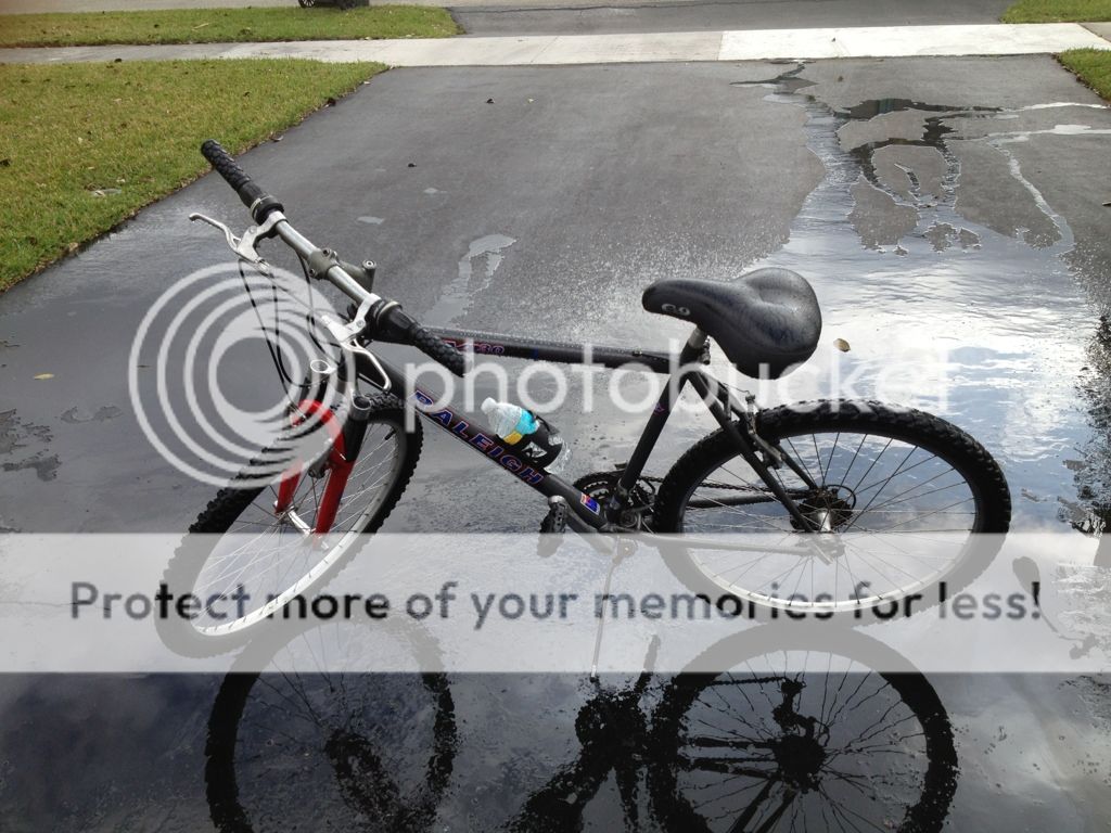

    Ok I just had a new problem come about hopefully someone can help. I got on the bike to go over to the trails and the seat tilted all the way back so common sense i knew the bolt came loose. I tightened it as far as it would go not once but twice and it still just keeps tilting back. How do i fix this? yes the seat post is fine at the tip and fits perfectly.

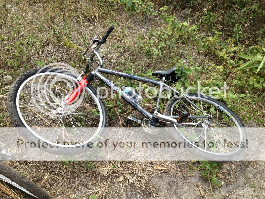

    Here's a picture from the trail yesterday:
    And after i cleaned it off:
    Had a good time couldnt complain.
    620
    Depending on the type of seat clamp you may need to replace some parts or the post. There should be some type groves in the clamp surfaces ,if those have been stripped then you need to replace the clamp or post . Either take to a shop or post pictures with it taken apart .

    I fixed it by deepening the grooves on the clamp. I hope it holds as a fix.

    In regards to your seat tilting, it is positioned very far back on the rails in your pictures. Most of the seat that is supporting your weight appears to be far behind the attachment point to the seatpost. Because of this you are applying a lot of leverage which is likely why it is tilting on you.
    If your fix doesn't work, slide the seat forward so that it is more centered over the seat post and then tighten it down.
