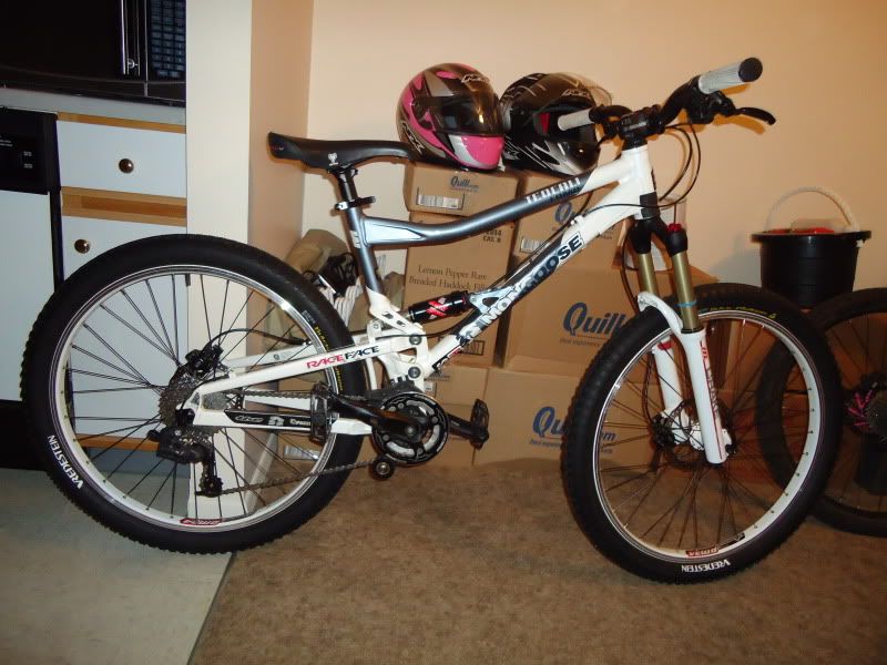

    You can buy mine!
    Its a bad picture(getting ready to move) But I havent taken a new picture in almost a year, so I figured I would.
