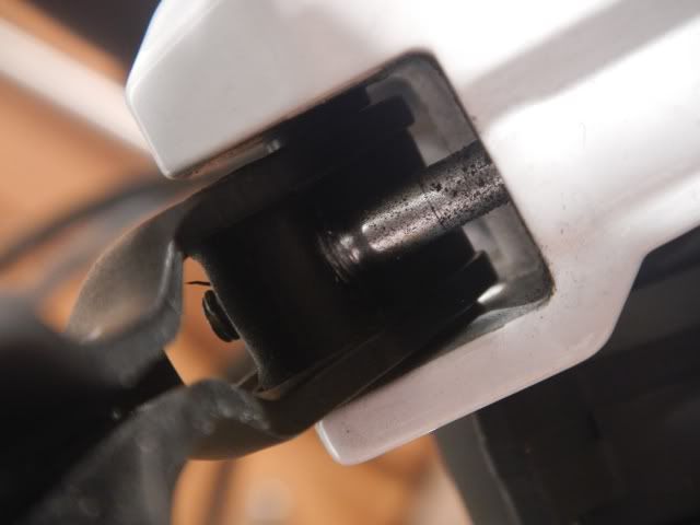

    Are you leaking fluid from anywhere? Let's be honest, if fluid isn't coming out then your lever shouldn't be migrating because of a need to bleed. A gradual progression of the lever closer to the bar with no spongy feeling is probably due to the reach adjuster (a little 2mm or 2.5mm screw you can see between the lever and the handlebar) migrating. Every Hayes brake I've ever had did this and I've seen a few models of every manufacturer that have suffered from this. A lot of times you can actually see how far the reach adjuster is threaded into the little barrel and make them even between the two levers. I would advise against hitting it with locktite unless you take it all the way apart and allow the locktite to fully dry before assembling; if you don't you risk getting locktite into places that could be dangerous if the brake isn't allowed to function properly.

    The reach adjuster thing is pretty much what the LBS mechanic said; the threading was equal on both sides as it was when I got the bike, but I'd taken it in for a service and maybe they'd fiddled with it... we're not sure, the guy that actually serviced my bike is pretty much my DFL choice for mechanics. When I got it back, the left one was further in and it seemed to get worse over the weekend (change = bad!). This morning, we didn't apply loctite, but we did adjust the reach adjuster. As you mention, it was a small allen key head, either a 2, 2.5 or 3mm (used the 3 way hex wrench). For reference, the brakes are Shimano M505 brakes.

    Here's some handy dandy photos of the reach adjust screw that we ended up adjusting. Looks like 1.5-2 threads on the left side sticking out, 3 threads on the right after adjustment.
