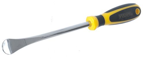

    Make and model please mate?
    Just google mountain bike tire lever... Dozens of options will appear.

    Quote Originally Posted by Brockwan View Post
    Pedros DH tire lever. Love 'em.
    Nothing you want to carry around in your pack most likely, but as a shop tool, 100000 times better than some little plastic thing.
    Pedro's Downhill Tire Lever | BicycleBuys.com

    Cheers both. Yeah the plastic ones are no good on mine.
    The only problem with the Pedros ones is they tend to find their way into your buddies' toolboxes.

    Quote Originally Posted by slapheadmofo View Post
    They can join the rest of my tools then ha!
