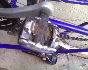

    I don't know what brand pedals I have, but here is a pic:

    Those are old shimanos if the bearings are smooth I'd clean em up and rock them! Don't bother with the chain just get a new one for this bike I'd think a kmc z chain will be great 8 spd. You are Gonna need a suspension corrected fork look at the surley offerings. For degreaser I'd use a good quality brakecleen type product don't bother with simplegreen it won't do anything for the grease....

    Any MTB shoe will work, but you will also need a set of SPD cleats.
