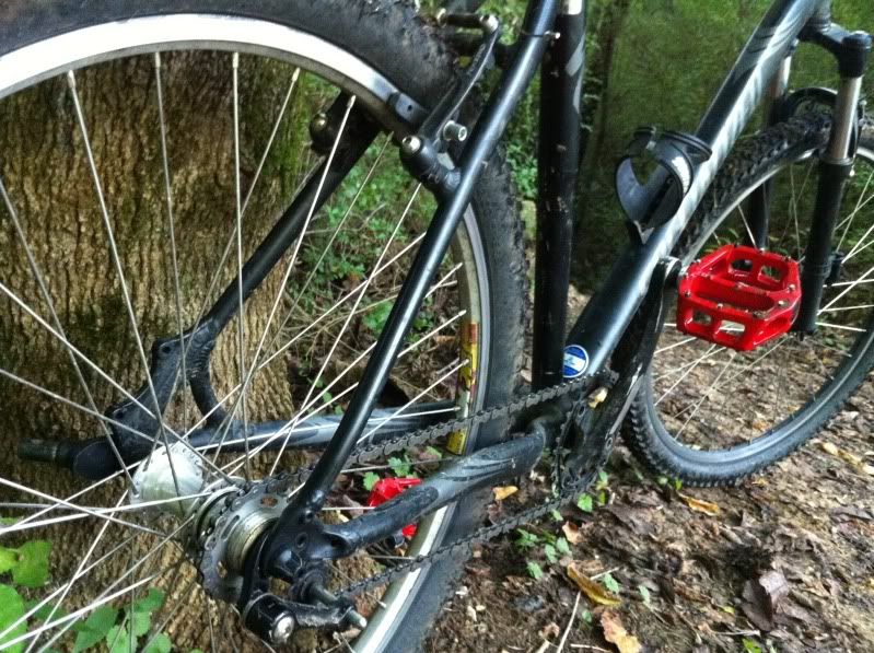

    Hey, hey, folks! Posting back with an update! Picked up a pair of red DMR V8s from amazon. First impression is all good! I loved them! I was very impressed with the grip, the ease of use vs clipless and the amazing comfort. My left foot was always sore after 20 minutes on spd's and I never was that good getting clipped in at the first attempt. Riding the flats was totally refreshing! Instant engagement, flexibility to move my feet around, really stable platform - I felt instantly connected to the bike and trail. I'm sold!
    I had a few instances where my foot slipped off during upstroke, but I think that is a reflection of a bad habit I had with clipless of really pulling up rather than simply unweighting that foot. That's an issue of technique on my part. When I employed the low heel technique, all was good!
    Thanks, all, for your help! Pics to follow.
    135
    More pics of the SS rockhopper!
