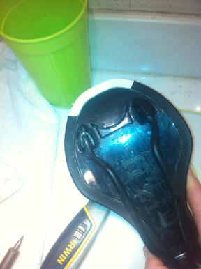

    My rail popped out when I ate it hitting a jump. I'd upload the picture of the bruise but I doubt any of you want to see the side of my ass...
    Anyways, I fixed it. I took a razor blade and cut 2/3 in the rail holder about 1/3 down from the top. Took a rubber mallet to it and it popped right in. I've tried everything to pull it out. I don't ride gently, I put it in a bench vice and yanked with all my strength. I think I'm good to go. I'll get some feed back when I get my bike on Friday.

    This has happened to me a couple of times due to pilot errors on 2 different saddles. both saddles were flexible enough that a bench vise and crescent wrench allowed me to pop the rail back into place with minimal "massaging" of the seat rail to get the saddle back level. I've read while doing a search that someone suggests using a hot knife or soldering iron (a heat gun at the right distance away may also work)to melt a slot so the rail will go in and then melt the plastic back around the rail. I've used a heat gun to repair dirt bike and atv plastics before. Since you've cut away part of the rail holder you could use some epoxy/ plastic repair around it if it gets out again. Good luck!

    Found an easy way with my WTB Rocket V race
    Quote Originally Posted by WillT View Post
    One of the rails popped out of my Fizik saddle, anyone know the technique to this? I've tried bending and twisting.
    Weird backward fall with this saddle popped out my Ti rails - end of ride and a long way pedaling standing up to the car….not an “on-the-trail” fix
    I bought the saddle as a takeoff on Ebay and did not use it for a few years, so WTB declined to help. After reading the advice and trying a few big wrenches, I found an easy way to do it using a large flat head screwdriver.
    1. Place the saddle upside down on a firm counter-top, and insert the nose part of the rails into the saddle.
    2. Place the screwdriver at about a 30 degree angle with the blade just above the hole.
    3. Position one rail high up on the flat part of screwdriver blade, then slowly slide and guide the rail downward vertically until it finds the hole.
    4. Repeat for second rail.
    I had to angle the screwdriver a bit to get it started, but I could lever it a little toward the end. I’d bet a steel putty knife would work too , as long as you didn't flex it until the rail was very close to the hole. The second rail had to move further, and took a little more force, but total force was surprisingly little.
    I was so happy to get it done and save a hundred bucks. I have not ridden it yet, but if it is a problem, I’ll report back. I hope this solution works for you!
