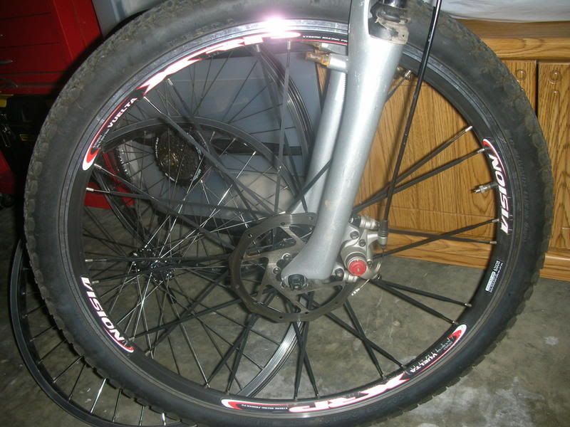

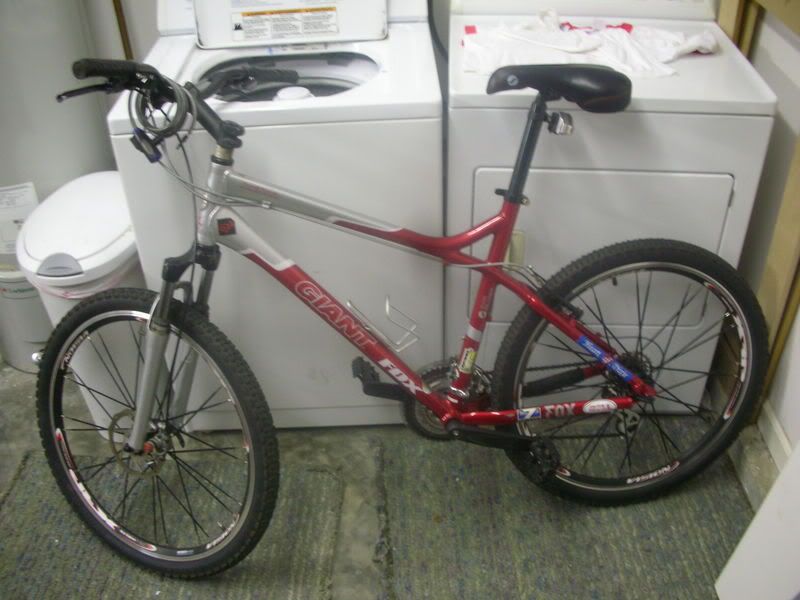

    We have similar situations it seems. I have a 21" Boulder SE, I'm 6'3" and about 215. I commute with it, and occasionally trail ride it. Haha. Anyway, I put a disc on the front of mine with the original V-brake on the rear, and it works great. I got the Avid BB7 mechanicals. I love 'em. Very easy to install myself (bike repair noob here). The only problem is when they get wet, they squeal like a stuck pig, and I had to get a new wheel set to fit the rotor. The new wheels look pretty sweet though, so it was fine, plus they were fairly reasonably priced because they had blemished stickers on them. My original brake pads do not squeak on the new rear wheel, and I feel like they have more bite than before.
    But anyway, I stumbled across this thread while looking for a solution to my problem. Hopefully it doesn't happen to your bike, but my front fork squeaks like crazy now. I didn't ride it much over the winter but I have been riding it for a few months now, and I kept hoping it would just stop if I worked it out. This seems to not be the case. Any ideas on how to get it to stop? Could it be taken apart?
    Reputation: TTownEP's Avatar
    25
    I figured that problem out a while back with my squeaky fork, in case it happens to anyone else. This bike got left outside while I was moving for about 2 weeks and apparently got rained on. Water got down in the fork, and rusted the spring. I took it all apart, wiped it all down and re-greased it. Not a squeak since. Also, the guts of that fork are super crappy quality...
