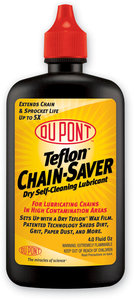

Old 03-03-2012   #1
Join Date: Feb 2012
Posts: 9
Rep Power: 0
Rep: XR1-Dude is on a distinguished road
user gallery
Chain Lube Questions.
Hello All...
Up till recently, I was using TriFlo on my chain. But after reading a lot of reviews, I settled on Rock n Roll Gold and Extreme for when it rains.
Now I applied the lube to the chain (dirty), and found that in no time at all, the chain became very noisy and the shifting quite harsh. So I decided to clean the chain (I have a Parks chain cleaner). Oddly, there was a greasy residue left in the Parks tool.
Question: Is this greasy residue left after degeasing the Rock n Roll lube or the Triflo..??
Right now, my chain, cassette and front chainrings are spotless. I am really unable to decide on the best lube to use. I have on hand:
- Rock n Roll Gold,
- Rock n Roll Extreme,
- TriFlo.
Ideas...??? Comments...???
Thanks..!!!
XR1-Dude is offline   Reply With Quote
Old 03-03-2012   #2
Probably drunk right now
Ken in KC's Avatar
Join Date: Jan 2004
Location: Kansas City
Posts: 6,130
Rep Power: 26
Rep: Ken in KC has much to be proud ofKen in KC has much to be proud ofKen in KC has much to be proud ofKen in KC has much to be proud ofKen in KC has much to be proud ofKen in KC has much to be proud ofKen in KC has much to be proud ofKen in KC has much to be proud ofKen in KC has much to be proud of
user gallery
Any...
Originally Posted by XR1-Dude View Post
Hello All...
Up till recently, I was using TriFlo on my chain. But after reading a lot of reviews, I settled on Rock n Roll Gold and Extreme for when it rains.
Now I applied the lube to the chain (dirty), and found that in no time at all, the chain became very noisy and the shifting quite harsh. So I decided to clean the chain (I have a Parks chain cleaner). Oddly, there was a greasy residue left in the Parks tool.
Question: Is this greasy residue left after degeasing the Rock n Roll lube or the Triflo..??
Right now, my chain, cassette and front chainrings are spotless. I am really unable to decide on the best lube to use. I have on hand:
- Rock n Roll Gold,
- Rock n Roll Extreme,
- TriFlo.
Ideas...??? Comments...???
Thanks..!!!
Tri-Flow sounds like a better lube for you. It matters more that you use lube, vs. determining which lube.
I use wet lube (like Tri-Flow) when I ride around town. When I travel out of town to dessert environments, I switch to a dry lube.
__________________
JPark - 3.5- don't listen to dremer
Ken in KC is offline   Reply With Quote
Old 03-03-2012   #3
3fast3furious's Avatar
Join Date: Dec 2010
Posts: 428
Rep Power: 2
Rep: 3fast3furious is on a distinguished road
user gallery
Tri flow is a very thin lube and it has properties to thin out and "moisten" other thicker lubes. What this has most likely done with repeated use is sort of dissolve the factory lube from withing the rollers in the chain. Its not really a good thing to clean and degrease a chain. That factory grease is the best stuff for the long haul. Sure cleaning makes your chain look pretty, but it dries out and you need to replace it every year. Since yours is already cleaned out, you can try a number or things to lube it again. One trick I used a lot (I know not everyone can do this) is to vaccuum seal the chain in a bag with lube. It helps penetrate all of the voids in your chain. I usually use a wax lube which is my preference but that may lead to having to do this more often.
3fast3furious is online now   Reply With Quote
Old 03-03-2012   #4
Mountain Man Dan
ProjectDan35's Avatar
Join Date: Jul 2010
Posts: 2,095
Rep Power: 8
Rep: ProjectDan35 is just really niceProjectDan35 is just really niceProjectDan35 is just really niceProjectDan35 is just really niceProjectDan35 is just really nice
user gallery
Chain L No.5.
/end thread.
That thin bodied lubricant is worthless.
__________________
The bike is nothing more then circles turning circles, It's the human motor that makes it elegant.
ProjectDan35 is online now   Reply With Quote
Old 03-05-2012   #5
they took the bar
javelina1's Avatar
Join Date: Mar 2005
Posts: 425
Rep Power: 16
Rep: javelina1 is a splendid one to beholdjavelina1 is a splendid one to beholdjavelina1 is a splendid one to beholdjavelina1 is a splendid one to beholdjavelina1 is a splendid one to beholdjavelina1 is a splendid one to beholdjavelina1 is a splendid one to behold
user gallery
Originally Posted by ProjectDan35 View Post
Chain L No.5.
/end thread.
That thin bodied lubricant is worthless.
Exactly! Chain-L. Just ordered another bottle. The stuff is liquid gold.
-Jav
javelina1 is offline   Reply With Quote
Old 03-05-2012   #6
Join Date: Jun 2011
Posts: 539
Rep Power: 1
Rep: ricky916 will become famous soon enough
user gallery
I use Dupont teflon chain saver , $6 at lowes, chain stays clean and quiet and I only lube it once every couple (2-3 weeks, I ride 3-5 times a week)
ricky916 is offline   Reply With Quote
Old 03-05-2012   #7
Probably drunk right now
Ken in KC's Avatar
Join Date: Jan 2004
Location: Kansas City
Posts: 6,130
Rep Power: 26
Rep: Ken in KC has much to be proud ofKen in KC has much to be proud ofKen in KC has much to be proud ofKen in KC has much to be proud ofKen in KC has much to be proud ofKen in KC has much to be proud ofKen in KC has much to be proud ofKen in KC has much to be proud ofKen in KC has much to be proud of
user gallery
Whatever..... poor advice...
Originally Posted by ProjectDan35 View Post
Chain L No.5.
/end thread.
That thin bodied lubricant is worthless.
The lube you use doesn't make it the end all, be all for lube. It's just lube. It's not a big deal.
__________________
JPark - 3.5- don't listen to dremer
Ken in KC is offline   Reply With Quote
Old 03-05-2012   #8
Titanium junkie
Loudviking's Avatar
Join Date: Oct 2011
Location: Black Hills
Posts: 1,074
Rep Power: 19
Rep: Loudviking has a brilliant futureLoudviking has a brilliant futureLoudviking has a brilliant futureLoudviking has a brilliant futureLoudviking has a brilliant futureLoudviking has a brilliant futureLoudviking has a brilliant futureLoudviking has a brilliant futureLoudviking has a brilliant futureLoudviking has a brilliant futureLoudviking has a brilliant future
user gallery
Tri-flo or White Lightning for me.
__________________
Climb into the sky, never wonder why - Tailgunner
You're a Tailgunner
Loudviking is offline   Reply With Quote
Reply
Thread Tools
Display Modes
Posting Rules
You may not post new threads
You may not post replies
You may not post attachments
You may not edit your posts
BB code is On
Smilies are On
[IMG] code is On
HTML code is On
Trackbacks are Off
Pingbacks are Off
Refbacks are Off
Hot Deals
Latest Mountain Bike Articles
Latest Lights Shootout Articles
Press and News Articles
Interbike - Virtual Trade Show Booths
All times are GMT -7. The time now is 01:32 PM.
Powered by vBulletin® Version 3.8.7
Copyright ©2000 - 2012, vBulletin Solutions, Inc.
Search Engine Friendly URLs by vBSEO 3.6.0
