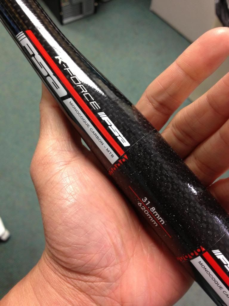

    Is carbon bar supposed to dent a bit when installed?
    Hi all - apologies for the newbie question.
    I just got a carbon flat bar. I installed it tonight. It says max of 6Nm so I used 5.5Nm on my new clicky torque wrench.
    However, I noticed it kinda dented where the pressure point is of the stem.....
    Is this normal? Is it cracked?
    I have installed it back anyway and took it out for a ride in the park - locked the suspension and banged on the bars hard a few times and did some rough wheelies and dropped wheel down hard to see if there will be any play or something but didn't feel anything.

    Did you go by the specifications on the Carbon bars or the specs on the stem? No, it shouldn't dent. It may be garbage now...

    that's not a torque problem. that's an uneven clamping surface problem. and yes, that's a problem for your bars. This is why I don't use carbon bars. you have to be real nitpicky about clamping surfaces, filing off edges and being super diligent about the WAY you tighten the stem faceplate to avoid compromising the bar the way you did there.

    That looks damaged to me. You may wish to have a qualified person give their assessment.

    Carbon bars often have a grippy coating around where the stem clamps and it is a little bit pliable. What you are seeing may just be that softer coating getting a little smooshed.
    However, it is hard to tell on the internet. I would have a shop look at it to be sure.

    Thanks - I've put it back on the bike... but I used 5Nm this time... I've contacted the place I got it from to ask..
    by the way, how am I supposed to install it? Was I supposed to put heli tape or something before I put in the stem? My stem is smooth and I made sure all sides were the same when I was tightening with my torque wrench

    Despite what I said above, I would not ride it unless you are sure it is not a dent or crack in the CF itself.

    As many horror stories that go around dont ride it until someone qualified can tell you its safe or normal. Carbon seems to be a very scary when failing material.

    by the way, this is what it looked like before i installed it:

    thanks. well i'm still using this handlebar.. just for commuting to work. I keep checking it and does not seem to have any play. when I get a chance, I shall take it to the shop I got it from and will ask.

    To me that looks like the protective layer in the clamp area of the handlebar is just smooshed. When you are tightening the clamps down they can grab that protective layer, stretch it, and bunch it up in the gap area as it closes. That's what it looks like to me but I would inspect the carbon underneath the protective layer. Neither of my carbon bars have that protective layer in the clamp area interestingly.
