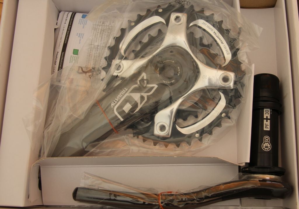

    I purchased a SRAM XO crankset as part of a build kit for a new bike.
    See below:
    I thought at the time that the bb30 was the normal threaded version where the PF30 was the press in one. I'm now not so sure that the BB30 is suitable.
    The new bike in question has a normal threaded frame for the bottom bracket.
    Does that mean I can get away with running a SRAM GXP type bottom bracket on this chainset? or do I need to sell this and buy a different one!

    No I don't think you can. The standard "english thread" GXP bottom bracket does not use the same shaft as the BB30 or PF30 version. The shaft on a "standard" GXP has a 24mm diameter (vs 30mm on the BB30/PF30) and is actually installed on the drive side (right side) while the fastening bolt is on the non-drive crank (left side), opposite to what you have.
    In addition, you have an extra preload ring on the crank shaft (that black ring on the non-drive side). You should try to return it and see if the seller will exchange it for a standard GXP one.

    The arms are different too. Look at how the axle sits in the arm. Now consider an axle with a 6 mm smaller diameter. You probably saved enough doing a parts kit vs. piecemeal to still come out ahead even after this, though.

    Nope, the BB30 and GXP cranks are totally different designs, and the spindles are permanently attached to one of the arms.
