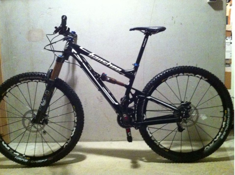

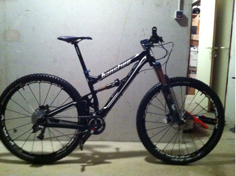

  • 12-05-2012
    eurospek
    First black one I've seen online fully built. Looks great! :thumbsup:
  • 12-05-2012
    G_g
    Glad they don't make small frames, it would look so awkward. At 5"11 I wanted to fit a large, they look a lot more proportional.
    Nice bike btw.

    All done, winterized version with ISP's:
  • 12-13-2012
    G_g
    Sakucee:
    seems you removed the lower part of the chain guide, how is that working?
    Also, how does the DHX-Air feel?
    Anyone tried the prime with a coil shock?
  • 12-13-2012
    FM
    Yeah, looks awesome Sakucee!
    What kind of dropper post is that?

    Haven't dropped a chain yet, there is way more slap since tension is lower (i don't have shadow+), some noise on lightest gears, not too bad.
    The DHX-A was custom tuned, but it needs a rework most likely, too soft when standing up and pedalling, seated it was ok with the lever closed, but the pro-pedal was also reworked so it is nowhere stock either.
    That being said it was sub zero and weather was... challenging and i didn't check BV pressures which might fix it, need to test again tomorrow, but i have re-work guarantee from the lbs, he will retune it so i'm happy with it, not worried.

  • 12-29-2012
    sakucee
    Originally Posted by FM View Post
    Lets hear your thoughts on proto vs. production!
    Front triangle is shorter vs proto, and headtube is shorter.. i can get handlebars and riding position dialed in very well now, frame is lighter, scale ran out of batteries just as i was building up so can't tell exact #, but you can feel it when lifting the bike around.
    I have way less spacers under the handlebars at the moment and riding position feels very good indeed with 2 rides out, in 2 weeks i'll fly to Tenerife where i was at with the proto so i'll get good comparison from there. :)
    Not gonna touch on pedaling characteristics since my shocks are so far off from stock setups so it would be pointless really. :)
