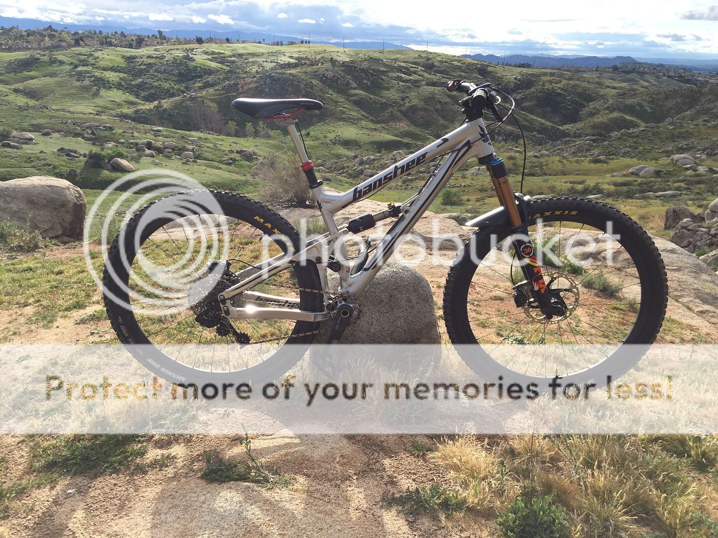

    Reputation: jbsocal's Avatar
    286
    Medium Prime
    Fox 36 Talas 160
    Cane Creek DB inline with RWC needle bearings
    X1/XX1 28t
    Shimano SLX brakes (203/180)
    Roval Fatties SL
    Minions DHF 2.5
    KS i900r
    Diety compound pedals
    Does anyone know if a Surly Dirt Wizard 29 3.0 would fit?
  15. #1515
    live long and huck
    Reputation: Optimus's Avatar
    5,568
    Nice build, jb, nice terrain.
    Low and slack.
  16. #1516

    Um JB, how tall are you? Ask as you have a setback post and the saddle slammed all the way back on the rails, and the drop outs in the slack setting, wondering if Medium is the right size for you or if it's too small and you're trying to use a short stem and compensating by pushing the saddle back to give room in the cockpit.
    Other than that agree, nice build and nice terrain to ride it on.

    He's "medium" sized if I remember correctly. I'm thinking 5'8 ish. I've sold him 2 frames in the past.
    286
    Yep, I'm short.
    I didn't realize the seat had slid back a bit, the seat clamp bolt was not tight enough.
    I'm getting the 650b dropouts, anyone know where to get a pair of Surly Dirt Wizard 29+ tires?

    Production Prime Photo/Build thread-wp_20150322_007-2-.jpg
    Here is a shot of my banshee. Same exact spot RideEverything posted couple days ago.
    Killer trail here in Whistler. (Business time or also called Duncan's trail, in function junction)
    I am 5'11, on a medium. Feels great.
    Fox DHX 5.0 coil w/ #400 ti spring (Also have an elka stage 5 around)
    Fox float 34 CTD 140mm kashima
    Stans Flow EX on Hope pro 2 evo 142
    Kenda nevegal X-pro 2.2 (soon to be Schwalbe hans dampf)
    Shimano XT M785 levers with Shimano saint m810 calipers
    160mm rotors
    One-up 42T with XTR shifter/SLX rear d
    Sram X9 175mm crankset with North shore billet 28T NW direct mount chainring
    Chromag Ranger 50mm stem with Sunline 762mm flat bar
    Chromag Trailmaster DT saddle
    Kind shock lev 150 (I wish they made a 200mm...!)
    Time ATAC pedals
    I don't like the CTD fork, I really one with compression setting!
    For those of you who run a coil shock, what spring do you use? I run a 400, with ALL compression full-open, weight 160 after taking a piss in the morning, so say 175-180 all geared up, and I need to go with a lower spring rate as I don't go through travel.
    Love this bike.
    I know most people at my height rides large, and I have no idea how! I rode a large spitfire last year and sold it right away, way too long. This medium, to me, is spot on.
    I had quite a few rides on the bike so far. I tried the slackest HA/Low bb/ long CS and hated it. Bike felt long and climbing was horrible. Living in Whistler, you'd think people would all run the slackest bike, but you have to get up, and the climbs here are pretty gnarly. And I LOVE to climb.
    I am super impressed as to how the prime climbs. My other bike is a chromag rootdown 29er hardtail (medium/large), which I love just as much. And I had both a turner sultan and a transition bandit 29 in the last year, both in large size. Hated the transition, really. Hated. This bike, to me, had no soul, nothing, nada. And it bobed all the time, you'd expect that from a single pivot, but it was worst than expected, and getting a pro deal was the only reason I bought it. The new 2015 transition looks killer though, and having a horst link is gonna help a lot. I kinda wish I tried the smuggler!
    The turner on the other end was the bomb. It climbed better than the banshee (not by far), but wasn't aggressive enough and had a 'super long' chainstay. Which is the main reason I swapped.
    I've been running the bike on the steepest HA/short CS/ and high BB setting lately. I like it a lot. I lost the middle range chips... and I'm pretty sure that'd be the perfect setting! I really have to find those little guys.
    Way to go banshee, now I really want to try the phantom!

    My "new" Banshee Prime 29+
    I posted pics of my Prime with 650b dropouts and Dirt Wizards mounted in the 27+/29+ forum:
    http://forums.mtbr.com/27-5-29/my-ne...l#post11994923
    I have not ridden it in the dirt yet, but I'm really looking forward to it.
    What an incredible "adaptable" frame...kudos Keith.
