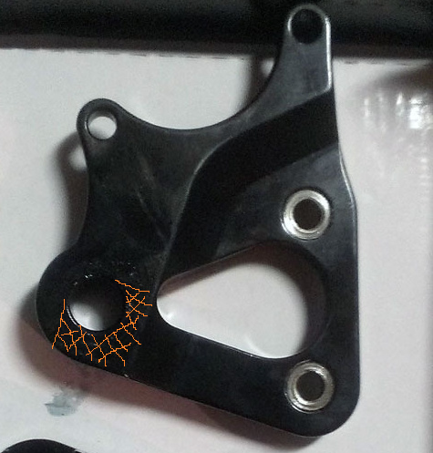

    FM...here is a pic of the drops, sans hanger. This is the inside of each.

  • 12-23-2012
    G_g
    Can't we machine the 135mm dropouts 3,5mm to make the channels and keep using the 142mm hub?
    Maybe create not a groove, but an area that allows the wheel to come from either downward or forward.
    Like, remove 3,5mm form the orange area:
  • 12-23-2012
    No, the spacing between drops is already 142mm...you would need a longer axle to do what you're suggesting.

    G_g
    I meant to machine the 135mm dropouts, but now I have seen they are 135x10...
    I thought that 142 was supposed to be just like 135mm in terms of disc calliper and rear dérailleur, and those 3,5mm grooves to easy with wheel install...
    Kinda wishing I had ordered another size of dropouts, I find the grooves to help with wheel install (having an old marzo 66 and a fox 36, the grooves in the fox 36 really help... In the Marzo you need to either have a 2nd person helping you, have it on a stand, or flip the bike upside down). One cannot lift the frame, hold the wheel and insert the axle at the same time. The grooves should enable the wheel to rest in the correct position
  • 12-23-2012

  • 03-18-2013
    el_guillyt
    3 Attachment(s)
    Re: Prime/Rune Dropouts/Hangers
    Hi everyone, I found in my drop outs kit for x12 two washers of 3.5mm each so here is the solution for the brake adapter, here some pics
  • 03-18-2013
    NoStyle
    These Washers must be new added to the Dropout-Kits. Those who received the first Batches of Frames and Dropouts (142x12) didn´t have them included. But anyway - my Shimming works for both 26 and 650B, but going to buy the new ones when they´re available. Hopefully there is a kind of Trade-in at Cost/Upcharge for the old ones to get the new reviesed ones ...
  • 03-18-2013
    pinkey
    In my package there where none included.
    Wondering if we need new (longer) screws for the brake adapter aswell or are the old ones ok and can resists die brake force?

  • 03-28-2013
    MalcolmX
    The ones we installed are plenty long enough ;)

    is it normal to have a slight play between the axle and the drop out hole on the non drive side? mine is a 150x12 drop out.

    Originally Posted by eightyfive View Post
    Any idea when the new dropout will be available?
    Just got an email from Banshee that the new drops will be available in August. A discount will be available for those who's drops are off by 3mm. Didn't say how much.
    what you mean with drops are off by 3mm, that you need the washer or?
    Please go through the thread and look at the above pics. Short version...yes 3mm off, no reliefs, people complained, Banshee listened and redesigned them for the 2014 bikes
    Yep - this! :thumbsup:

    sakucee
    Old dropouts also create problem with XX1.
    The derailleur is so far out that low limit screw starts to limit off high limit.
    So you need to make your 42t or 11t work like shit :(
    Of course i could try to lathe 1-2mm off the mech hanger... hmm..
    I had to do this on my der hanger for my Sram X9 Type 2 in order to shift into my biggest cog. The limit screw bas backed all the way out too leaving me with no other choice. It now works fine and dandy.
