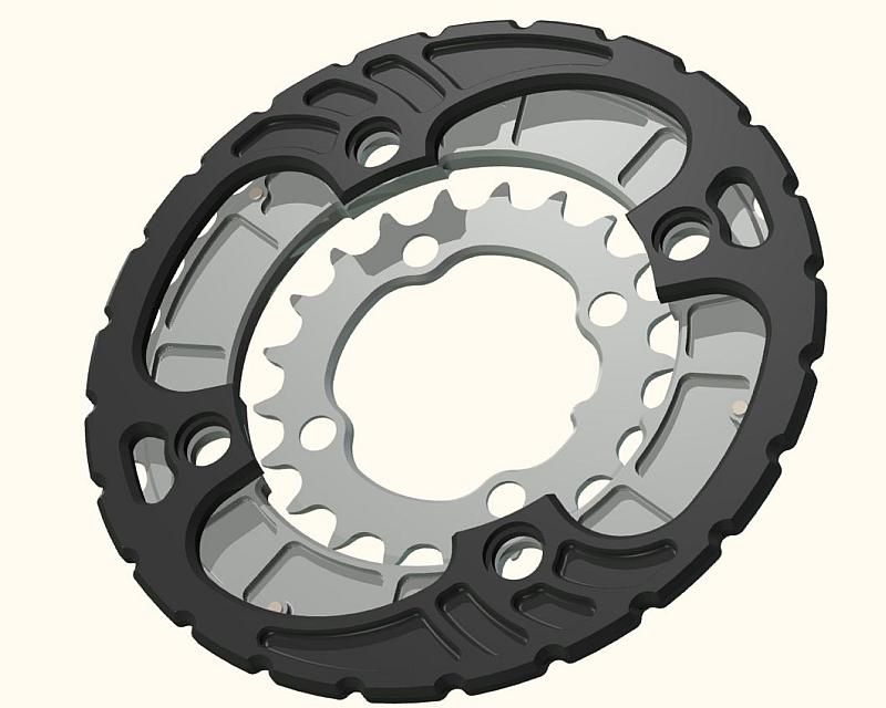

    Quote Originally Posted by murrayf View Post
    Note - the dropped chainstays on the Rune make it impossible to run the MRP G2 Mini in the correct position. I have it turned as far as it will go (anticlock) and the chain JUST clears the chainstay with an SLX GS rear mech, however with the Zee mech it does not because the chain doesnt get pulled downward enough from the guide pulley. So I had to remove the guide pulley and re-install my Bionicon guide. Works perfect, but isnt ideal.
    You could pickup the medium-angle backplate we make for the Mini G2SL ISCG-05 - that should solve the problem.
    We also make the S4 guide, that should work well on the Rune, as will the new AMg. The Mini G3 fits, but just barely. I dunno about Micro, but my gut says it should work. I'll ask our UK distributor ISON, they also do Banshee now.

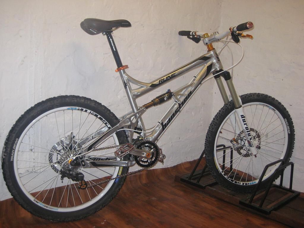

  20. #820
    111
    Heres mine almost done.
  21. #821

    Resnick: What frame size is that?

    111
    Medium

    Quote Originally Posted by NoahColorado View Post
    Nice ride!
    Thanks for the info. I didn't realize you can buy different backplates. Although they look like they are almost the cost of a guide so I'd almost be as well selling my G2 mini and going with something I know will fit. Let my know if you hear any confirmations from ISON, that would be great. Cheers.

    Story of my frame - continued.
    The frame is an XL - the actual TT measures 610mm and ST is 20". However the sticker on the frame is from the large frame.
    The rear triangle is crooked. With 150mm dropouts I get 140mm of space.
    EDIT: I attach pictures:
  72. #872
    34
    actual tt 610mm, what two points did you measure here?
    misaligned rear triangle stories is what put me off from buying a tracer.... haven't heard that banshee ever had similar qc issues
    how did the distributor comment?
    any pics of the rear triangle.... is the deformation visible to the naked eye?
  73. #873
    Reputation: uzurpator's Avatar
    Dec 2005
    528
    I measured center-top of the HT to center-top of the ST. This should work out to 635mm claimed as effective.
    The swingarm does not seem damaged. It is most likely Pacific Cycles being sloppy on the final alignment. I guess I cant cold set it to correct size, but you know, I bought this frame because I wanted warranty and cold setting without being allowed to sounds like voiding it
    BTW - I attached pics to above post.

    I have struck a deal with my distributor. Since I am not eager to wait 6-10 weeks for a replacement frame/swingarm, we concluded that I can mount the rear wheel and see if there is a misalignment.
    There was none visible, the frame is dead straight.
    Thus we decided that I can use the frame, and if there is even a sliver of doubt about integrity of the bike, I'll get a warranty replacement ASAP.
    So, with that in mind, my bike starts to take shape of this:
    The fork is at 180mm. I still wait for a few details.
    - Still need to bleed the brakes
    - Shorten the steerer
    - Cut the bars somewhat ( currently it is 915mm SSC Yardstick )
    - New seat
    - Need shock bushings :P
    - Chainring will be replaced from the 39/26 they are now to:
    35/21
  85. #885
