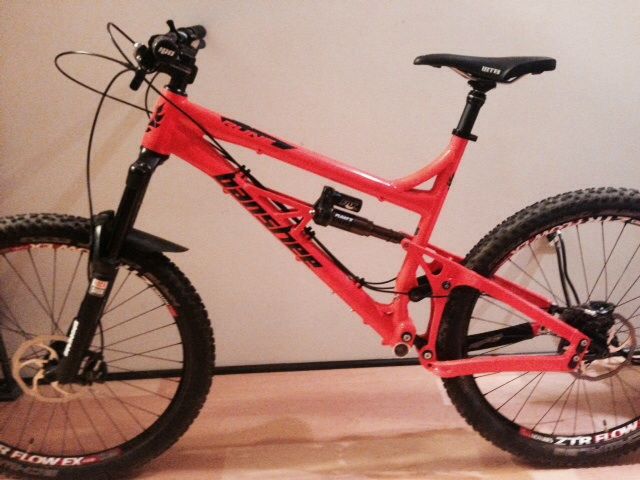

    Leong
    4 Attachment(s)
    Just to share my new rune :D
    No photoshop, the blazing decals are custom reflective stickers :cool:
    Attachment 918370Attachment 918371Attachment 918373Attachment 918374
    :thumbsup:

    Leong
    Sorry, just adding a closeup look :p
    Attachment 918387
    Attachment 918388
    :rolleyes: makes your night rides a lil more interesting eh~

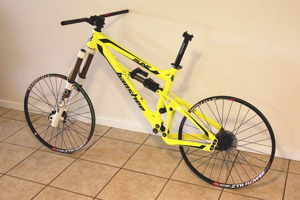

    mik8yu
    Banshee Rune V2 Build Thread
    I weight 125 all kitted up. Wanted to replace my crankbros iodine 3. Can't decide if to build wheelset with mavic 823 rims and Chris king hub. Or get the industry nine enduro. I wanted black and gold combination.
    The only reservation I hv with Chris king is that it's gonna be heavier.
    The other option is project 321 hub with spank spike wheels.
    I am light I think I could get by with wheelset that aren't that sturdily built.
    Any thoughts is appreciated. I am on a rune

    darkslide18
    Save your money and get a set of Stans ZTR Flow's laced to some Hope Pro 2 Evo's. An 823 is a lot of wheel to be pedaling around especially if you mean to do any climbing. The flow uses Rim tape but I had a set for 4 years and only taped them up once with Gorilla tape and never had any leaking issues for 4 years.
  • 08-29-2014
    Fix the Spade
    Which e13 would u prefer? I aim for the 8 series coz I wanted to run tubeless instead of having rim tapes and that it's tog has heck. Friends keep complaining their 521 keeps leaking air after each ride.
    I only have experience with the TRS+ rim, but they all need rim tape, so that more or less rules them out for you, although at 23mm internal they'll fit Pro Cores when it comes out.
  • 08-29-2014
    mik8yu
    Thank you guys. Getting the ztr flow. Now trying to make up my damn mind re: nipple color... Alternating black and gold or 4 gold then black then gold etc. ideally this is gonna last me a Long while. But u know this never happens

    3 Attachment(s)
    This is it... finally done:
    Frame Banshee Bikes Rune 2015 Large
    Rear Shock Rock Shox Monarch Plus RC3 Debonair
    Fork Rock Shox Pike RCT3 160mm Solo Air
    Headset Cane Creek 40 Series
    Handlebar Truvativ Blackbox Steve Smith
    Stem Truvativ Holzfeller 50mm
    Grips SRAM Locking Grip DH
    Brakes Other SRAM Guide RSC 200mm / 180mm
    Brake Levers Other SRAM Guide RSC
    Shifters SRAM X01
    Rear Derailleur SRAM X01
    Cranks SRAM X01 170mm
    Chainrings / Sprocket SRAM X01 32t
    Bottom Bracket Truvativ GXP
    Chain SRAM XX1
    Cassette / Rear Cog SRAM X1
    Pedals Other Mavic Crossroc XL
    Front Rim Stan's NoTubes Flow EX 650b
    Rear Rim Stan's NoTubes Flow EX 650b
    Hubs SRAM X0 142X12mm X9 100X15mm
    Spokes Other Pillar 2.0
    Front Tire Other Mavic Crossmax Quest 650b 2.4
    Rear Tire Other Mavic Crossmax Quest 650b 2.4
    Saddle WTB Devo
    Seatpost RockShox Reverb Stealth
    Seatpost Clamp Other Banshee
    Weight 14,7kg
    Attachment 924132Attachment 924133Attachment 924134
