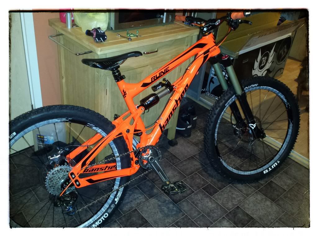

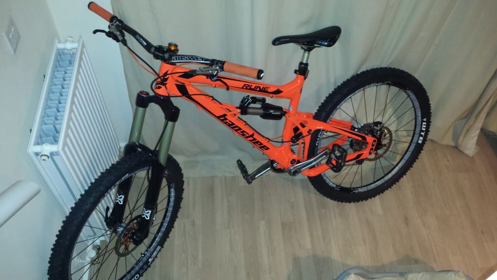

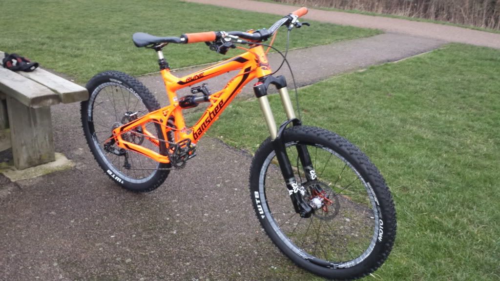

  • 01-22-2014
    supermikegb
    My new rune I built up last night
  • 01-22-2014
    supermikegb
    Weight is
    14kg or 30.8lbs not bad for a big coil fork :)
    Build spec:
    Xfusion vengeance coil fork 170mm
    Xtr trail brakes with uberbike floating rotors
    Sram X0 shifter/rear mech
    Sram xx 1099 cassette
    Kcnc light chain
    Raceface narrow wide 32tooth chainring,
    raceface turbine sl cranks with titanium axle,
    Nukeproof proton magnesium/titanium pedals,
    Chris king bb,
    Hope integral headset,
    Thomson x4 50mm stem,
    Answer pro taper carbon bar,
    Ks lev seatpost with fizik gobi k'ium seat,
    Easton havoc am wheels on wtb moto TCS tyres
    Also spank subrosa evo 30al rims on hope pro 2 with wtb warden mud tyres
