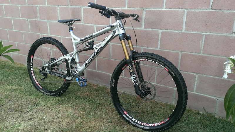

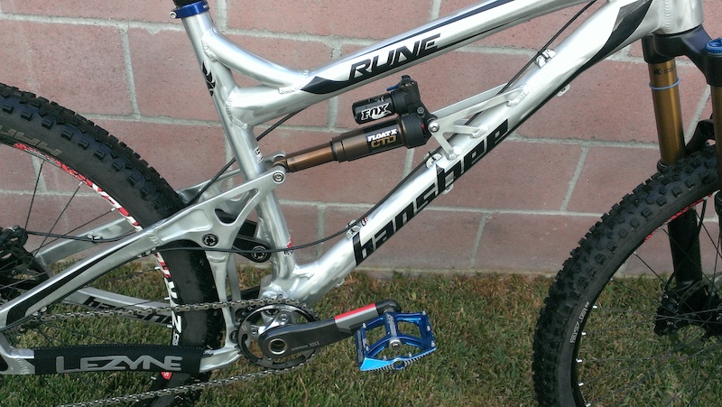

  7. #1307
    Reputation: socalMX's Avatar
    2,275
    Got rid of the Pike already, did not care for the air spring curve. Just installed a new Float-X CTD (initial feel is amazing, small bump had me thinking there was only 10psi in my tire) and a Pushed RC2 36 Float.

  12. #1312
    2,275
    Quote Originally Posted by qbert2000 View Post
    how tight is the crown clearance with the 650b on that float?
    I cycled it with no air and it is close but ok. The most I ever got from the Float is 1/4" from using full travel on a 6' to flat bottom out drop so no concerns.
    That green is smokin!

    Here is mine currently as I got rid of the Pike and upgraded the shock. The Pushed RC2 Float 36 is amazing and I am loving the new Float-X CTD, a perfect match for this frame!

  89. #1389
    2,275
    Quote Originally Posted by hjtan View Post
    heres mine after a long but worth it wait
    black on black medium frame with 26" dropouts
    Looks sweet! Could you post a side shot with better lighting!

  92. #1392
    29
    Quote Originally Posted by socalMX View Post
    I only have night shots at the moment. Hope this picture helps
