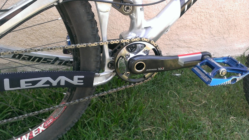

    mindmap3
    My Rune is all finsihed now and has been on a couple of rides and so far I'm really happy with it. The rear end generates a whole lot of grip compared to my SX when climbing and is great fun descending. I'll get some pics up later.
    My only issue with ot so far has been installing my chain dervice and cranks. I run an E13 LG1 Trail chain device with Atlas AM cranks and had loads of issues with the cranks / chainring bottoming out in the back plate of the chain dervice. I have filed the granny ring tabs down as much as I can and I was still getting the same issue. In the end I moved the bottom bracket spacer over from the none drive side to the drive side. This has resolved the issue but given me a not so great chainline.
    Any advice on what others have done would be appreciated. My plan in the future is to dicth the full chain device for a direct mount top guide, a thick thin chainring and a clutch mech. However in the short term, I woud like to improve my chain line.
    The issue that I can see is that the ISCG05 tabs sit right in the edge of the BB whereas the old ISCG tabs on my SX trail sat back around 2.5mm. I know that its not Banshee's fault that the industry has moved to the newer standard.

    NoStyle
    Carefully hone down the ISCG-Tabs till they are nearly flush to the Plate, which is about 2,5 - 3 mm. Done this on my Spitfire. Itīs easier to space outwards if necessary than inwards ...

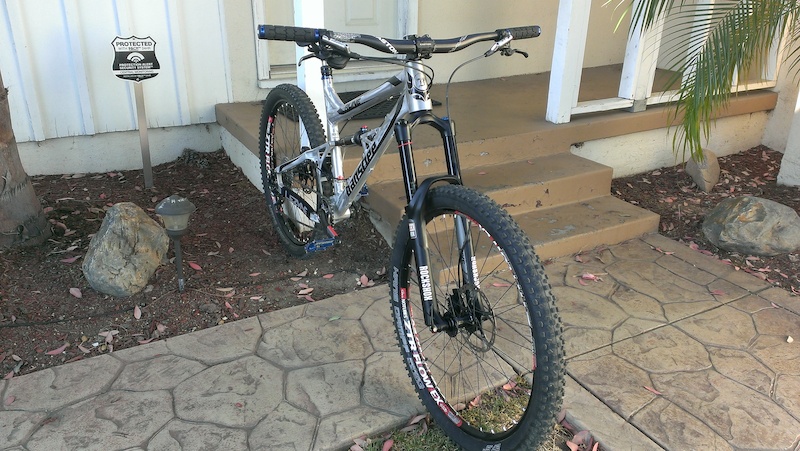

  • 06-21-2013
    mindmap3
    I thought about that but the tabs don't seem that thick and I was worried that a knock to the chain device could damage them and that my warranty would be invalidated if I filed them down.
    Here are a couple of pics of the finished bike.
    Overall I'm very happy, just need to sort out the chaining issues. The other slight snag is the rear hub; when it was run as a QR one it was mega smooth and spun for ages but since swapping it to a 142x12mm bolt through, to get rid of the play it needs nipping up quite a lot and doesn't spin as well and the bearings feel ever so slightly notchy. I'm hoping that a bit of fiddling and it'll be nice and smooth again.

    socalMX
    Have had my large Rune for under a week and loving it. Question, was at the bike park yesterday and at times there was a strange clunk like kick back on the rebound of the rear when deep in the travel. Is this normal? Running a CTD with 2x10 drive.
  • 07-27-2013
    djball
    I also experience this- thought it was chain slap/clunk on hard hits, so I installed a C guide. It's very quiet now, but there is still some kind of hard clunk/or 'pack up' on square edge impacts. It's not bottom out on the CCDBA I've watched the 'O" ring carefully. I run slightly slow rebound (high and low speed) for booters and better tracking through chunder.
  • 07-27-2013
    socalMX
    Went for a quick ride this AM and looked down while this was happening & noticed the chain retracting. Going with a type 2 clutch derailleur & single speed XX1 crankset so hoping it disappears.

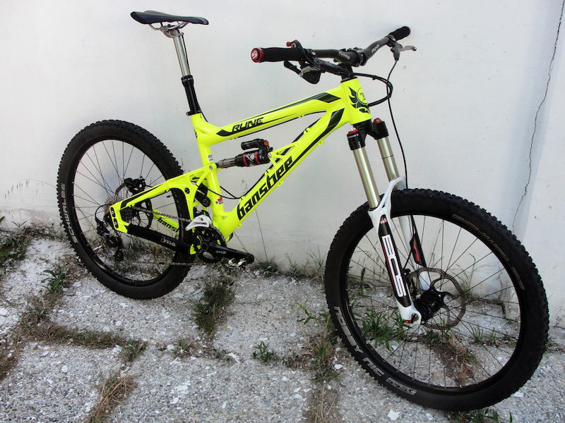

    abes
    Finally..
    After 6 months decorating a new house I finally got round to building the frame I had sat in the garage. Very happy at the moment but not had much time on it yet.
    Attachment 819908

    socalMX
    My Rune with the 160 Solo Air Pike. This fork is super light and is supposed to perform! First ride tomorrow at the Big Bear bike park.

    socalMX
    Yea man, this fork got raped as a virgin (bad analogy)...:nono:
    The fork performed well. I still have some adjusting to do but all was pretty good. I am having a hard time finding a balance with the compression and rebound. The air weight chart is just crap, they should do away with that completely. Running the suggested pressure the fork was really harsh and was at 10% sag. I took the bike down the Miracle Mile trail which is Big Bears expert trail (im no expert) and the fork was awesome in the switchback berm sections and brake dive was minimal. I will try slowing down the rebound, dropping 5lbs more air tomorrow as my local trail will be a better place to dial this fork in. The front of this bike is super lightweight, and with the short chainstays it manuals better than any bike I have had. As you can see in the pic I ran the lowest/slackest geo for todays ride (flip chips by rear dropouts) and it was a mini DH bike! Attachment 824646
    Large frame with full XT build. I swapped out the XT 2x crank for the XX1 and could not be happier, well that's until I could afford the rest of the XX1 kit. But honestly the 11-36 cassette is a great match for the 32t front. I love not having to run a guide and never having a dropped chain. The 27.5 wheel size is just awesome and the Stans wheels/hubs are really stiff, lightweight and can take a beating.
