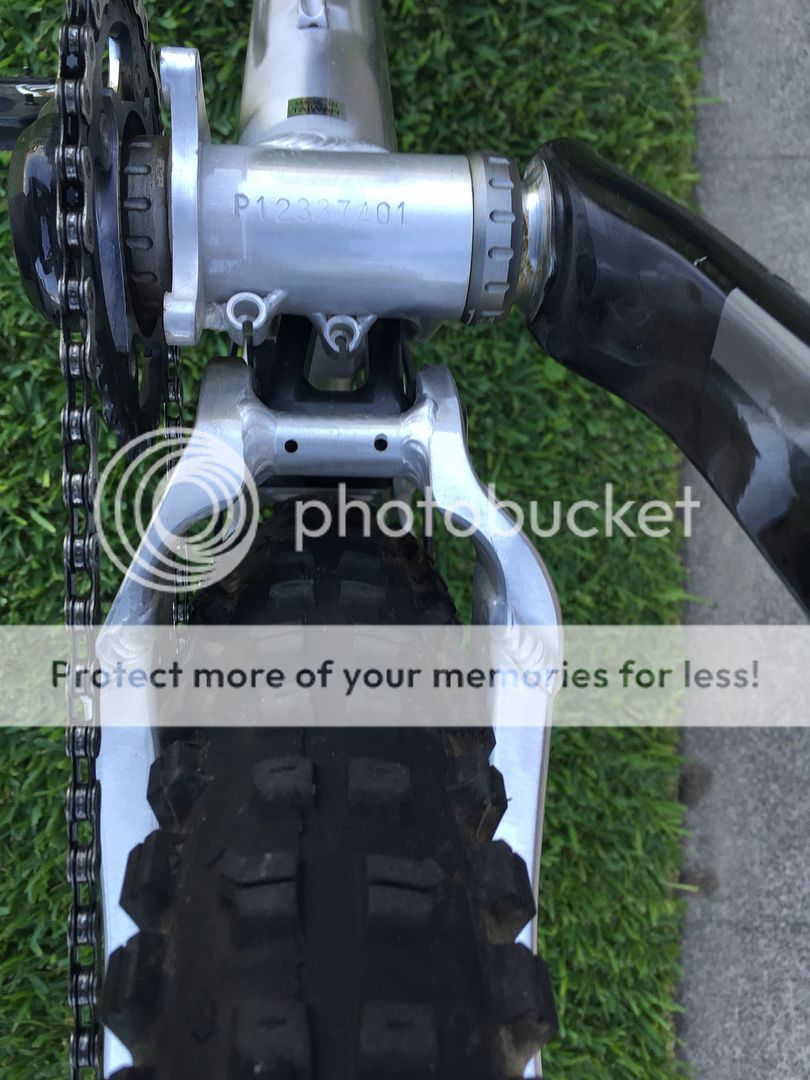

    1/2 Phat Phantom w/ 29+ tyres
    Curious to all the folks interested in these + tyres for FS as to the why? Maybe I'm missing something, but the Prime/Phantom already have fantastic suspensions, pair that with any of the available "normal" 29er rubber already available up to real 2.5" tyres and you've got an awesome machine, can't see the need or want for so much bigger. Current tyre setup, WW LT rear, 2.35" Ikon front in dry conditions and loving it, combo is very fast, but the 2.35" Ikon really does offer a lot of grip for how fast it is. Have my 2.4" Chunky Monkey for the wet or a more aggressive setup.
    I did a check this AM, and the Phantom will clear a Maxxis Chronicle with the drop outs set to the slackest position, i.e. longest chainstay length, but clearance would only be for absolutely smooth dirt trails with no debri to get caught up in the tyre, at least IMHO. Also the F34 has clearance, but wouldn't trust in on anything more than smooth dirt with no debri to get lodged between the tyre and arch.
    B+ PRIME (or Phantom). Let's talk about it.-dscn0837_web.jpgB+ PRIME (or Phantom). Let's talk about it.-dscn0831_web.jpgB+ PRIME (or Phantom). Let's talk about it.-dscn0827_web.jpgB+ PRIME (or Phantom). Let's talk about it.-dscn0834_web.jpgB+ PRIME (or Phantom). Let's talk about it.-dscn0828_web.jpg
    Thanks for the pics. Can you please revise your post to show that these are 29+ tires? Other 27+ threads have already gotten pretty confusing with random 29+ tire references and pictures.
    The parts of this set-up you didn't like could be related to the 29+ wheelsize- certainly the clearance would work with 27+ and the wheel would spin up faster. Part of the allure of 27+ is that it could be nearly a wash with 29, in terms of diameter and weight.

    I did some experimenting tonight. Took the rear wheel off of my Krampus and put it on the Phantom to see how 29+ would work.
    Surprisingly, it clears the seat stay bridge that I thought would be the problem... although it clears by like 1/2 mm or so. The tire bottoms out against the vertical struts at the front of the rear triangle though. Also has maybe a hair's width at best between the tire and the front/sides of the CS yoke.
    Having said all of this, I think that 29+ could work in the Phantom with a narrower rim (I have Nextie 50mm rims on my Krampus) and the 650b dropouts.
    So I ordered a set of the dropouts tonight. I already have 35mm Derby rims on the Phantom and I know they work fine with 29+ rubber. (I used Derby as my original Krampus wheelset before deciding to try the wider rims.) I actually just swapped out new tires on the Krampus recently, so I have a pair of Knards that I can put on the Phantom to try it out. I am running a MRP stage on both Krampus and Phantom, so I know I have the clearance I need on the front end. If all works out, I should be rolling in a week or so. I will post pics and results when I have the new dropouts.

    About that...
    Quote Originally Posted by shackleton View Post
    Nice! How does it ride? Which dropouts is that with? How much clearance is there?
    Here is what I put in the other thread.
    Quote Originally Posted by AOK View Post
    For those of you not following the B+ Phantom thread... Here is my 29+ Phantom.
    No ride time yet - it is snow/sleet/raining here so it will probably be a few days at best before I get on a trail. No idea if I will like the setup or not. (Although I really like my Krampus.)
    It was a fairly modest investment - I just picked up a set of the 650B dropouts and was good to go.
    Already had the Derby 35mm rims on the Phantom, and I just pulled the Knards off of my Krampus recently since I got different tires for it. For now I will probably just use my Krampus front wheel (as shown) unless I decide to keep the Phantom as 29+ longer term.
    Clearance is good in the front of the tire on the yoke and seat stay bridge. The chain stays are tight around the sidewalls, but still 4-5mm clearance. I actually was able to fit my Krampus rear wheel (50mm rim + Chupacabra tire) in there but it was REALLY tight on the chain stay clearance. Like 1mm or so. As Keith stated in the B+ thread, the 650B dropouts add about 10mm to the chain stay length. I measured before and after and got exactly 10mm difference.
    As stated above no real ride time yet. I ripped around the backyard a little and it seemed ok. Plusher than the Phantom normally feels due to the extra cush in the tires. Bike feels taller (duh) when you throw a leg over it but it didn't seem too different once I started riding around. I am guessing that BB height is somewhere between 0.25 - 0.5" higher (forgot to measure). We will see how it does when I get on real trails with tighter corners.
    The rear felt a little squirmy - I will probably have to add just a touch more pressure. I was at ~12 psi which is what I usually run on the Krampus. This is also partially due to the Knard. If I keep this setup long term I will probably switch to a Chupacabra for the rear tire.

    As AOK said, when I gave it a whirl with just the normal drop outs in the slack position on my i25 wheelset, to me it felt a bit too "squishy", like overkill, toolin around on the drive, but am curious to try it with the 650B drop outs and Dually45 wheels (just waiting on another Dually rim).
    Pics below showing clearance with normal 150mm drop outs in slack position.

    Been riding Dirt Wizard 29+ on my Prime with the 650b dropouts, really like these larger tires, wish they would fit on my other long travel 29ers.
    I might try to pick up a used phantom and run 29+ on it too.
    So far, I'm not interested in running any other 29+ tire (like the Dirt Wizards tread).
    So far, I've ridden them on my usual trails but also at the Bike park (no big jumps or big drops; I've only ridden the DW+ at the Bike park).
    I have two sets of wide carbon rims (941's and Roval Fatties)...the 941's with DHF 2.5's mounted and the Fatties with DW 29+...I will eventually be riding them back to back, I expect to like the DW 29+ more.
    I'm not sure how low of pressure I can run (I weigh about 250 suited up), so I will eventually use Procore to help protect my rims from rock strikes regardless of which tire I run.

    I fit my Prime with 29+ tires on 35mm external/30 mm internal rims light bicycle rims. I tried a Chronicle in the rear, which rubbed under suspension compression, and a Dirt Wizard that fits with no problems. However, I currently switched the rear to a Minion DHF 2.5 for something with a burlier casing.

    I'm running 29+ Dirt Wizards on my Prime...
    You have to purchase the 650b dropouts to get enough clearance in the rear...those dropouts move the rear axle back about 10 mm on the Prime/Phantom.
    Banshee V2 142mm 650B Drop Outs > Components > Frames > Frame Parts | Jenson USA

    I'm running 35 mm Fatties (I do have 941's...but with 2.5 DHFs mounted)...doesn't seem like that wide of a rim would clear...will post a pick later of my current clearance if you want to see it...not sure if the phantom width is the same.

    Didn't notice that much difference running 2.5 on 35 mm Fatties vs 41 mm (941's have more spokes and feel a bit stiffer...but I am not hard on wheels), never been on anything wider.
