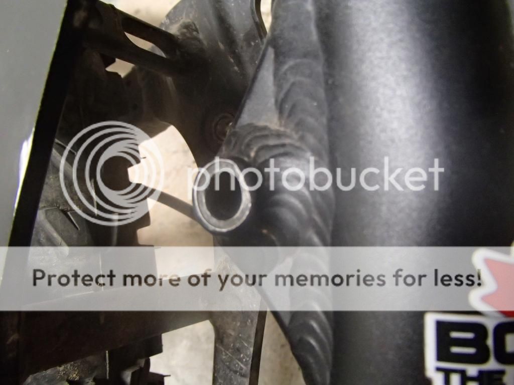

    I'll play. I'll start off saying I love riding this thing, it's an absolute blast. This is my bike, not a friends buddies or whatever. Issues started around June 2014, noticed a slight amount of play/ clunk when picking the rear of the bike up. I was out of town for work with the bike and it appeared to me that it was in the shock bushings. Rode maybe 30 miles that week, got significantly worse. Brought it home and went over it with a buddy, found that the play was coming from the upper pivot at the front triangle side. (Note-- I had just recently converted it to 1x and had pulled and locktited all the pivot bolts chasing a creak, there was no slop at that point). Tightened pivot, (by hand) and play was gone. Got it home, pulled and locktited 4mm lockscrew and torqued to 5nM. Rode bike a few weeks and it was tight, then the play came back. Checked torque on pivot, ok. Ordered new shock bushings, and picked up new bearings local. Shock bushings went easy. The upper pivot axle (bolt) took me an hour to get out and get the link separated from the frame. Nightmare. So I separated the frame and link and found this........................
    This is on the drive side. The other side looks normal and new. I emailed and have been in contact with Banshee, and they said they've never seen that and it must have been ridden loose. Personally, I think it came "loose" because the aluminum wore away. The hole in the frame is oblonged also. I'd have to think that riding it loose would have caused wear on both sides. Banshee has said they will not warranty it, and said sorry for my "inconvenience", which just pisses me off to end. I had then emailed them about crash replacement pricing on December 10th. As of January 5th I still had no response, so I emailed again and now got a response, but still no numbers.
    It took me a year and a half to give up on my 14 year old trek and buy a serious bike. Now this one is one year old and ****ed up. Not happy in the least.

    Sh!t happens dude. Sorry it happened to you, but it's hardly a pervasive issue with the Spitty.

    It seams to me you have similar issues I had on my Spitty. I've noticed some play and clunking noise in mid season and pinpoint it to the pivot points as you did. One pivot bolt took some taping to get it out when I disasembled them, but when i cleaned, greased and tightened everything was fine again. Then in month or two there was this play again and I just rinsed and repeat. Now had no problem since. Don't know what the problem is, maybe some small dierences between pivot bolt lenght and link, frame material width. I don't know, but for me the problem is gone.... for now

    Quote Originally Posted by kinserk View Post
    Currently, since I reassembled it, the play has not returned. But I know its not right regardless.

    ... The upper pivot axle (bolt) took me an hour to get out and get the link separated from the frame. Nightmare. So I separated the frame and link and found this........................
    This is on the drive side. The other side looks normal and new. I emailed and have been in contact with Banshee, and they said they've never seen that and it must have been ridden loose. Personally, I think it came "loose" because the aluminum wore away. The hole in the frame is oblonged also...
    Was the pivot shaft a loose fit in the frame? (but tight in the bearings, hence the difficulty you had in pushing it out). If the hole is ovalised as you say, then you might be getting radial slop between the pivot shaft and frame. Loctite makes a product called bearing retaining compound (609) just for this purpose. You can use it to effectively glue your pivot shaft into the frame.
    Ironhorse Sundays had a similar problem with play between pivot shafts and links, and the 609 worked well in fixing it on my Sunday. I also used it with good results in a sloppy bearing bore on a Turner DHR.
