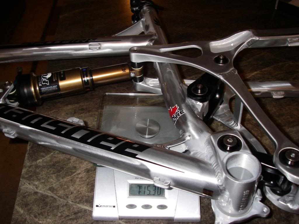

    Anyone have an actual frame weight on a medium? Also did the 14s actually go down in weight any?

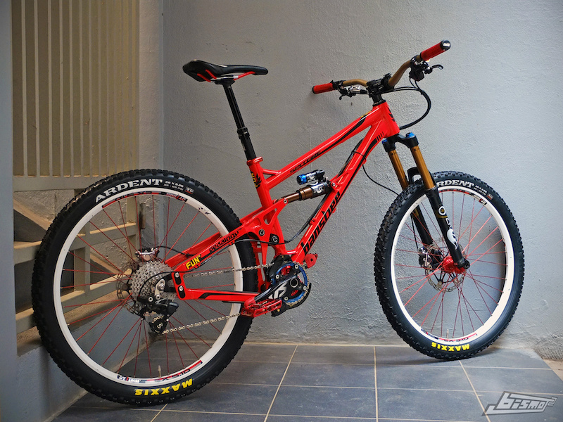

    Hello, I'm new here. I love all the Banshee talk and photos. Here' mine.
    Depending on my setup (still dialing it in) these are its specs:
    2013 Banshee Spitfire medium 650b with 650b dropouts
    Fox suspension 32float140/ctd
    Industry Nine Torch Trail 27.5 24h wheel set
    Maxxis High Roller II 27.5x2.3
    RaceFace Sixc 31.8 Handlebar
    RaceFace Turbine 60mm stem/Straitline SSc 35mm stem
    Shimano XTR M985 Race brakes w/ 160mm f/r ice tech
    RaceFace Next SL 170mm cranks
    RaceFace 32t or 34t NarrowWide chainrings setup 1x10
    Shimano Saint M820 rear derraileur
    Shimano XTR M980 shifter
    Shimano XTR chain
    Shimano XT 11-34 cassette
    CrankBros. Mallet DH pedals
    KS LEV 125 dropper post with Crank Bros. remote
    SDG Falcon Ti saddle
    SDG i-beam seatpost
    SDG Belair i-beam saddleODI Ruffian Grips
    CaneCreek 40 headset
    MRP G3 mini chainguide
    Bionicon C-Guide
    Cheers!

    Lovely bike and scenery mate everyone knows reds the fastest;D
