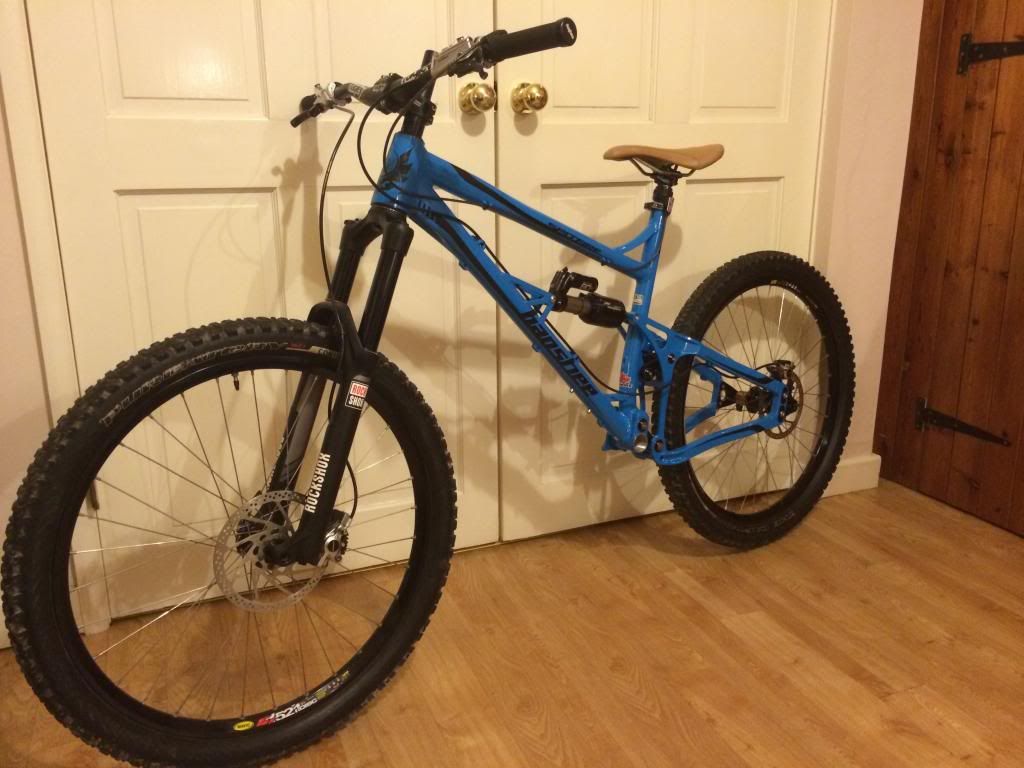

  • 11-27-2013

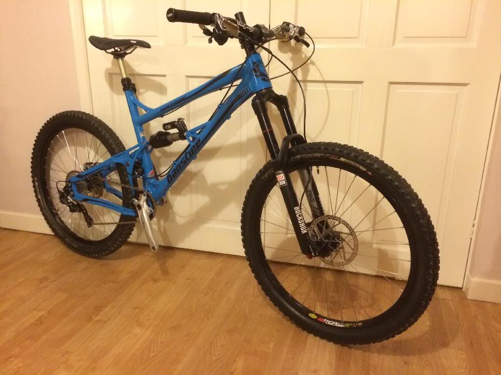

    _mmel_
    Hello All
    Been a long time lurker here on this forum and thought it was about time I contributed.
    Been waiting for my Spitfire frame for quite some time so was pretty excited to pick it up on Monday. I've started the build but I'm waiting for a few drive train bits to arrive before I can finish her off.
    One thing some of you may be interested in is that for the time being I'm going to be running my new 650b Pikes with my old 26 inch wheels. As you can see they just look normal, albeit with good clearance. A2C is the same as 160mm Fox 34's give or take.
    The brown saddle is just for testing, I'm waiting for a black and blue Charge Scoop :cool:

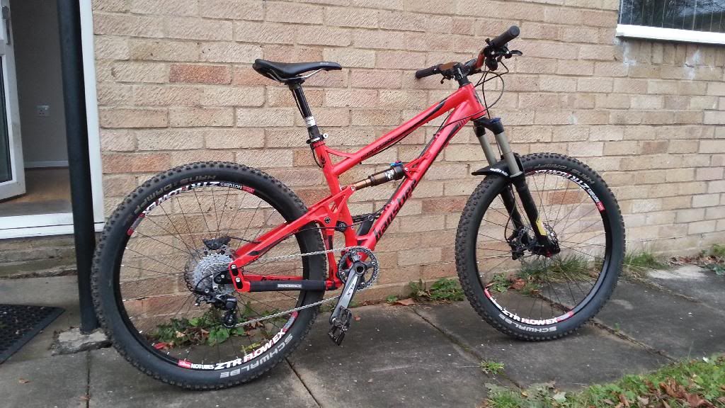

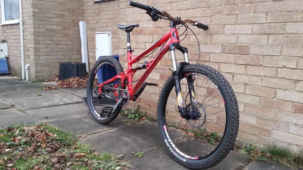

    supercow
    Seems I was being a a whinger - with some careful consideration to the spec, without actually going all weight weenie, she's come in at a very respectable weight.
    Really awful pics since I'm pulling in some shitty long days at work and only have a little bit of time at night to build it.
    I did forget to put the front rotor on in that weight pic, so I hung it on as well - and it came to 29.23 lbs :)

  • 11-28-2013
    supercow
    Originally Posted by hssp View Post
    HOW? Mine is 30.43 lbs with 26" carbon rims, XTR pedals, XX1 and DBAir. I cannot go more WW on this without going for no dropper and silly brakes and disks.
    Medium Anodised frame (is your's painted?)
    BOS Deville forks
    Reverb
    CCDBair CS
    Formula R1 brakes, 180mm rotors
    Spank Oozy 26AL EVO (27.5") with Nobby Nic and Hans Dampf combo
    Thompson Elite stem (50mm)
    Production Priveé LG bars (being replaced by Raceface Sixc bars when they show up)
    Raceface N/W ring
    SDG - Falcon Ti-Alloy Rail Saddle
    XTR shifter
    Zee mech
    XX casette
    Truvativ X.0 DH cranks (165mm)
    Hope Headset
    Raceface grips
    Superstar Mag CNC Pedals
    KMC SL 10 chain
    So my major parts are light, but can be a tad lighter.
    The wheels are surprisingly light for such burly wheels, but my brakes are super light. The little bits then count - pedals are fractionally lighter etc.

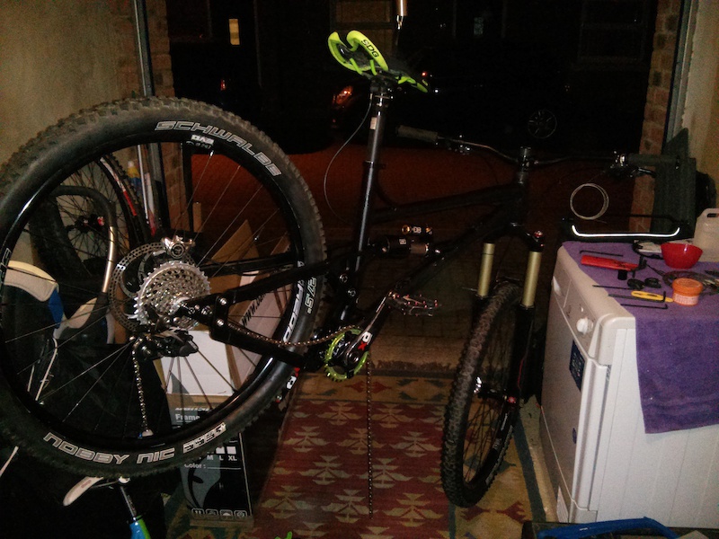

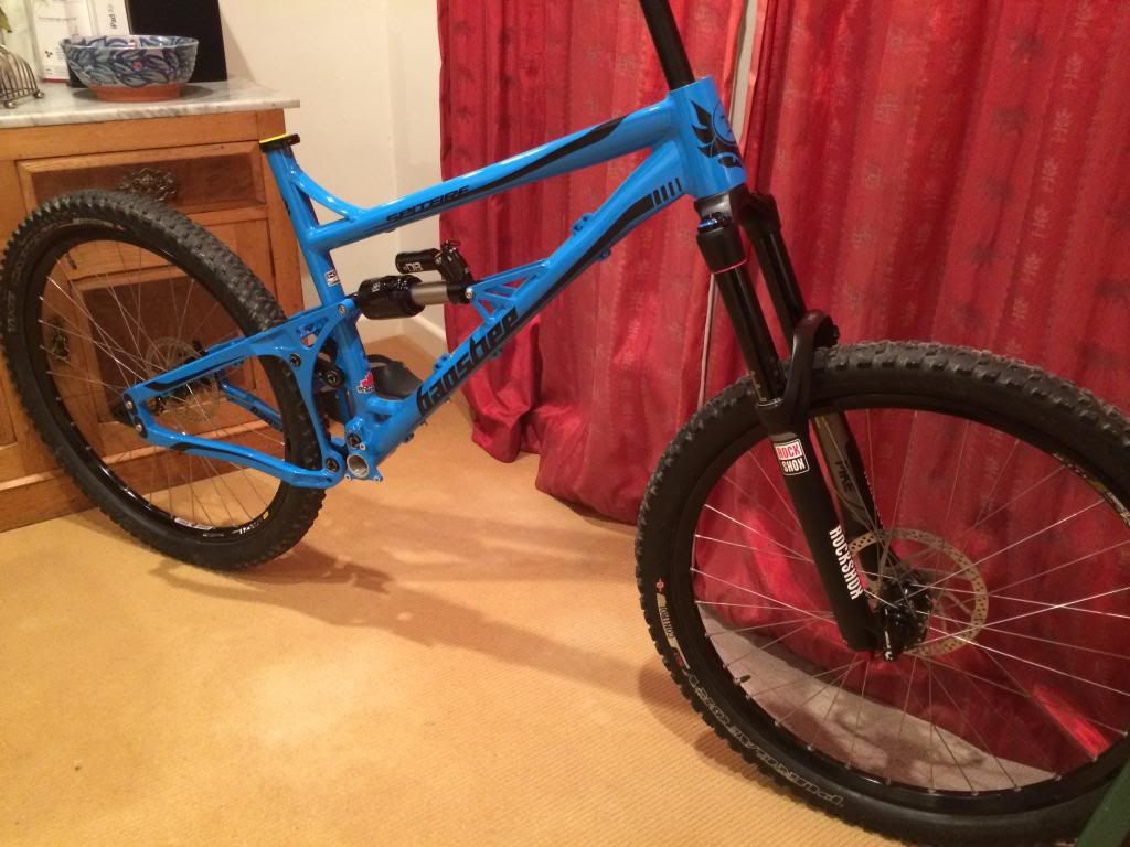

  • 11-29-2013
    _mmel_
    Another pic from me showing last nights progress
    All is pretty much good to go apart from one important job that I'm not looking forward to! Measure once cut twice isn't it.....
    Not too bothered how much it weighs but it feels "solid"
  • 11-29-2013
    _mmel_
    Done, measured twice, then once more. Marked with tape and set to work with the hack saw.... Seems to of done the job. Just got to decide where to go on my shake down ride tomorrow...

    Ucio
    Attachment 853500
    Halfway through :)

    So I finally picked up the frame and built it up.
    It's a keeper.
    Spitfire3 by 85evan, on Flickr
    Spitfire1 by 85evan, on Flickr
    Frame - 2014 Banshee spitfire, Large, Stealth Black, 140mm
    Rear shock - 2014 Fox Float CTD, Kashima
    Front shock/fork - 2012 Rock Shox Revelation RLT, Dual Air, 150mm
    Handlebars - 2014 Race Face Sixc Carbon, 760mm
    Stem - 2014 Kore Repute, 35mm
    Headset - Banshee zero stack
    Grips - ODI Ruffian lockon
    Saddle - Specialized Phenom
    Seatpost - Thomson Elite
    Front brake - Saint
    Rear brake - Saint
    Cranks - Truvativ Descendant
    Chainguide - E13 SS+
    Chain - Sram 1091 hollowpin
    Pedals - Po1nt Racing Podium
    Front derailleur - N/A
    Rear derailleur - Sram X0 short
    Front shifter - N/A
    Rear shifter - Sram X0 10spd
    Cassette - XT 11-36
    Front hub - Shimano XT 15mm
    Rear hub - Hadley
    Front rim - Syncros DS28
    Rear rim - Syncros DS28
    Spokes - DT Swiss Competition
    Nipples - DT Swiss Prolock
    Tyres - F: Conti Trail king 2.4 R: Schwalbe Nobby Nick 2.2
    Tubes - XC
    Total weight - Currently 13.9KG

    fingerbanger
    Here's my new frame at last! A 2014 blue XL spitfire. This is as far as I got with the build today, a fair amount of time was spent just heli taping:
    Db air cs, 160 lyrik dual air, hope tech m4, DT swiss on hope pro 2, reverb 125mm, slx 33 x 11/36, hope top only chain guide, hope headset, Kore repute 50mm stem, east on haven bars (711), crap tyres, zee clutch mech
    I've a quick ride down the driveway and as expected the stack height is very low so I needed to find some bodgey spacers lying round the garage. I thought my steerer was really short at about 190mm but there was loads rising out the headtube. Ill have to get some high rise bars so will prob get some Kore mega at 38mm rise or nukeproof warhead. I've also lost my hope lever clamp on the rear brake so I've had to cable tie that until I can get hold of another or just use a spare avid. Loads of my gear is lost as just moving house.
    I'll get the cables and gearing sorted on Saturday morning and them get riding. Probably in a time trial body position due to the low stack!
