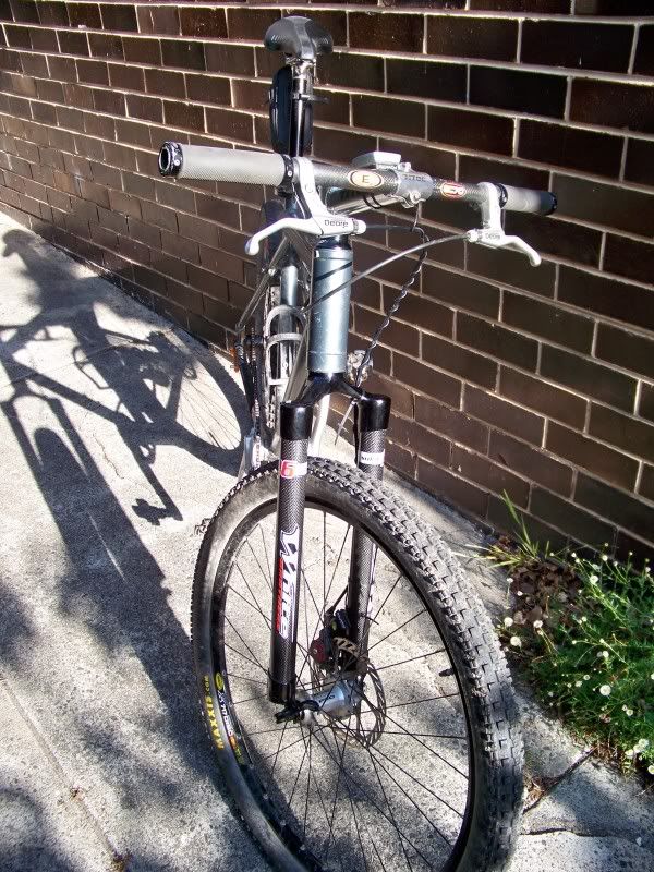

    Can anyone recommend a rigid fork for my commuter/all purpose bike? It spends most of its time on sealed surfaces, but occasionally gets dirty.
    I liked the look of the on-one cromo fork until postage came to 30.
    Keen for it to be suspension corrected for 100mm travel if possible and weight isn't a huge issue.
    Something like the Surley Instigator looks about right, but i would prefer something that looks like the on-one fork if at all possible.
    Am I overlooking anything? If not i'll probably just grab one of the Surley forks. With free postage from wiggle it looks like a good deal

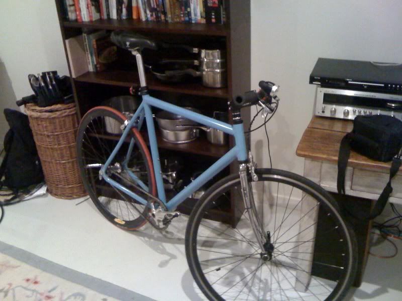

    This is how it looks now. It has a 660mm bar on it which sets it apart from most in the city
    Considering getting a cheap fork and building up the spare mtb frame SS now though. I had forgotten how much i like them... this is great, but i miss being able to jump off everything and ride down stairs etc. It is actually helpful when riding through the city every day...
    I have the frame, brakes and a nice set of wheels already. Tempted

    G'day al_,
    Like the look of ya' bike.
    Looks race ready (almost) for the cyclocross season next year

    Nice bike Al !

    Been back on this for a week now and have used it a fair bit.
    Single speed is definately the way to go for a commuter. I'm really happy with it. At 8kgs it is relatively light and cruises along nicely.
    I was running about 72 or 73 inches fixed before, but had to go up to a 16t freewheel to get the right thread size which has dropped it down to under 65 inches now. I thought it would be stupidly spinny, but i like it more. I rarely want to go over 27-28kph on the flat, and this gets there nicely.
    I don't usually store cooking stuff on the bookshelf either, but i'm struggling for cupboard space...

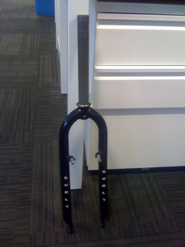

    I won this a couple of weeks ago and it just arrived.
    $80 with a new Cane Creek headset seemed reasonable, and it is in great condition. Most importantly it has an uncut steerer which i need as the headtube is long.
    It will take a massive front tyre which is good (i like the idea of riding on sand...), and will save heaps of weight. Also changing to 1x9 to distinguish the bike from my main one.
    I would have rather a 100mm suspension corrected fork, but this makes more sense.
    Thanks for the help!
