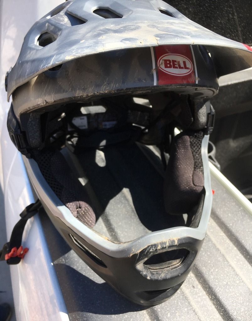

    I had a pretty good get off in my Super 2R a few weeks ago and the chin bar held up well

    Mar 2017
    20
    Quote Originally Posted by vegasR6 View Post
    Hey did you take the chin bar off and check both bits for cracks?
    Oct 2015
    104
    I did not. where do you suggest looking?
    Mar 2017
    20
    Around the two side clips but id give it a good look over.
