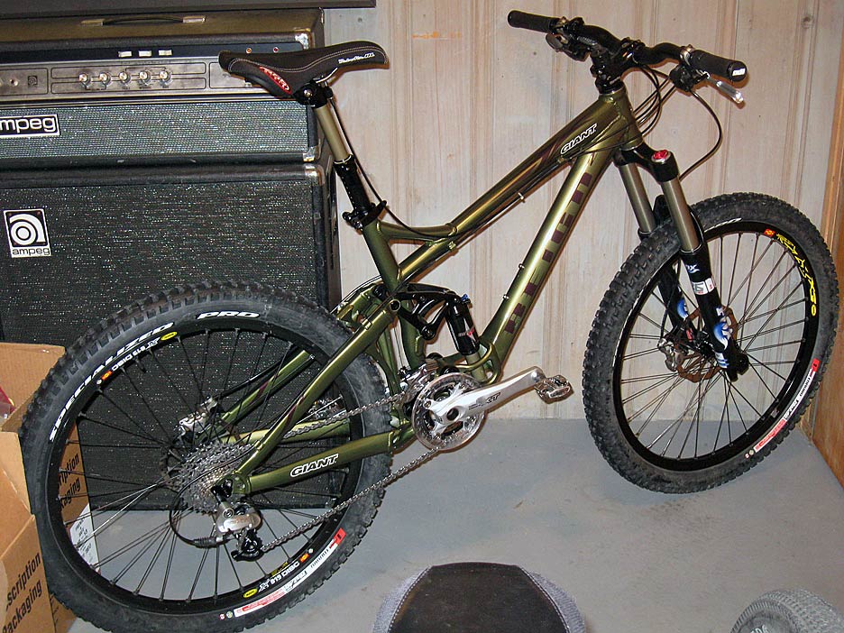

    Really? This looks, that bad?
    I love my Command Post, and the remote is what makes it great!

    Quote Originally Posted by deoreo
    A lot of bike don't have cable guide on the top tube though.

    Quote Originally Posted by Neily03
    Ok, my old 2005 Reign didn't have cable guides, again, really that bad?
    And the CP offers up so much riding "win" I'll gladly suffer a zip tie or two...lol.
    What happens when you pick up the bike, cables grinding on your frame... or your shoulder.
