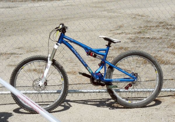

    I did an image search for Mach 5 and came across this. It was a Mach 5 that was used by Kyle Strait a few years back at Sea Otter for dual slalom. Looks like a small.
    Here is how mine is set up at the moment.

    That bottom bracket seems excessively high. I would bet that short shocking that would make it feel a heck of a lot better.
    Reputation: charging_rhinos's Avatar
    1,839
    Yeah, if it has the reported 13.5ish" bb height, that would most likely be the culprit. The Mojo series from Ibis feels the same to me. Like I'm on top of it, rather than in it.

    Quote Originally Posted by honns View Post
    I did see some offset bolts on Ebay. So by installing that bolt will lower the bottom bracket...and it also slackens the head tube?
    Offset Shock Bushings Mounting Hardware Mount Kit All Frames Proshox | eBay

    An offset shock bushing will lower the BB a bit, but it will change your head/seat angles more; you'll move your weight even further rearward. That isn't what you want. (although it could be compensated for by lowering your fork)
    Slamming your saddle forward on the rails might help, depending on how much you rely on saddle position to dictate your attack position, but it will also shorten your cockpit. Since you've already shortened your cockpit about 2-3 sizes with the stem, it's going to be pretty compromised too since you won't have much room to move around and still be inside the wheels.
    Lowering the bars will help (via flat bars if necessary), but it can feel pretty bad when the trail gets really steep.
    Mach5's are really really fantastic bikes for doing techy XC rides in rough desert environments. It's a long travel trail bike. The further you get from that mission the more sense it makes to give up trying to make it fit the role and get a frame that suits what you're actually doing.
