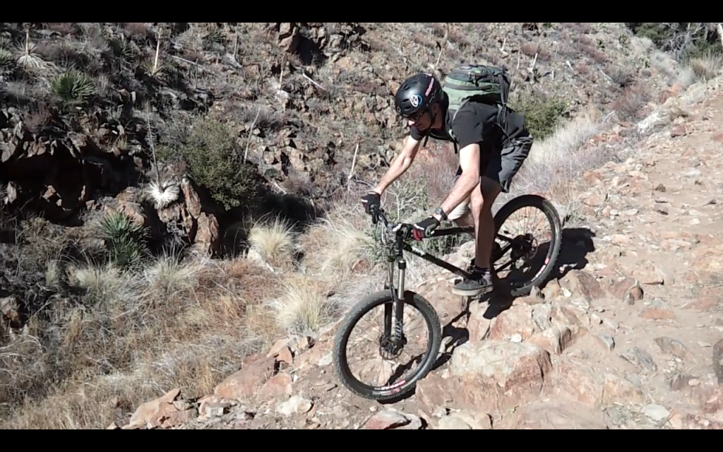

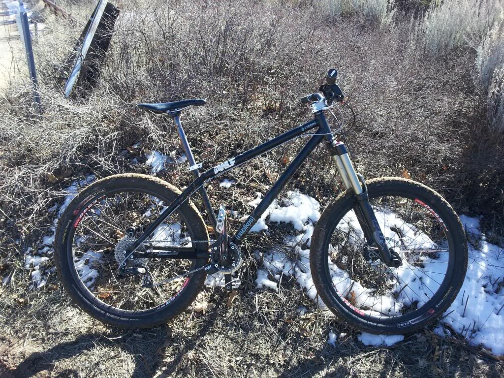

    I saw this thread earlier and I wanted to comment, but i really hadn't ridden my surge enough to get a true feel for it on trails, but today i went on a good ride with it and I was quite impressed, so I figured I'd give you a small review. Let me know if you have any questions cause I realize this review is not too in depth.
    I rode it through Noble Canyon which offers the most diverse riding on a single trail in socal. Its about 14 miles if you shuttle it, but about a third is spent climbing. At the top there is normally smooth fast single track with some short climbs that are steep and rocky, but it was covered in snow and fresh mud. I was riding slow because my tires were not too fond of the conditions. After this section, the trail drops into a forested area with twisty singletrack with a some tight switchbacks. Now that I had traction, I was able to go pretty fast and get a feel for the bike at speed. After this section, you plunge into a super technical rocky section filled with chaparral that carries on for a bit. This leads to a deserty area that has even gnarlier rock gardens both uphill and downhill as well as a section of trail that's so gnar that its called "stairway to hell". This is followed with a long sandy climb up over a saddle that isn't too technical. After that is a flowy, bermy, jumpy section that leads to a long rock crawl through "the chunks".
    So as you can see I dealt with many different conditions today and I really tested the bike as a trail bike. It performed admirably while climbing, descending and tackling technical terrain and rocks. It rode so smoothly over the rough stuff that I barely missed the 6" of squish out back that I'm accustomed to. It accelerates real good and getting the front end up and throwing the bike around is effortless. I honestly haven't bothered with the sliding dropouts. I just set it up totally slammed and it feels great. I am 6'4" 170lbs and the Large feels long enough for me, alls you need is a long seatpost to account for the short seat tube.The geometry is spot on with a 160mm fork too! Seriously the most fun bike I have ever owned or ridden.
    This bike can also be ridden as a freeride bike, but honestly I haven't jumped it too much and I haven't done a drop bigger than 4 feet on it so I can't say for sure, but It feels like you could go pretty big on it. I'm dying to head out to the local freeride spot and hit some drops and some dirt jumps to get a feel for all that.
    In summary it is playful, fun and you can do almost everything on it. I even commute on it!
    The only complaints I have are that it uses a 1 1/8 head set and 27.2 post which makes it difficult to find forks and dropper posts.
    Also i suppose the cable routing is not super secure on the top tube which results in a clanging sound which may bother some, but can be easily remedied.
    Here are the build specs:
    Frame: 2012 NS Surge (L)
    Fork / Headset: Fox 36 Float R 160mm / Chris King
    Handlebars / Stem: Answer Protaper 720 AM 2" / Sunline V1 AM 50mm
    Saddle / Seatpost: Nashbar GR2 / Nth degree 400mm
    Brakes / Brake Rotors: Magura Louise BAT / 160mm AVID HS rotors (bigger ones on the way)
    Cranks / BB: Raceface Evolve XC with 32t ring / Shimano
    Chain Guide / Chainstay Guard: MRP G2 / Lizard Skins
    Rear Derailleur / Shifter: SRAM X7 Short Cage / SRAM X7
    Cassette / Chain: Shimano HG61 12-36 9 speed / Shimano HG93
    Pedals / Grips: Wellgo MG-1 / ODI Rogue
    Rims / Hubs: DT Swiss E540 / Formula
    Tires: WTB Weirwolf LT 2.55
