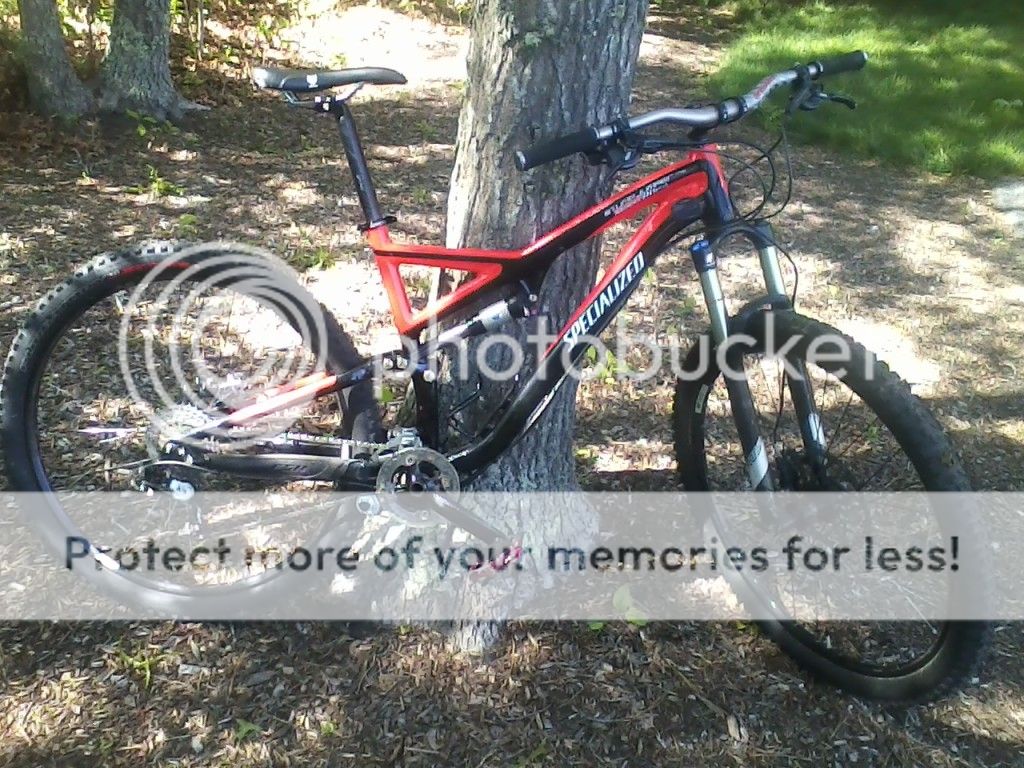

    I'm pretty happy with my MRP 2x on my Nomad. I have posted about it before, but I had to do some modifying to the backplate and BB spacing, but as other have pointed out this is due to the frame, and your overall set-up, not inherant with the guide.
    The ONLY actual thing I dont like about the guide its self is after almost every ride I get tiny pebbles (think slightly larger than grains of sand) that lodge themselves between the pulley wheels and either side of the pulley mount plate and it inhibits the smooth rolling of the pulley wheels. I notice this happen on the trail as the guide gets a lot louder when pedaling. Its such a weird thing. So I have to pull the pulley plate off and clean it after every ride basically.
    Ive been using single speed taco guides on my DH bikes for years and that never happens there.
