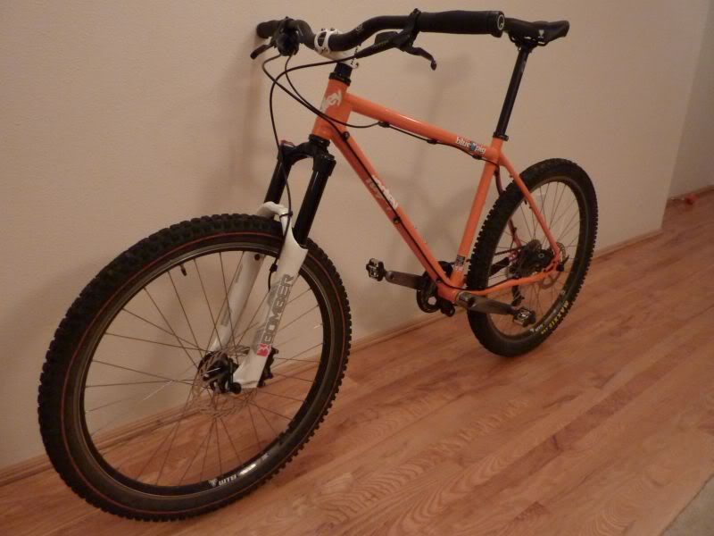

    Well, hell, I drank some kool-aid. Looking for an interesting new build and decided to give a longer-travel hardtail a go. Sold my SS 29er, which wasn't being ridden. This new bike will be a backup/fun bike to my go-to rig, a Titus El Guapo.
    I ride pretty technical, rocky Arizona trails, so I'm not 100% sold on the hardtail idea, but thought I'd give it a try.
    Frame showed up from CRC in just less than two weeks total, so no complaints there. Had to jump through some delivery hoops, but that's a USPS thing. There was absolutely no padding/packaging in the box, just a frame and a sticker pack. I'm astounded that the frame didn't get hashed during the trans-Atlantic trip, but it appears nearly perfect. The paint is thin around the head tube and there's a paint bubble on the top tube, but that's it. No real complaints in that regard; two weeks of riding in the rocks here and it's going to look like crap anyway.
    Otherwise, the paint is nice, the welds are clean and I really like the do-it-yourself sticker pack; wish more manufacturers did that. For reference, I'm 6'2" and about 190; the frame is an 18. It does looks a little small, but it's pretty hard to tell unbuilt.
    Photos:
    I decided to go all new on this build to save from dinking around trying to piecemeal parts from here and there. The build will be:
    Manitou Minute Elite 140
    Cane Creek S3
    Transition Temple stem 50mm
    Deity Dirty30 bars
    Avid Elixir R 185/185
    Kind Shock I7 adjustable with Chromag seat
    Transition Revolution 32s tubeless with Minion and Ignitor
    Truvativ 1x9 drivetrain with E13 Freehucker guide
    SRAM X9 shifter/rear der.
    Deity Decoy flats and various Hope bits (clamp, spacers, etc.)
    Just awaiting the last of my parts and will start building next week.

    got her finished this evening after a christmas party
    18" frame, 50 mm 0* stem, marz 44 tst2 air 140 mm fork
    hoses are a little long as they came off of a 19" FS frame, oh well. took a few sprints down the 'hood and bike feels good, can't wait to hit some trails! how's it coming along, blatant?

    Build mostly complete:
    A box, a frame, a dream ...
    Just riding around the block, it doesn't feel too small at all. Plenty of seatpost, knees not hitting bars, etc.

    Dude that cockpit looks freakin tiny. And holy crap thats a lot of spacers under that stem
    No Clue Crew
    Apr 2005
    5,699
    OK. Thanks for the input. It's fewer spacers than on my El Guapo and the front of the Ragley is still lower. Guess I'll keep setting 'em up the way I like 'em.
    Reputation: Yody's Avatar
    3,175
    Its not the setup, its the size of the frame, of course you need all those spacers, the head tube is too short because you're 6'2" on a size 18" bike. You might "like em" better if they fit you correctly, just because you don't "hit your knees on the bars" does not mean it fits. But besides the clown bike sizing, I like the way you set it up and the white wheels and fork looks sick.
    No Clue Crew
    Apr 2005
    5,699
    Again, thanks for the lesson, though I missed the part where I asked for your sizing opinion.
    I get it, you think the frame is too small. Understood. Please carry on with your life.
    For reference, the head tube is on the Ragley is 2mm shorter than on my size L Titus El Guapo. The static (unsagged) top tube length is about 20mm shorter.
