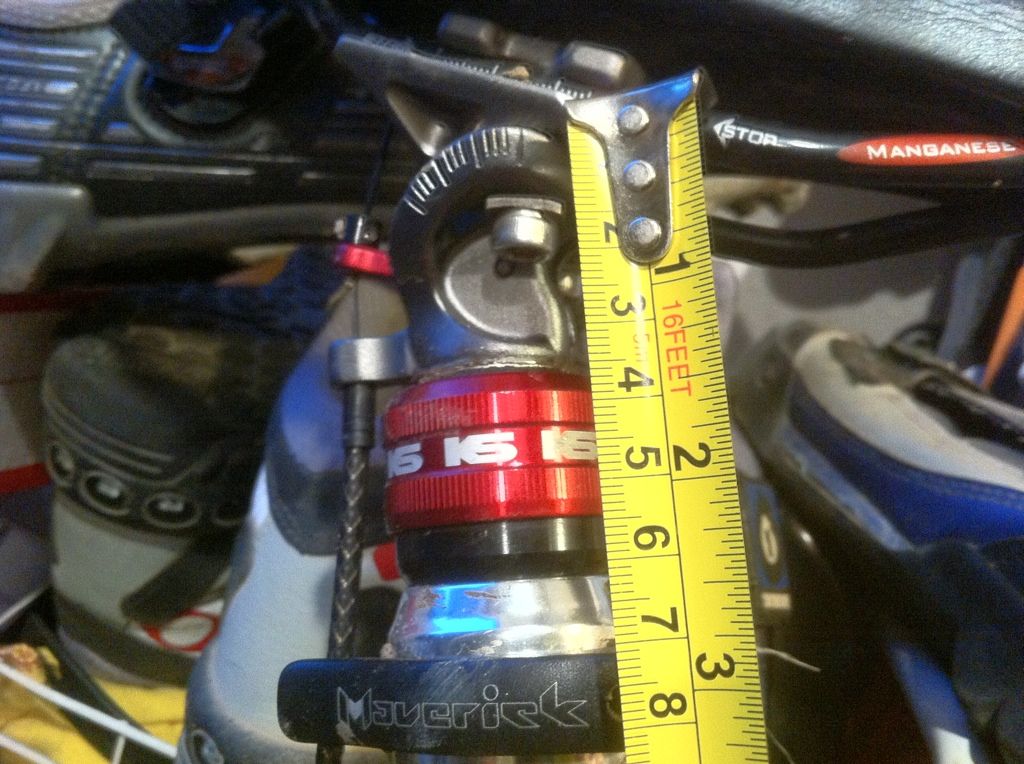

    It's the amount of insert you need. Most people don't have the issue only a few extreme end when people have to look at the number closely. It's basically the difference between the length of the bottom parts of the seatpost as the top and the stanchion are the same.
    If you have an XL bike and still required a long seatpost exposure to meet the ride height then you'd need the 385 on the other hand if you have interrupted seattube and/or need to insert fully to meet the minimum exposure of 185mm from the collar to the saddle rail.

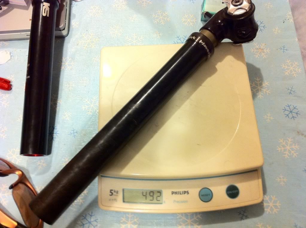

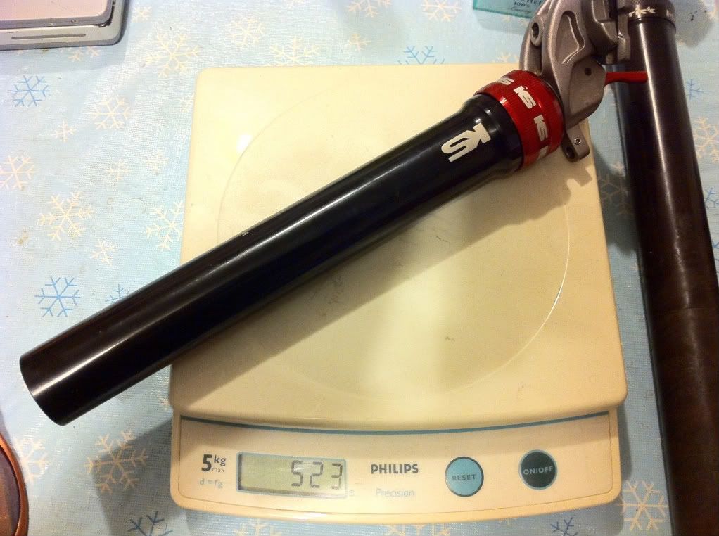

    Mech post like Gravity dropper, AMP, Spech command post are ok but you give up on the adjustment and except for the CP the ergo remote. GD and AMP remotes are long and ugly and don't fit well in some set up. They need longer throw to engage the switch. I don't like the fix positions on the adj post because the only time I want the bike to be at the right height is the climbing height. The rest of the time I want to drop 1"-4" depending on the terrain.
    The upside is they are easy to maintain you can just unscrew and clean put it back and it's ready to go. If you need parts you can just order new ones from the website.
    When it comes to performance and fit I think Hydro beats Mech hands down. The remote fits better, looks better and feel better. The post action is smooth and you can set it anywhere you want in the travel range.
    If it's going to go bad it just go and you get it fix and it's all good again. You can maintain it yourself but it's not as simple as Mech. Your op is about joplin and KS so
    Joplin has lighter action you can press the seat down while holding the remote but can't do that with KS you kinda have to put your elbow on it to get it down.
    Joplin has side to side play and when you lift the bike by the saddle when the post is down it would extend, it's just annoying. KS has none of the 2 trades.
    If you don't need the set back get the i950r it has the quick installation cable clamp, I'm not sure if the new i900r has the same style cable connect or not. Let me know if you need to know specific info or PM me, welcome to the dark side

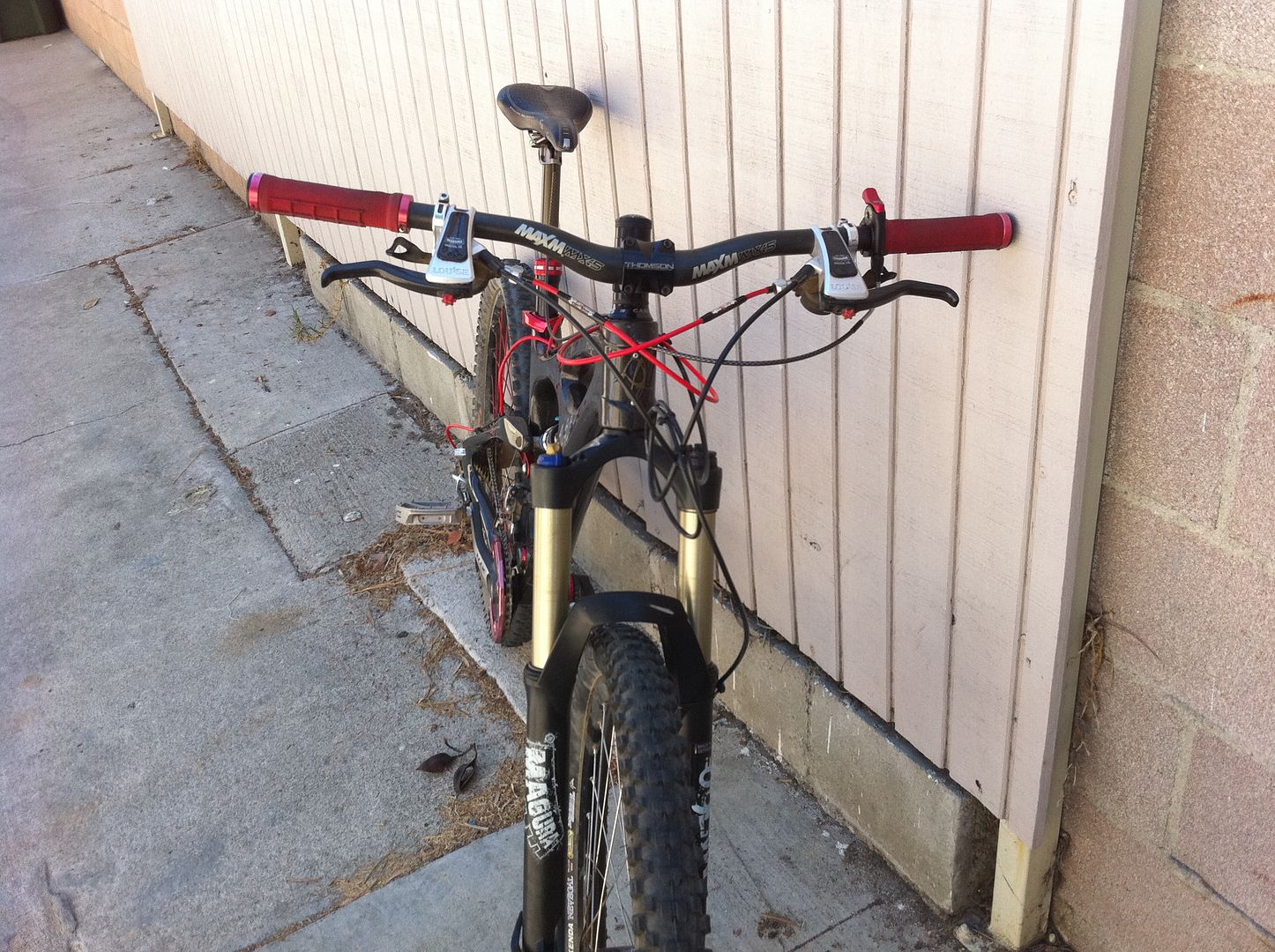

    i900r and Maverick Speedball/joplin3
    Integrated ODI lock ring remote, I just use the reg odi lock ring with remote out side

    That pic with measurements of the i900r 385mm is really nice!!!
    Anyone have similar details of the 300mm version?
