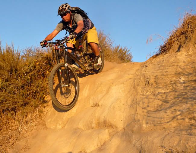

ID:	578102 It seems to me that to keep his cg over the BB(to be in the neutral position and to be able to move forward-rear) he must keep his position far behind the seat. In that position he is no more able to maneuver the bar because his arms are stretched. Maybe his frame is too big for him or that FWD is keeping him in that position
    On my frame I have very good confidence of steeps, I have feeling that I'm over the cg of bike.
    I want to know - what that feeling came from - is that depend of slacker head angle(around 65.5 in my setup), BB height, FWD or something else. Can it be possible to have for example XC ability with 160-180 frame travel - like new Scott Genius or Yeti ASR7, and it have slacker HA?
    You may have raised an interesting question in regards to the topic. I've never put much thoughts to the specific of FWD. To me it's what makes one bike more attractive to another at the same travel, and one that performs better in an all around riding. Good example is the Pivot Mach 5 and Mach 5.7, slight increase in travel but different geo.
    In the pic, your friend looks like he just landed and he push the bike out to absorb landing, that's not an attack position his shoulder is almost over the seat tube If this is his normal descending position, he'd have a hard time getting the front bite in some situation, and it's his style of riding that keep him in that position not FWD, or frame size. He looks 80/20 to me. I think the pic may have taken out of context for the topic at hand. That's the position I'd be in if I'm about to manual over ruts

    Yeah, I agree that looks like "endo avoidance" position, and not a good position for front wheel traction.

    @mimi1885, he's descending all the time like that. There are no rocks, drops or something, I have series of pics of him in that position.

    Quote Originally Posted by codename47
    There's something wrong with the pic then. I hope that's not your idea of an attack position. It's a bit odd to have the weight over the rear like that. He's squatting on the bike, very rearward bias. May be the camera tilt a bit so it look much flatter than it is, but even on a steep descend you don't get into that position. I'm in that position when I'm about to do a vertical roll.

    @mimi1885, great pictures. I think that he's constantly breaking during descent, that;s why he's in that position.
