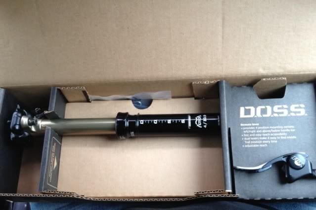

    The box. I bought a 30.9mm and 4" of travel.

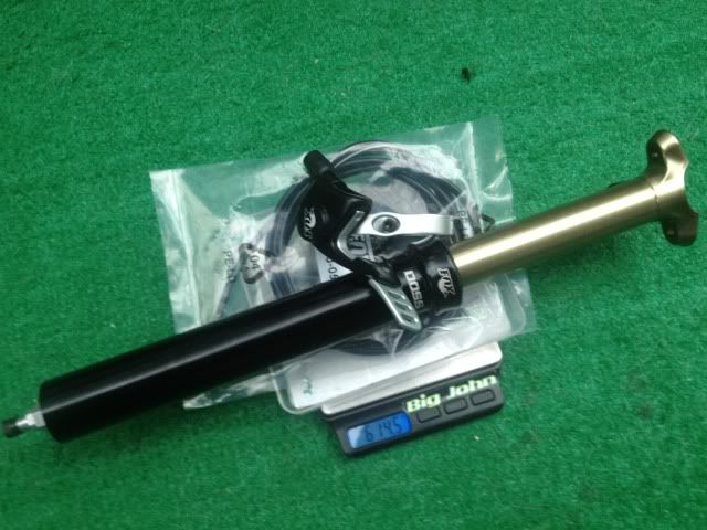

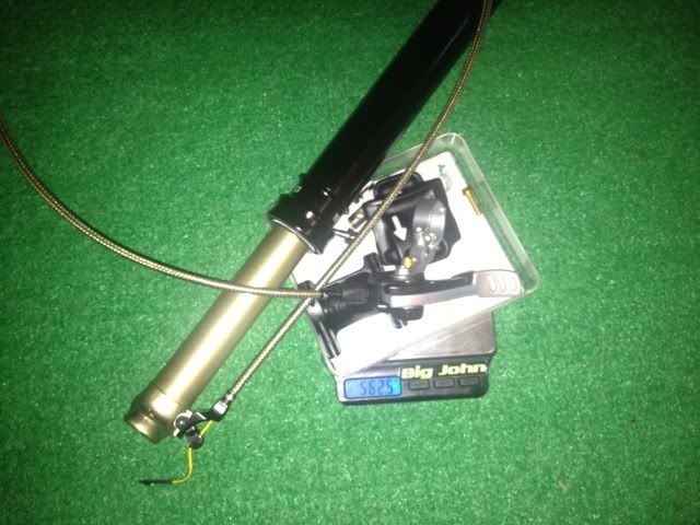

    I'll start with the weight. Mine came in at 614.5g. Box standard.
    My old Reverb is lighter. 528.5g(30.9mm and 380mm) Of course its hydraulic so it should be.
    Being a weight weeine at heart. I started to save some weight on were I could.

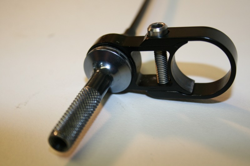

    Changed the seat clamp bolts (They use the same 2pc bolts as Thomson does, just a little longer on the bolt).
    Changed both steel bolts on the handlebar clamp to alloy ones. Used jagwire (more for looks, to match my frame) and I used Power Corz to replace the steel cable. Final weight 562g Not too bad.
    A solid clamping system.

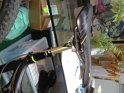

    Fully extended
    Midpoint drop (40mm)

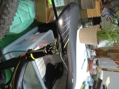

    And all the way down...

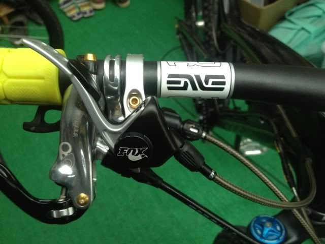

    When I first saw the remote lever. It looked way too big and clumsy for me, coming from the reverb remote. Once I mounted on the handlebar, it start to make sense and the look grew on me. One of the things I loved about it was that you could mount it anywhere on the handlebar. Left,right, up, down and has a 3 position reach. It has two paddles. The inner one (black), when pressed it make the post drop 40mm only. The big silver paddle can also do this but if continued to be press it will drop down all the way. I can't see myself using the inner black paddle much as the outer paddle can function all the positions
    The three reach position

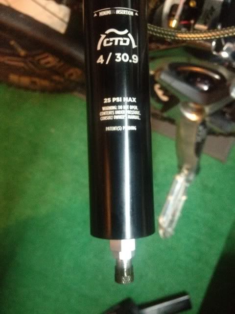

    And finally the speed in which it go's up. Fox says, to slow it down reduce the air press. Max. air presssure is 25psi. I have it around 18psi. As you see the video, I plan to reduces it even more.
