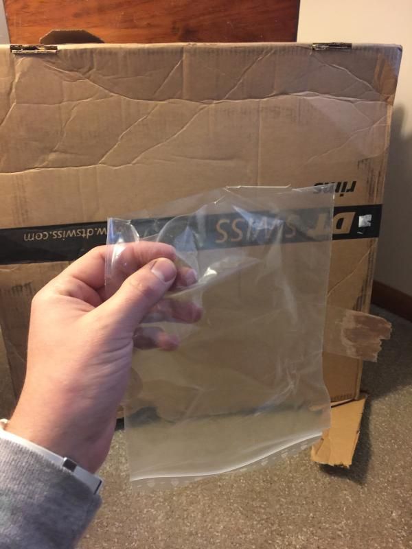

    The boxes did have these empty bags taped to the inside. The manuals and nipples were included in the boxes, but the taped in bag was empty and had been either scissor or knife cut before the boxes were sealed.
    I'm very thankful for the mtbr community here. I may have just gotten Home Depot washers possibly incuring death.

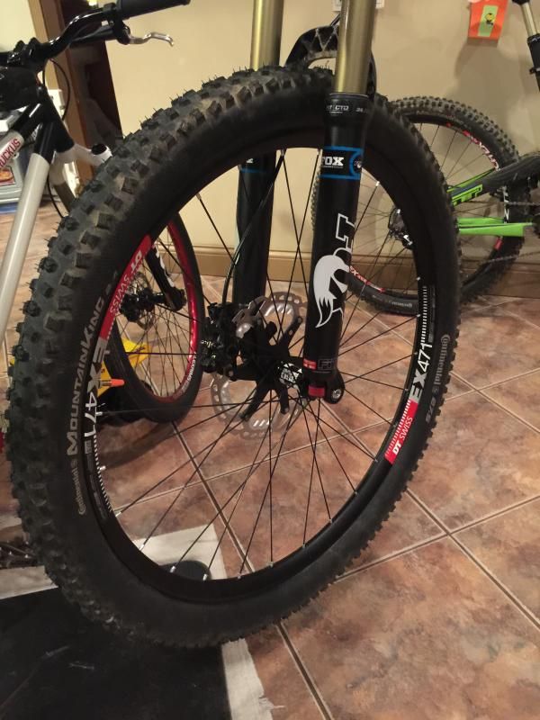

    Mine went together just fine today.

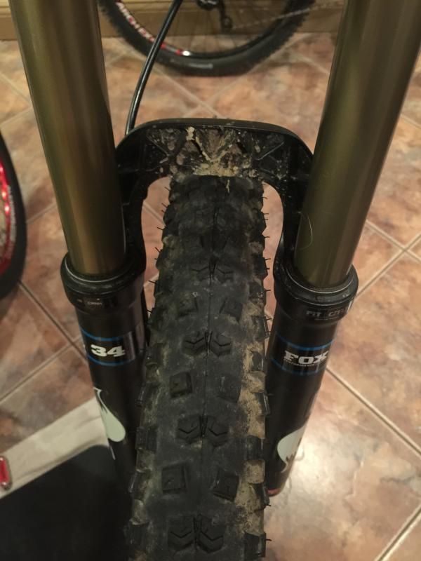

    My one complaint is with Fox fork, shimano post adapter, shimano caliper, shimano saint rotor, and DT 350 hub, I somehow have a rotor outside of the adjustment range of the caliper. I hate the idea of filing the slot on a powder-coated caliper. At least its just a Deore. I was a little peeved that the rear hub decal didn't line up with the possible valve locations. You don't have lacing options with the straight-pulls. Kind of weird I think.
    Mar 2006
    126
    The aluminum nipples and steel washers laced up very nicely. The aluminum has some sort of thread locker or other treatment, a pale pink little booger was created in the torx part of each nipple when the spoke threaded in.
    I chose to oil the washers, just a drop of auto synthetic oil in the little drugs-bag was all it took.
    The tubelessization went more smoothly than any I've done. The tape was just the right width, seems similar to Stan's. I used a pair of some old valves. The tires went on fine. My 8-year-old bottle of Stan's was funny, it had all kinds of info on how much to use for 1.7 or 1.8 tires, and 2.0s, then it just said "use two scoops for downhill tires", so I guess 27.5x2.4s are 2006 downhill. I used 3.5 ounces, who knows. The tires were *just* hard enough to put on that I felt good about it. The compressor just popped the beads, and no fluid even leaked out. I'm used to white bubbles around the valve etc, but nothing.

    My recent build with the DT Swiss EX 471 29 rim is for a 250lb cross country rider. The rim has an excellent finish with a tough anodized surface. It is not described by DT Swiss as hard-anodized, but looks like it is.
    The outside measures 29.6mm wide by 21mm deep with a 25mm internal width. The rim is v-shaped with an approximately 45 degree angle between horizontal providing nearly equal strength laterally and vertically.
    Actual weight: 513g
    Weight of 32 washers: 9g
    Measured ERD with washers: 599.7mm
    Measured width: 29.6mm
    Measured internal width: 25mm
    Measured depth: 21mm
    The bead hook is very minimal similar to NoTubes rimsí. Reducing the hook in this way allows a weight savings while still providing some security to the tire bead. On the inside of the rim is a horizontal bead seat and rounded center channel similar to a Notubes rim. There is no bead-lock on this rim like a UST rim would have. The inside of the rim is nearly identical to a Notubes Flow EX rim except with a slightly higher sidewall. The sidewall height from the bead seat to the top is 5.25mm versus 3.75mm for a Flow EX. This taller sidewall will slightly reduce the width of a given tire when compared to the Flow EX, but also provide more security for the tire bead in holding the tire on under higher inflation pressures or hard impacts.
    I built the 32h rims to White Industries M16 disc hubs. I used Sapim Strong Spokes and the nipple washers included with the rims. Instead of using the included Squorx nipples I used Sapim Polyax Black Alloy nipples. The rims build very easily and produce a very true wheel. The max tension of the drive side rear wheel spokes and disc side front is 125kgf.
    I measured the bead diameter of the rim to be about 622.5mm when bare. After built up and tensioned to 125kgf I measured the bead diameter to be about 621.8. So the diameter shrunk about 0.7mm when built.
    I installed one layer of DT Swiss Tubeless-ready tape and Stanís Notubes 44mm valves. I installed two tires on these rims for test:
    1. Brand new Tubeless Ready Continental X-King Protection 29 x 2.4. The tire mounted by hand relatively easily. I attempted to inflate in with my Topeak Joe Blow Turbo pump, but was unsuccessful. I did not try soapy water. I then used a compressor and the tire easily inflated and snapped forcefully onto the bead seats. The tire casing measures only 56.35mm (2.2in) in width at 30 psi, so Continental is not too accurate in this respect.
    2. Brand new Tubeless Ready Continental Mountain King 29 x 2.4. The tire mounted easily by hand. It was looser than the X-King on the same rim so it took a few attempts to inflate with a compressor. The tire snapped into the bead firmly. I did not use soapy water. The tire casing measured 57.4mm (2.3in) when inflated to 30 psi. A little smaller than advertised.
    I you are using continental Tubeless Ready tires I recommend using two layers or more of tubeless tape to increase the diameter of the inside of the rim and. This makes the tire a little tighter and easier to inflate.
    In my experience UST tires and some other tubeless ready tires such as WTB TCS, GEAX TNT, and Hutchinson Tubeless ready have much smaller beads and will only require one layer of tape.
    The spoke tension dropped about 25kgf when either of these tires was seated onto the rim. This is due to the compression of the rim from the Kevlar tire bead. As the tire bead stretches over time the compression of the tire bead will become less and the tension will increase a little with the tire mounted.
    Original Tension Drive side: 125kgf
    Tension after tire is seated: 100kgf
    Weight with two layers of DT Swiss tubeless tape and Stanís 44mm valves:
    Front: 965g
    Rear: 1090g
    Iíve seen this rim on several downhill bikes and it is valued for its strength and relatively light weight when compared to traditional downhill rims. This rim is a great choice for larger rides or anyone looking for a tough rim for all-mountain or enduro use.
